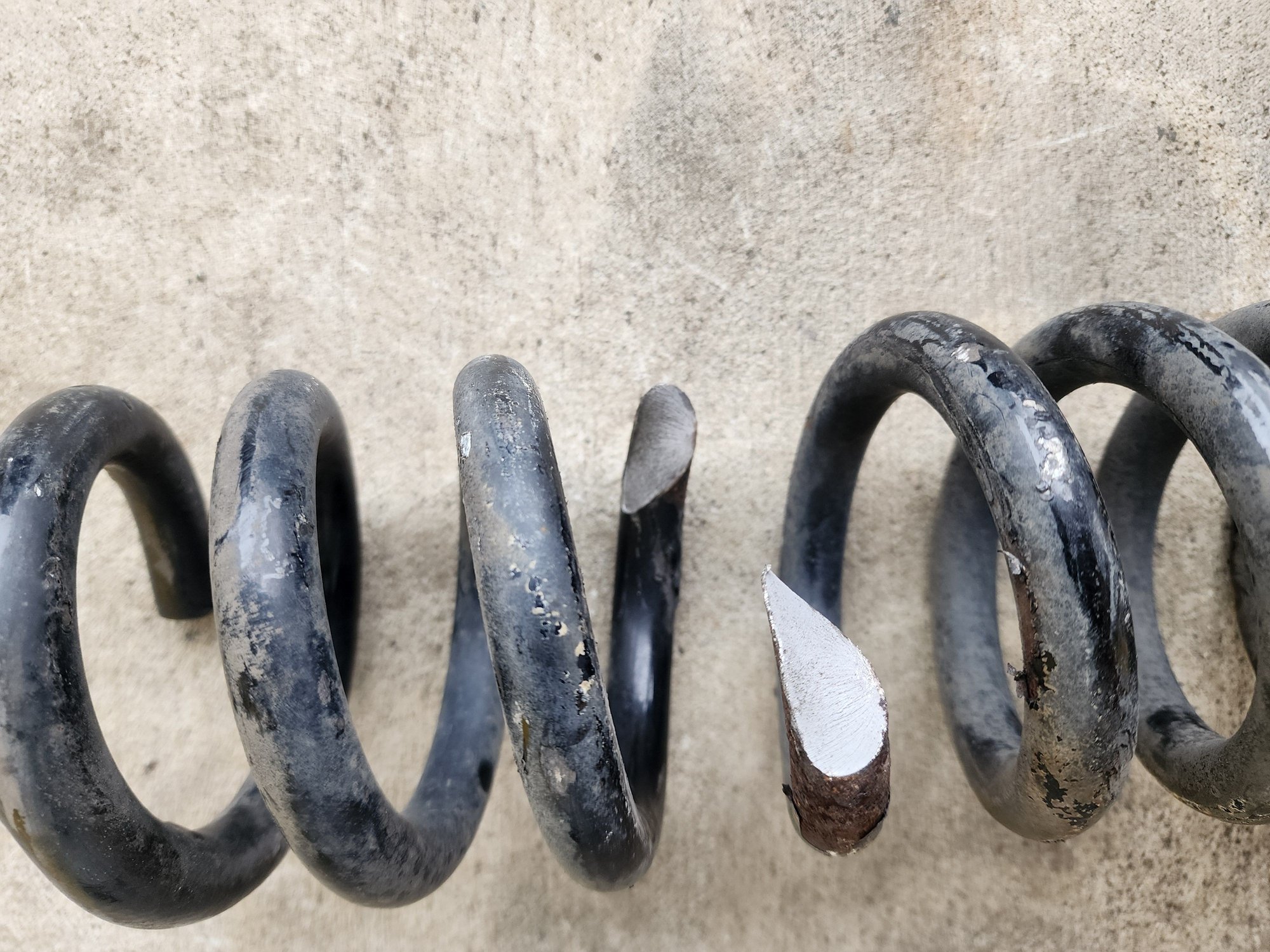

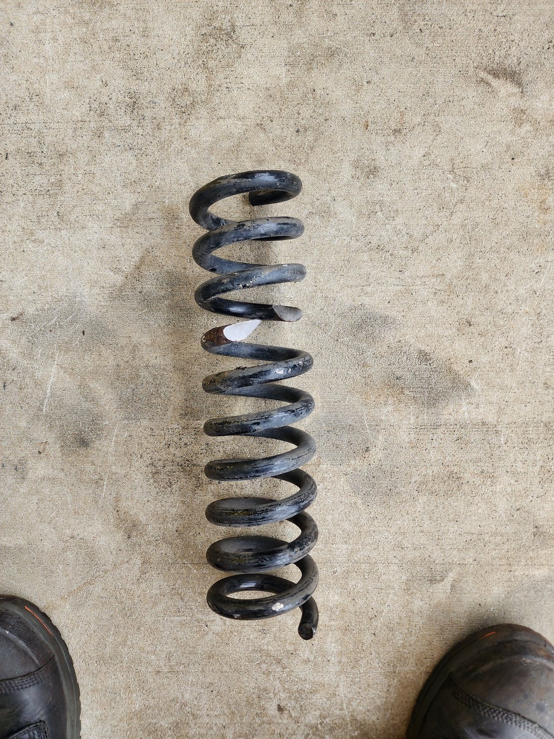

This happened one week ago . I was driving home when I heard loud bang looked back and I notice coil spring flying out from rear left side . I live in BC Canada we don't get much snow and roads are not that bad but for this to happen to 2015 GLk with 132000km I think is joke . I talked to Mercedes representative and I was told your car has no warranty so nothing we can do for you.

That spring has very minor corrosion on it. I'm quite sure that did not contribute to it breaking. I have heard of a lot more springs breaking on the GLKs that any other car I'm aware of. To me this is an issue.

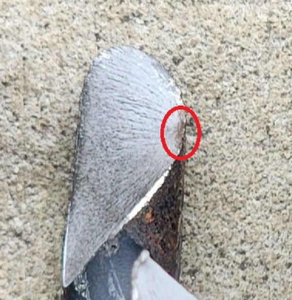

In the red circle is the corrosion induced stress point that started the fracture. You can see the stress lines emanating from there.
Spray your springs with Fluid Film or LPS-3 or ACF-50 every fall.

Good catch, Johncc.... while the spring didn't look "too rusty", once the rust gets penetration it forms a stress riser, which concentrates the stress at that point, leading to an early failure (I think I see some on the bottom portion of the break as well).
A good analogy - take a piece of undamaged paper, and pull on the corners. You can pull amazingly hard without effect. Now put a tiny little tear in the middle of the edge between those corners and try again. You've only affected a tiny percentage of the paper with the tear, but it's going to be much easier to tear the paper now...

Good catch John CC, that's exactly what I noticed. Doesn't take much after that to break a highly stressed piece of spring steel that has a slight defect causing an unusual twist when it's flexed (even though it's a small difference).
I've never personally broken a spring either, but have seen similar fractures on others where small rust spots have penetrated the coil. I think spraying them as previously mentioned is a smart idea, and is also why they are painted in the first place.

Just realized (slaps forehead) that you can clearly see stress lines emanating out from the rust spots where the coil broke.
You’re the aircraft A&P guy, right? Small things lead to big problems. I should have caught that and I didn’t. I’ve been under our cars and trucks with LPS-3 or Stop Rust! since the 70s. Good to have you around!

If you look at the area on the coil just below the break, there appears to be an impact mark. I suspect that the corrosion,even though it appears minor, coupled with impact from a pothole or similar bump is what caused the break.

Mine was a 2014. Both broke within a few months of each other. The first one broke about one coil from the bottom and was missed in a cursory inspection, looking for an odd squeaking noise. Mileage was about 85K s well, but I don't think that had as much to do with it as exposure to salt. When the second one broke (picture in post #8) it was pretty clear what had happened.
