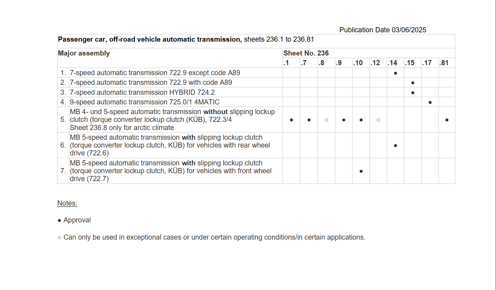

1) LOL, do not let who ever did that quote touch your vehicle.
2) Do not use Shell branded fluid UNLESS It is the proper SPEC: 236.14
But call Mercedes and CONFIRM the SPEC
APPROVED OILS:
https://operatingfluids.mercedes-benz.com/sheet/236.14
If you cant do it yourself, Mercedes or a proper EURO shop will do it but It will be about 500-800$

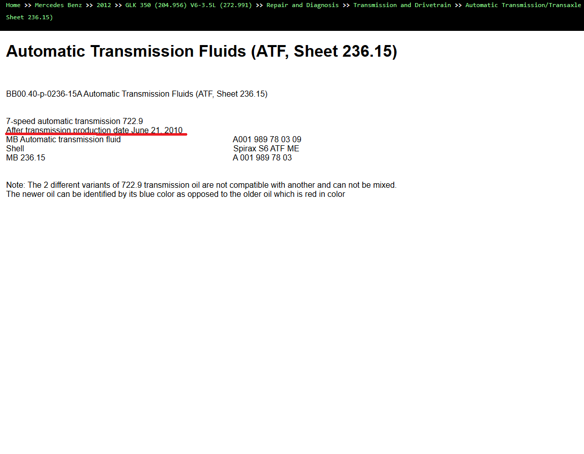

Im guessing a 2012 has the A89 Option code for the trans. If so you would want to use 236.15 spec.
Confirm this on your build sheet.

Yes good call confirm the SPEC first with Mercedes.
Then goto:
And make sure you ONLY use the CORRECT fluid!
Reply 0
Mar 30, 2025 | 05:10 PM
Does the vehicle have the 7G to 7G+ transition with the blue and red fluid?

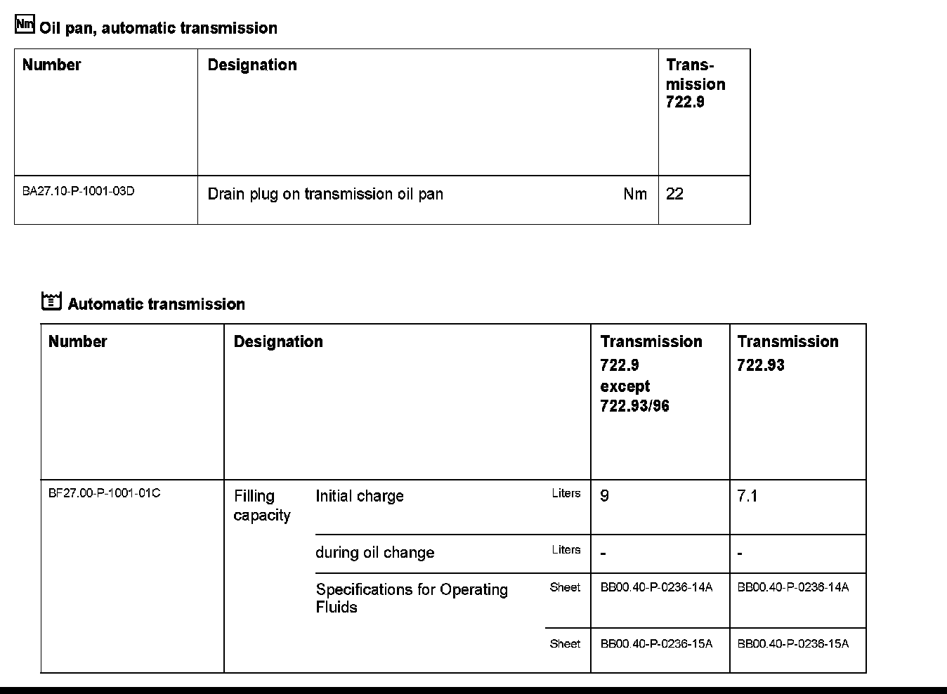

I'm assuming OP means 9-10 liters. 50$ for a filter, 30$ for a one liter bottle of mercedes transmission fluid. 10-15$ for a one liter bottle of aftermarket equivilent.
Reply 0
Mar 30, 2025 | 08:36 PM
$195 for the kit including Fuchs fluid (10L), filter, pan bolts, gasket, drain plug. and $5 for the converter drain plug at FcpEuro.

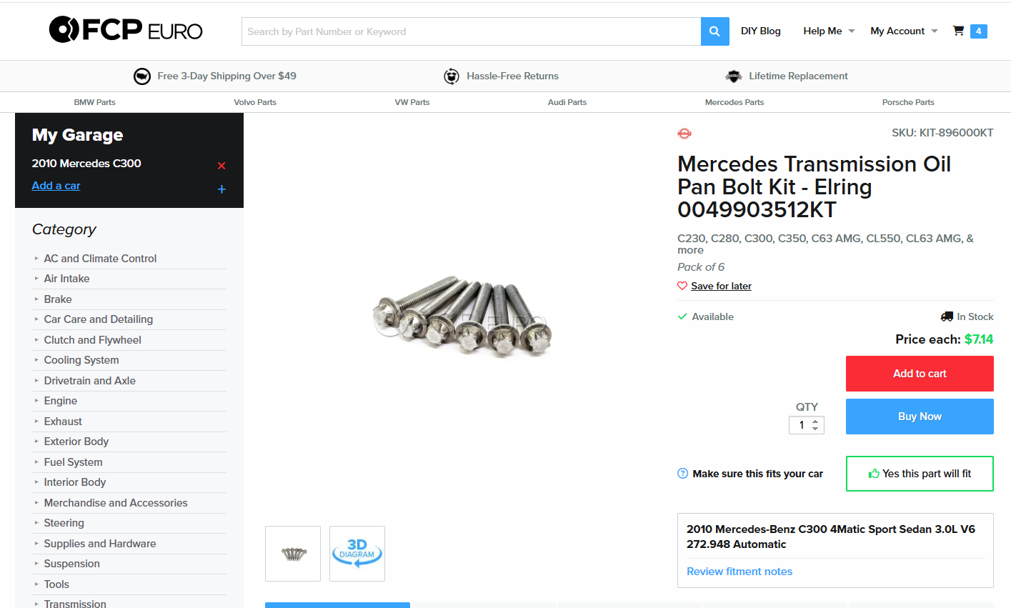

You're going to need another jug of fluid, and new (aluminum) bolts for the pan. They're single use only. Also, a torque converter drain plug.

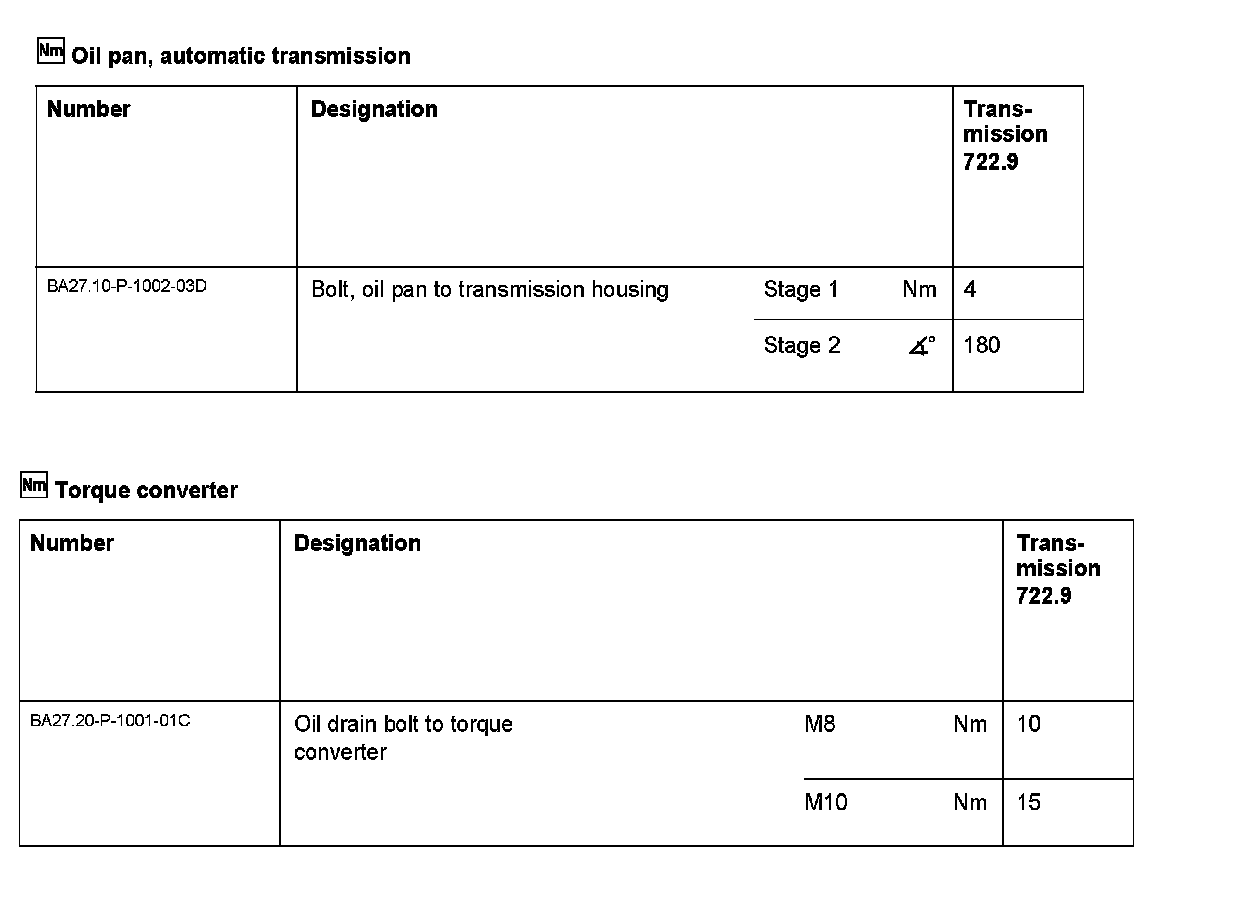

New transmission pan bolts would be a good idea. Also want a new drain plug washer, its a 12mmx17mmx1.5mm.
Im not sure if 5 quarts will be enough. I didnt drain my torque converter and ended up using 6 quarts of new fluid, drained out a little when setting the proper level.
Be sure to follow the torque specs for everything. Ive read stories of people snapping the transmission pan bolts, they arent torqued that tight.

I spent around 225 for the labor and it took about 3 hours. In addtion to getting a 5qt. jug of Pentosin ATF 134 FE, transmission oil pan gasket (23 bucks for OEM), Transmission filter OES, a new Overflow plug (the green one that goes inside the the pan), ATF fill adapter from Amazon M12 x 1.5, (that is about 130). I got the pan bolts (the mechanic said that these are suppose to be one time use so, glad I got them, thanks TimC300!), and a new oil plug, and got another qt. of Pentosin ATF 134 FE. Had to pay for another 1 quart at the shop because 6 was not enough. Ended up using 6.5 quarts in total. So let's see 225 for the labor and around 150 or 160 for all the parts. So still spend less than the kit at FCP Euro. Do I feel a different in the car, slightly.. but enough to give me a better piece of mind. THANK YOU ALL!
