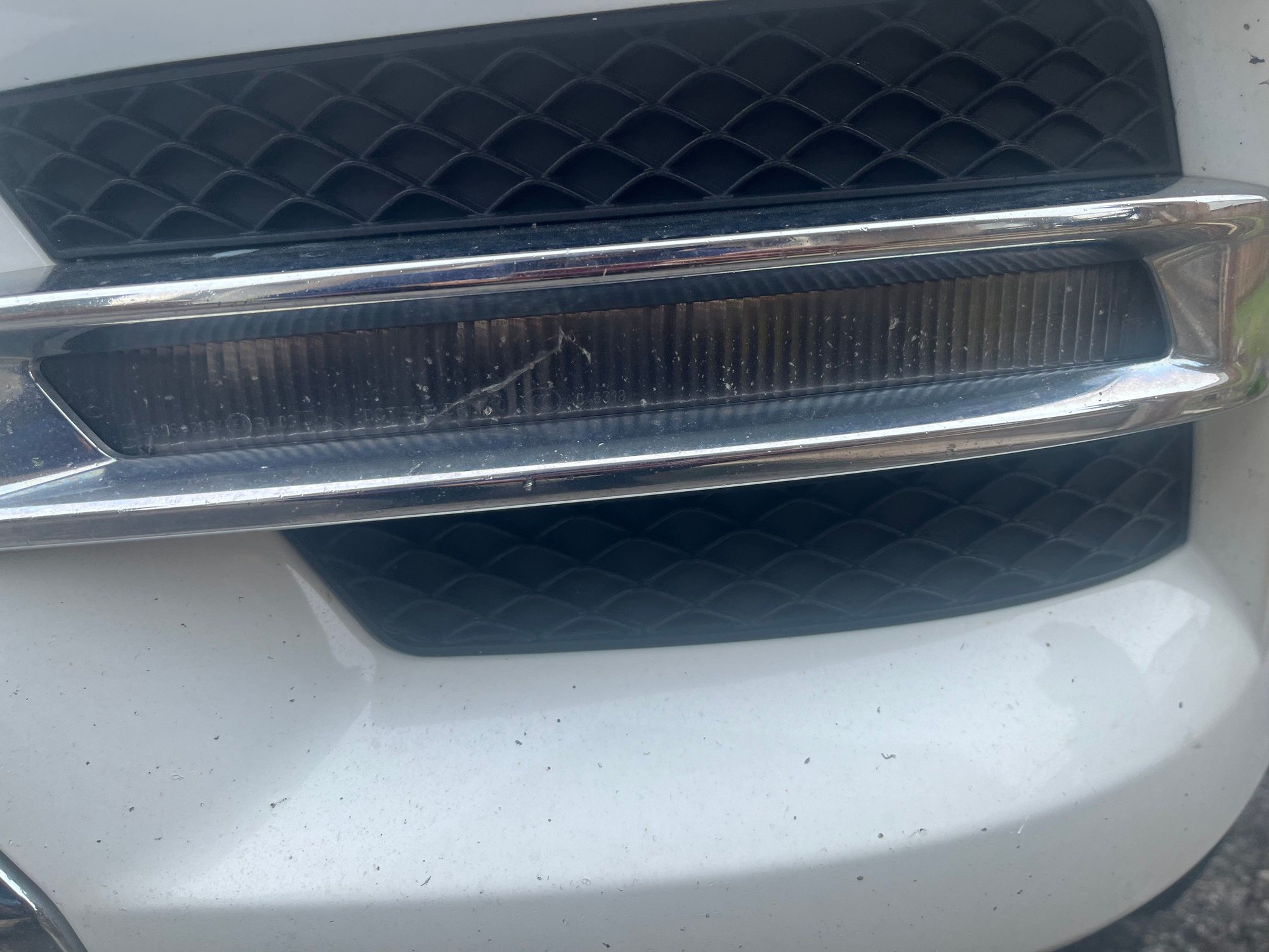

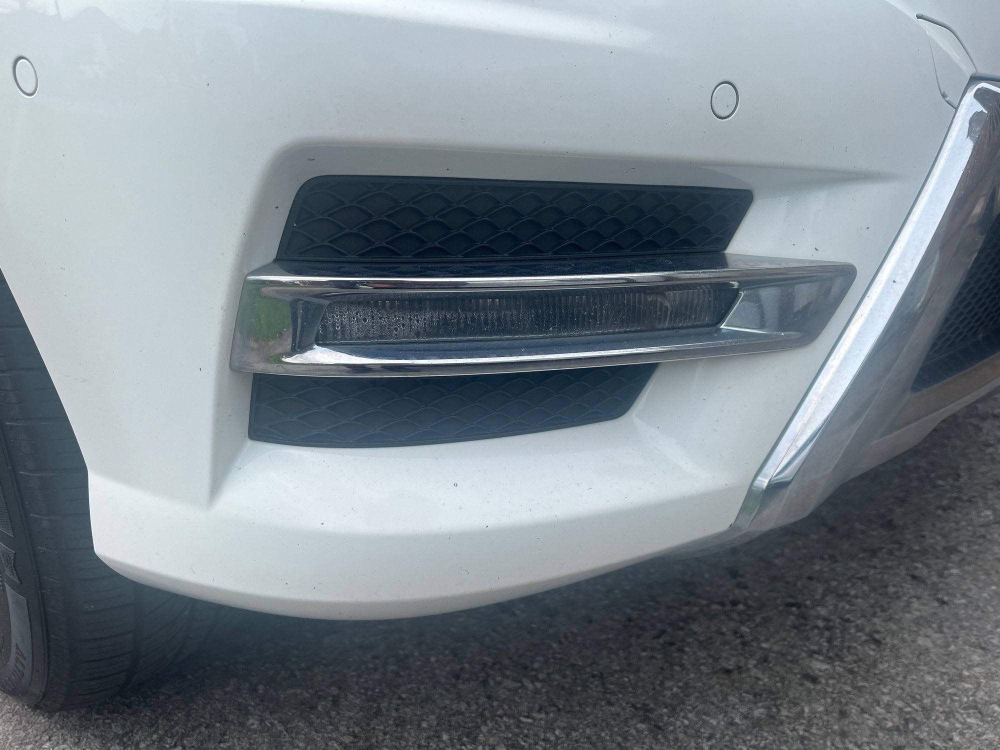

Both of my front lower bumper grill DRL are broken and needing replacement. Does anybody have a how to or a replacement aftermarket or OEM option?

Can see moisture inside one of them, looks like a crack in the others lens. Not sure if they are servicable like taking off the lense and trying to dry them out and see whats wrong. Try taking them apart. Looking around on ebay i came across just the light part for less money than replacing the entire assembly. Maybe this will work?

The issue is not that the LEDs are burned out. Both lenses are quite obviously cracked. One has also fogged up.

thank you. My lights currently illuminate and have 4 LEDs on each housing and my passenger side has one LED out and with them both cracked. I’ll replace both. Just happy to have a replacement guide along with the parts

Thank you everybody for the replies. My lights have power and do work. One led in the strip on the passenger has burnt out and with both sides lenses cracked they need replacing.
Probably poor initial post by myself. DRL are mandatory here and we cannot disable them. I guess j could unplug them until I find a replacement but then I’d have another warning and I cannot stand those. So I will continue to hunt the part down.
