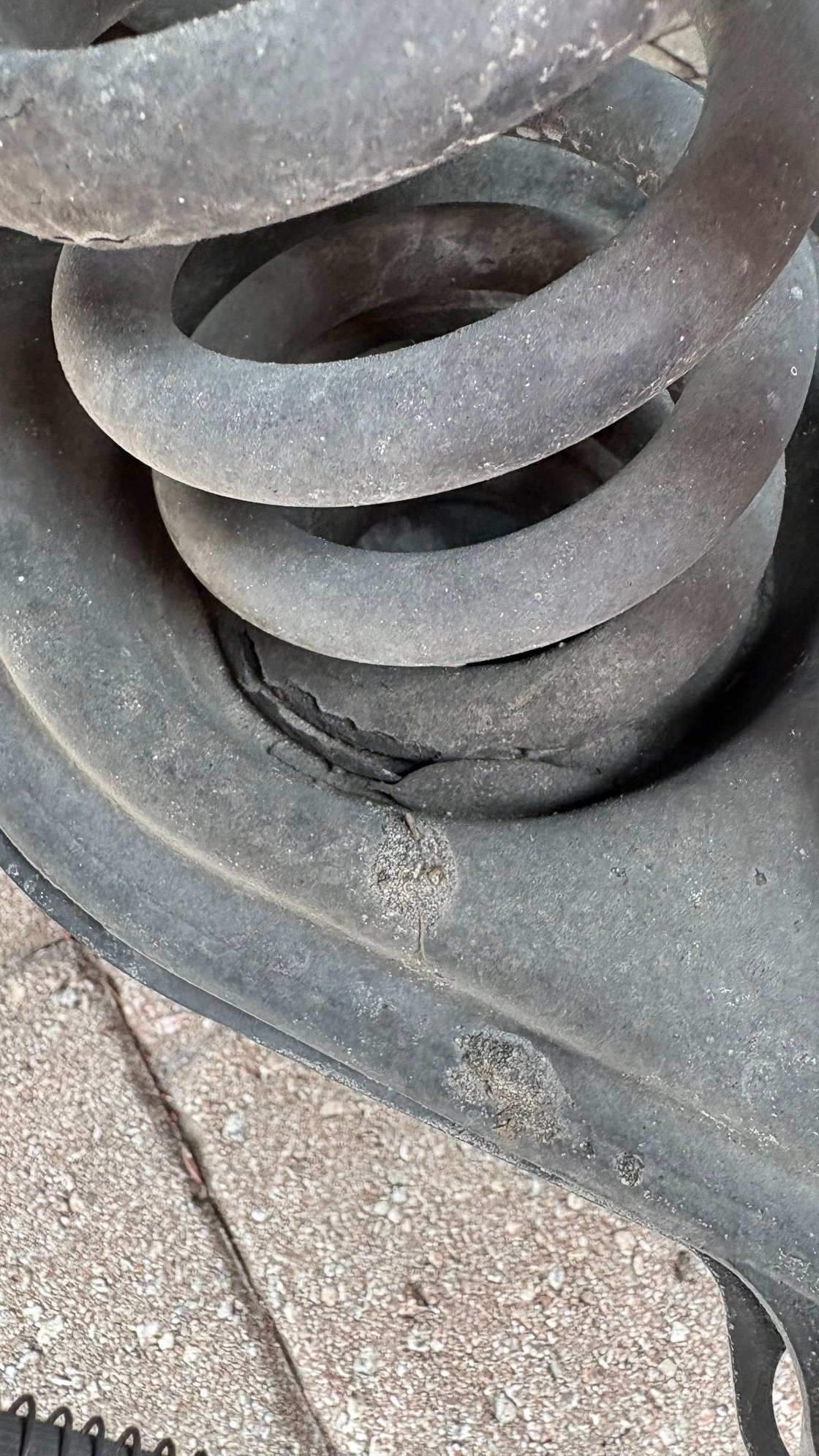

Old Jun 10, 2025 | 04:52 PM
chorney's Avatar
Joined: Mar 2024
Posts: 21
From: South Florida
2010 GLK350 RWD
Originally Posted by John CC
Look at the bottom coil or two of the springs. They're notorious for breaking.
this is my spring
Old Jan 3, 2026 | 07:35 PM
TinsGLK's Avatar
Joined: Jan 2026
GLK 350 2014
Originally Posted by chorney
I just picked this up for a steal of a deal (or so i thought) I am not even all the way home yet when the rear suspension starts making a very loud and noticable squeaky noise from the rear suspension. Right now I am sick and cannot dig into the issue I an very busy this week, if anyone has experienced this or knows what it could be please let me know.
https://youtube.com/shorts/TkEklPg2Y...iu7UNY-wtpBTKu
https://youtube.com/shorts/cGli8tIGG...g8wk1x4JpJ9dM1
So the issue was the spring? Did you figure it out? Is it fixed? I have exactly the same problem and I am glad I have your video, as i was never able to capture the sound. Every time I drive to my mechanic it disappears. Thx!!

I bought 2 rear new springs , it raised up the rear 3-4 “ , so I bought Used EBay mb Glk springs , it’s better . New rear springs messed up the front suspension and made it look like a joke. What a headache. The eBay dealer I used was very good , I can find the seller if needed . (I answered this 10 minutes ago I guess I didnt hit Send) 🤪
