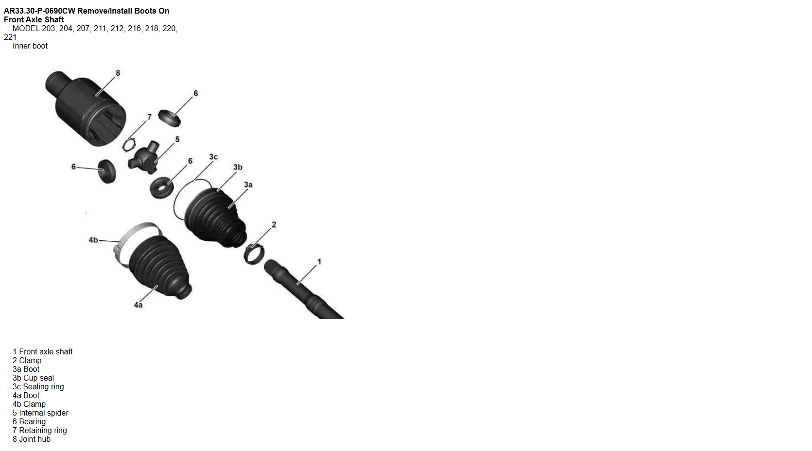

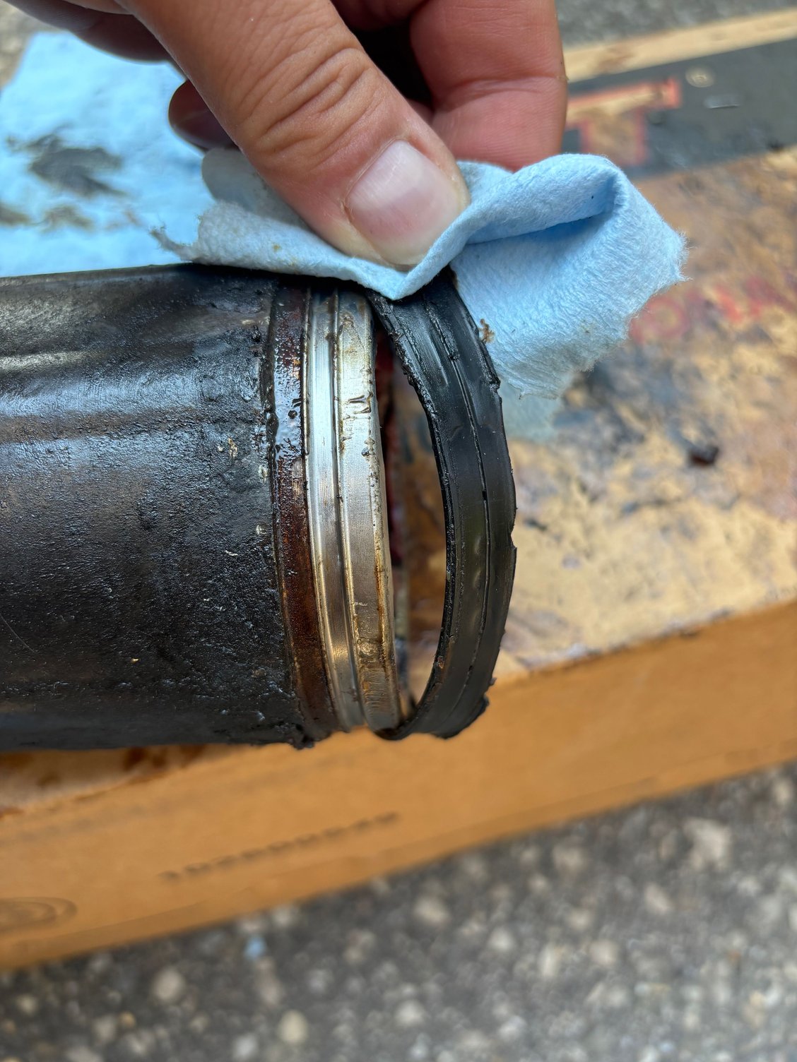

I had a rip in my inner right CV boot along the larger clamp. Replaced the boot which i got in a kit from Rockauto for like $50 CAD with shipping. There are couple good online DIY tutorials, @habbyguy posted a good video on the CV axle removal and @Josh.A.Hussey did a good write up regarding the inner boot replacement, which I followed, links below.
Just a few things to add, I had a tough time removing the axle bolt initially because I used a cheap E24 socket from Amazon, the bolt stretched the inside of the socket, should have just gotten an impact socket to begin with.

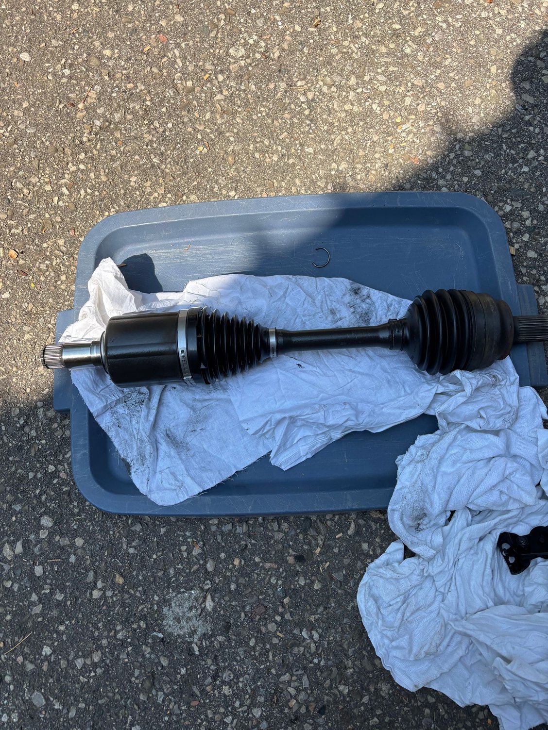

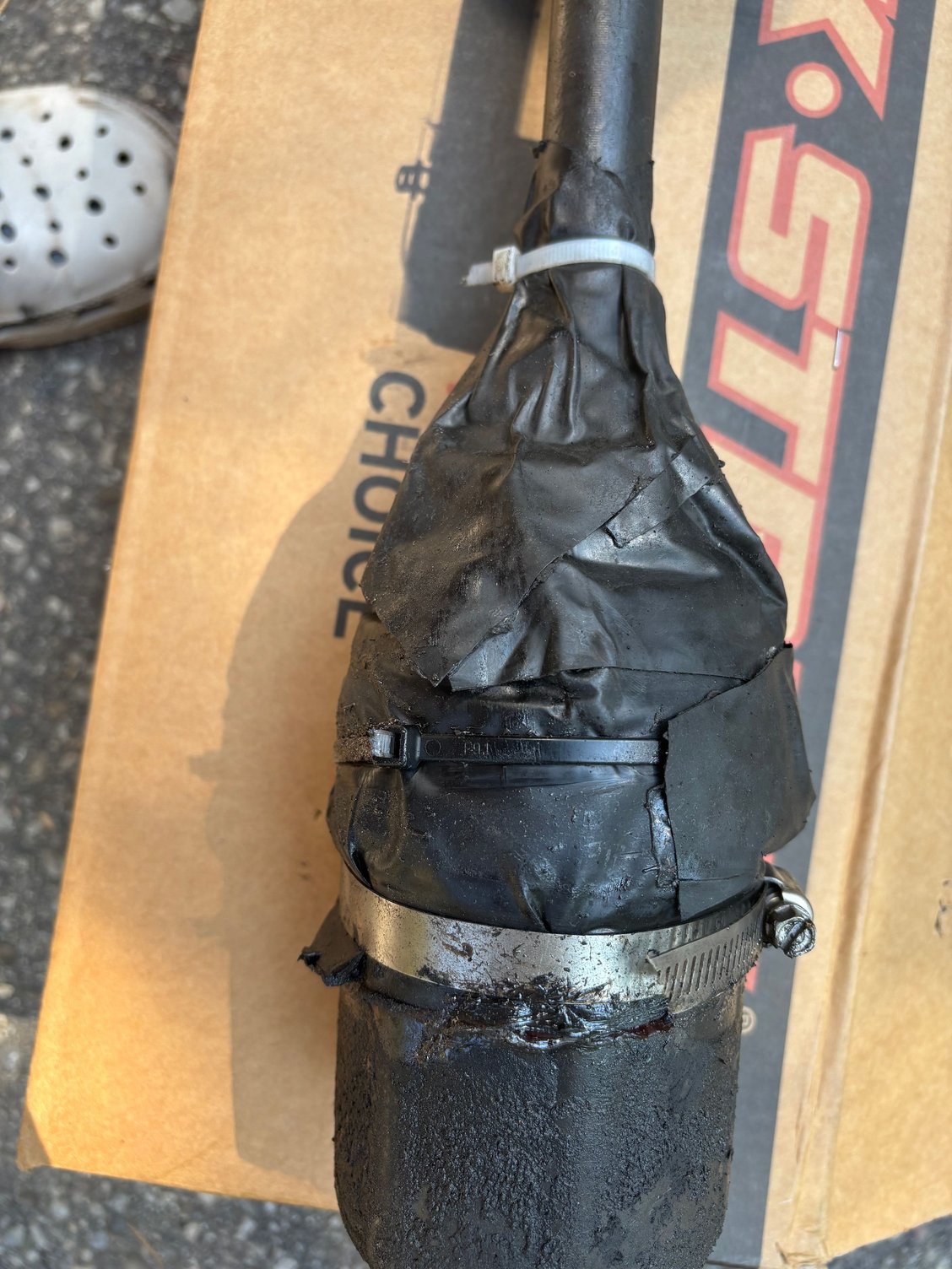

The removal of the axle wasn't too bad. The old patch job worked for a couple of weeks, metal clamp was actual the weak point, that is were the grease started to leak again, the clamp kept getting loose. The rip was along the large diameter clamp, as you can see in the second pic, once i pulled on the boot it separated easily along that joint.
Once I got inside the joint the only tricky part was trying to remove the tripod head, it required a 3 jaw puller to remove, I taped up the 3 tripod ends with electrical tape to protect the surface and give the jaws a better surface to grip onto.
After getting the old boot off and new boot on, a 23mm 12 point socket was perfect for hammering the tripod back onto the shaft.

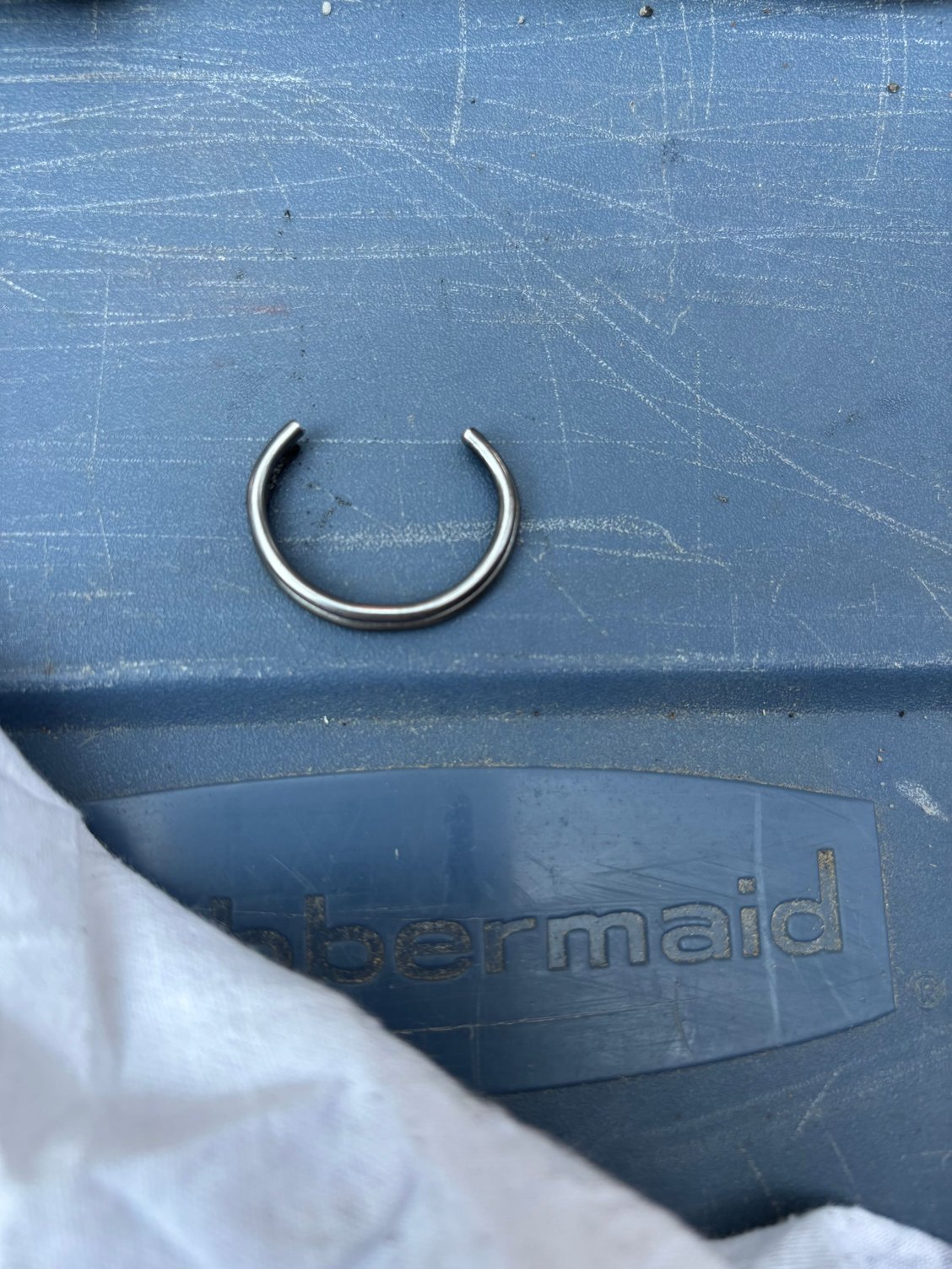

I replaced the snap ring that retains the tripod on the shaft with a new one, as well as the c clip that hold the axle in the front diff, but probably could have reused them, they were only a few bucks each at the dealership. old and new c clips were pretty much same in shape.

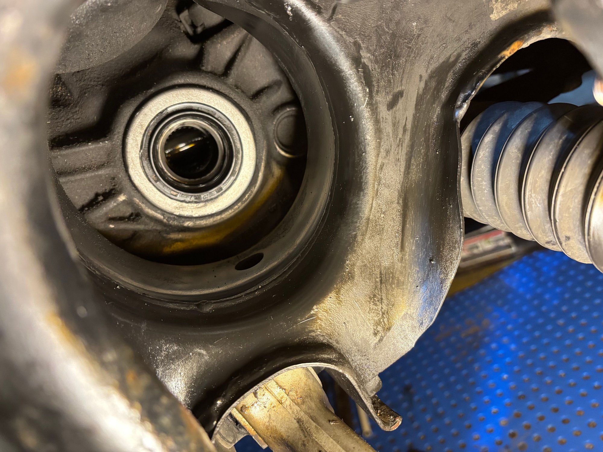

Cleaned up around the axle seal, I might replace the seal when I end up doing the engine mounts in the future.
New boot
The hardest part was trying to convince the wife to help me put the axle back on, you can get a good chock grip (chock holding it by the tripod joint housing) and when laying under the car pulling the housing into the diff, while someone holds the hub end and pushes it towards the diff while clearing the suspension parts.

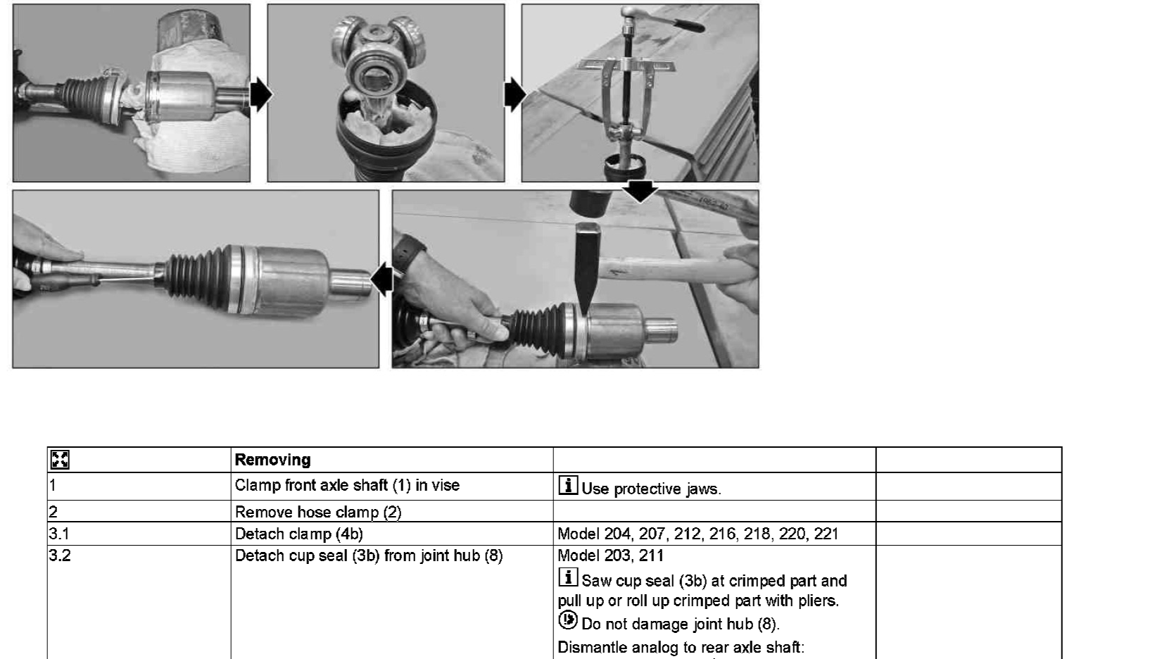

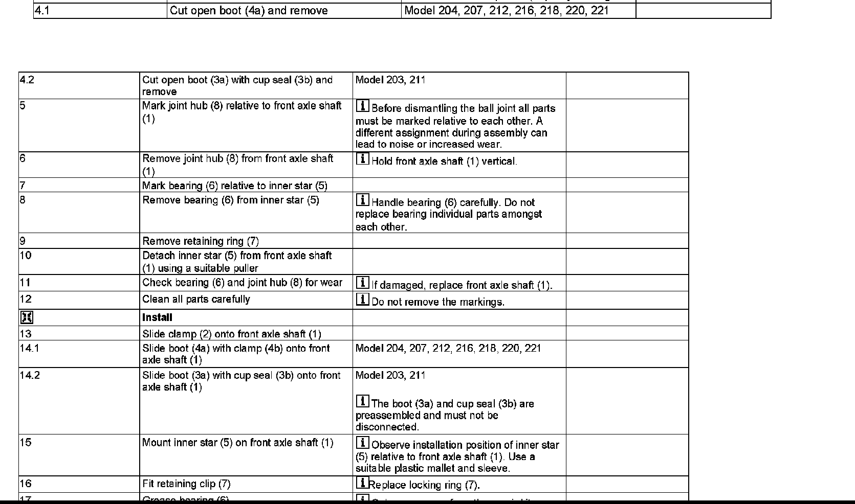

Good thing I came across this thread. Im preparing to replace a torn inner boot and hadnt thought about having to remove that inner star part. Now I have to buy a puller. I have a pin hole in the passenger side outter boot and already have all the parts to replace it and that shaft seems to completely slide out from the bearing cage, no star and bearings to deal with to replace the boot. Which specific puller did you use or what would work best for it? The manual seems to show only a 2 jaw puller unless im not seeing the 3rd arm.
My torn boot is on the drivers side so I plan on pulling the axle apart while the inner hub is still attached to the intermediate shaft. I've seen numerous threads of people having issues pulling the axle off the intermediate shaft and i dont want to mess with removing the intermediate shaft.
Did you mark all the parts before pulling everything apart in order to install them back exactly where they were? Im wondering how to mark a greasy axle shaft, paint marker?
When you put the 3 bearings back on the star do they stay on by themselves? I ask because i'll be holding the axle horizontal when putting it back into the inner hub and wondering if if the bearings sliding off will be an issue, trying to hold the bearings on while holding the axle while under the car.

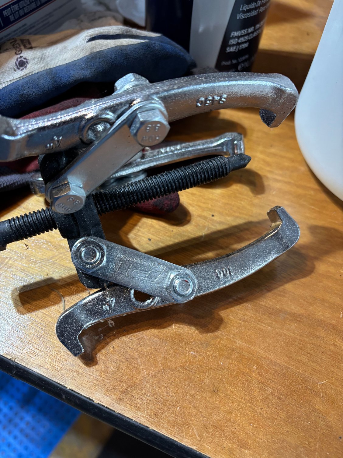

I used this kind of 3 arm puller, came out without issues.
I didn’t mark which bearing went on which part of the tripod, even with grease the bearings slid off easily. I’m guessing if you insert it with 2 bearings at about 10 and 2 o’clock, then you just have support the 3rd bearing pointing to 6 o’clock untill it’s inside the housing.

I bought a 3" puller and it worked well for removing that bearing holder, thanks for the info.
Prior to removing everything I marked the orientation of everything. Marked the "top" of everything with either permanent marker like the rotor, cv axle shaft and then the parts inside the boots I etched some lines with a drill bit just so I can put things back the same way.

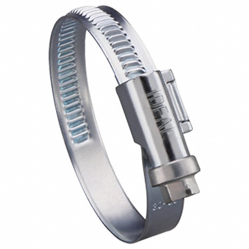

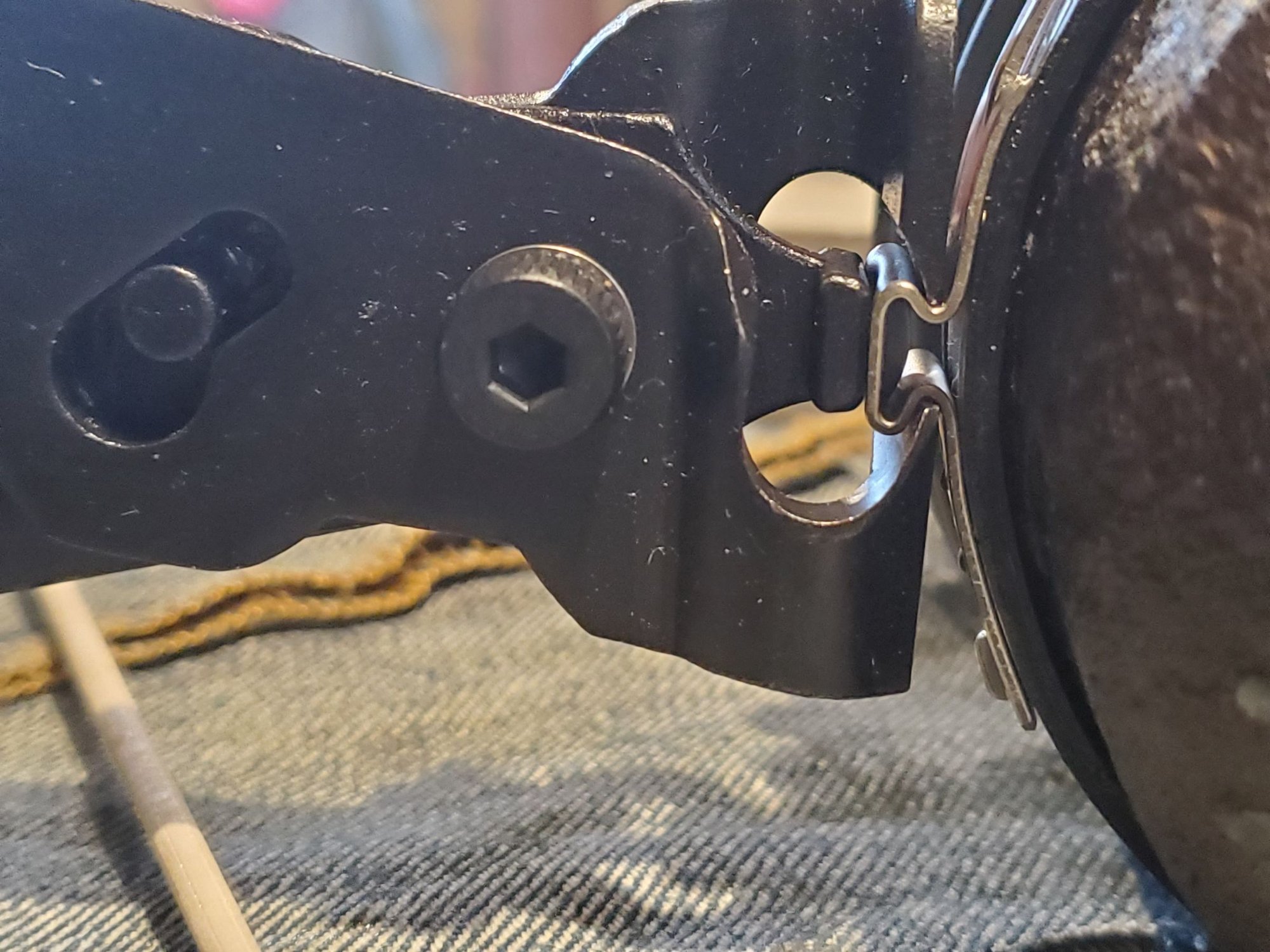

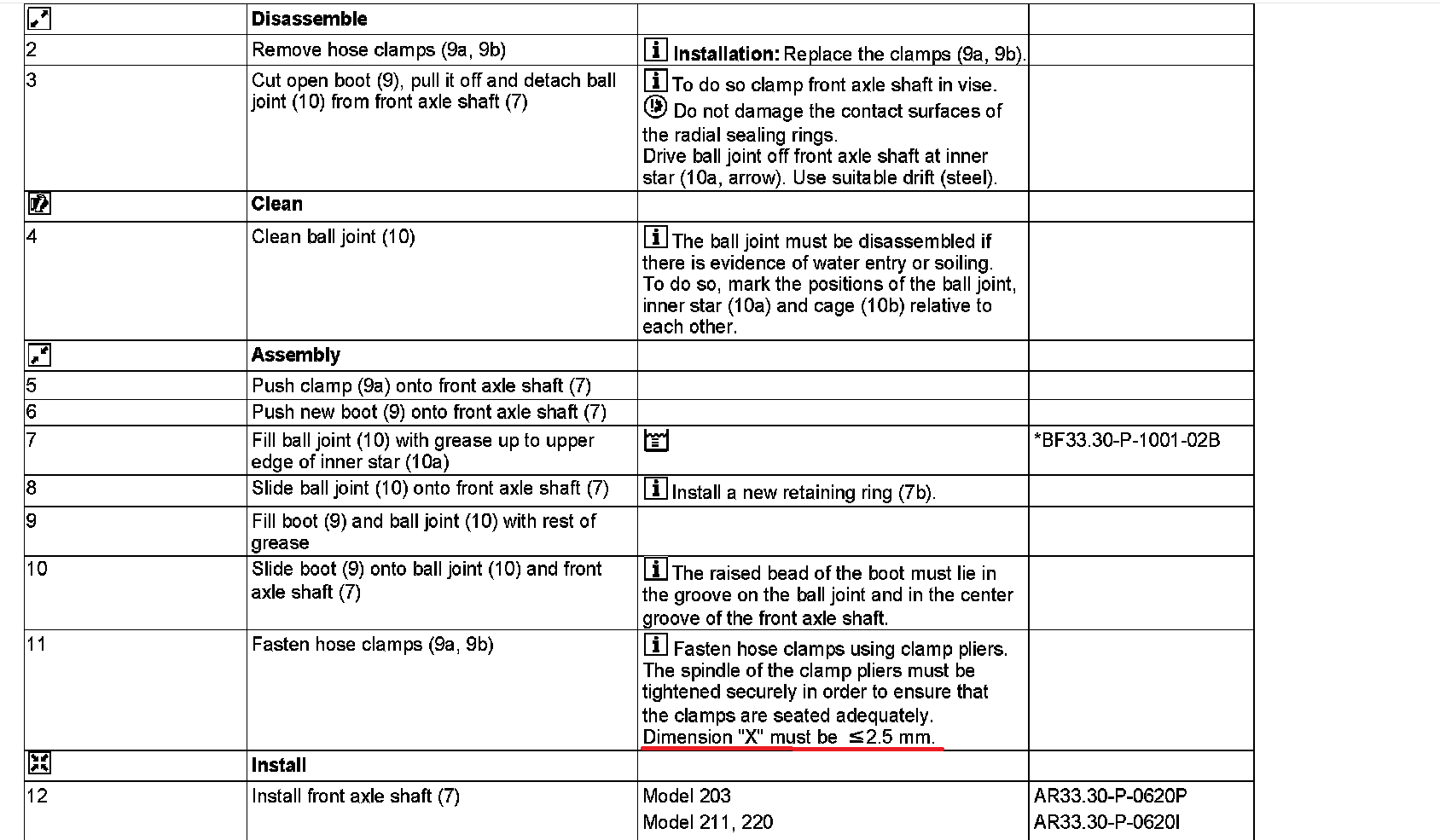

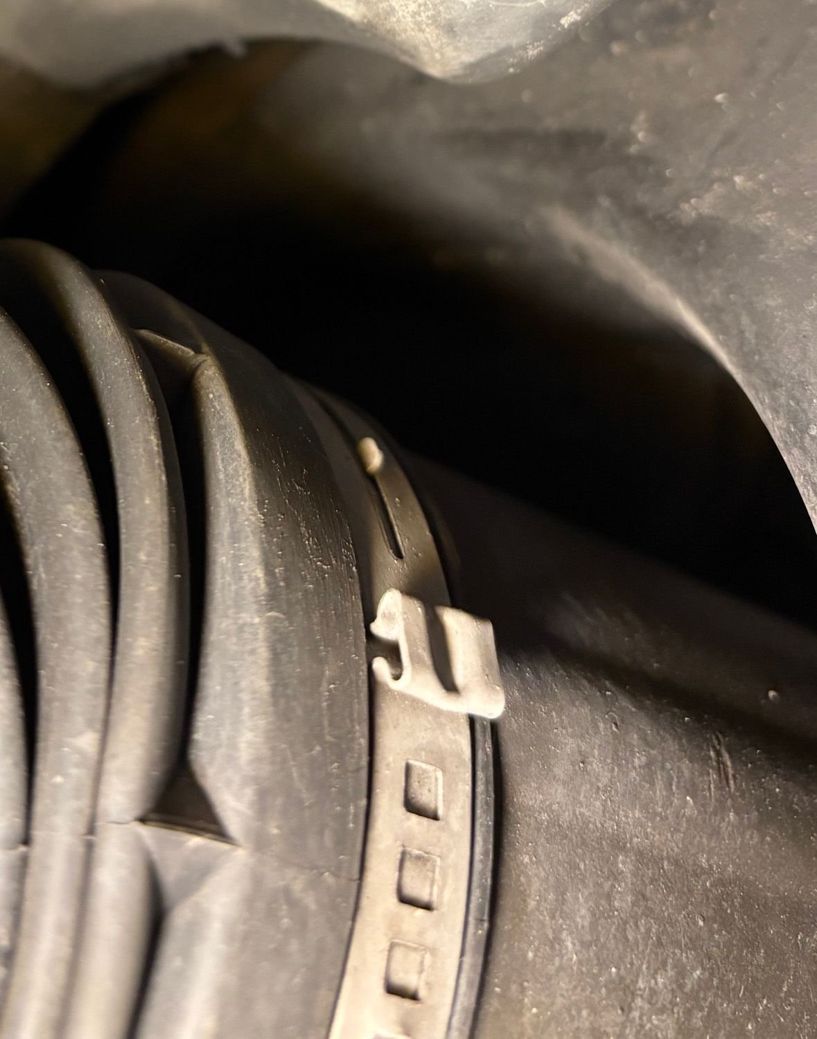

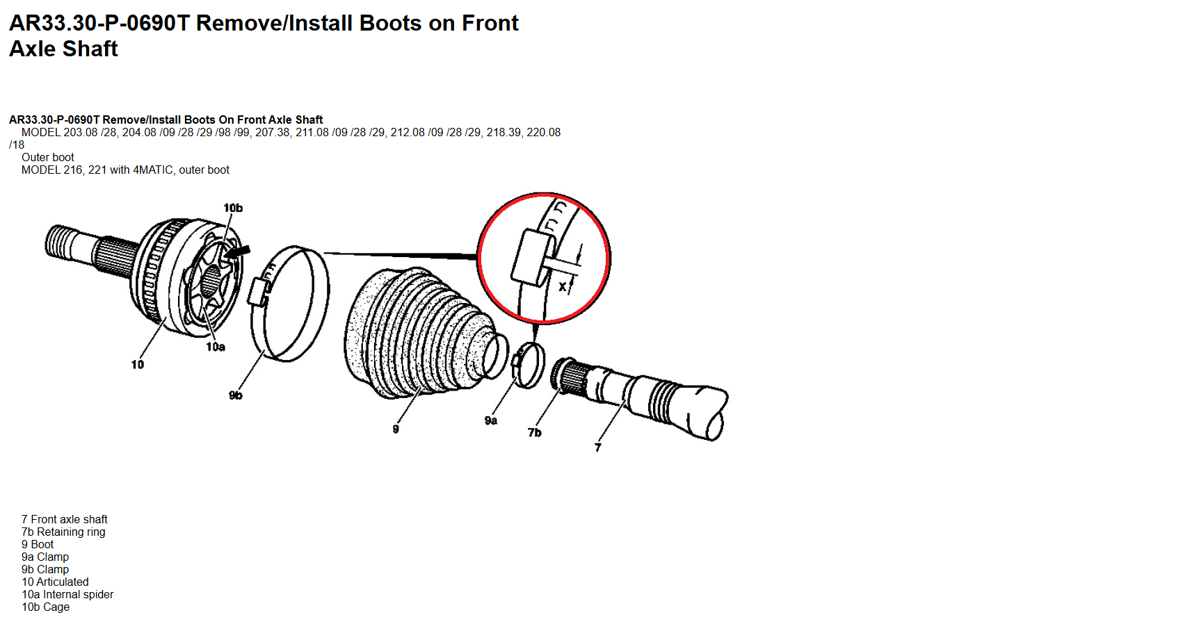

I never used Oetiker clamps until now and thought it would be easier to clamp them. The MB manual says the gap has to be closed to at least 2.5mm. Even with the Lisle clamping tool with a 1/2" drive torque wrench and breaker bar I could only get the gaps around 3.5-4mm. And that was working on a bench so doing it while under the car there is no possible way.
Researching the clamps it appears they are Oeitiker 167 Heavy Duty clamps and it shows the clamping force needed is at least 5000N. At the factory im sure they have pneumatic machines for clamping.
I cannot praise and recommend the small tool I bought off Amazon enough, its small and fits anywhere. I used a small 10mm open end wrench on the bolt and had no trouble closing the gap on the clamps. It totally solved my problem of installing the inner most clamp that is right at the subframe.
Earlier today I went back under the car and tightened the clamps a little more because im paranoid of the boots coming off.

I tightened them as hard as I could, used this tool but axle was off the car
