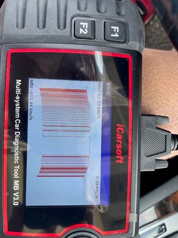

-all wheel speed sensors oscilloscope readings are registering.
-rpm ranges on all sensors do range from -600 to current wheel speed (at the moment of active monitoring)??

-I have NOT checked resistance (unplugged) at each of the speed sensors yet; as is surely seems like all are working and registering accurate square wave signalling on diag..

all speed sensors reqister good wave patterns and speed tracking upto km/h. all the same speed..
after driving, pause in square wave is due to stop light. (front left)
after driving, pause in square wave is due to stop light. (front right)

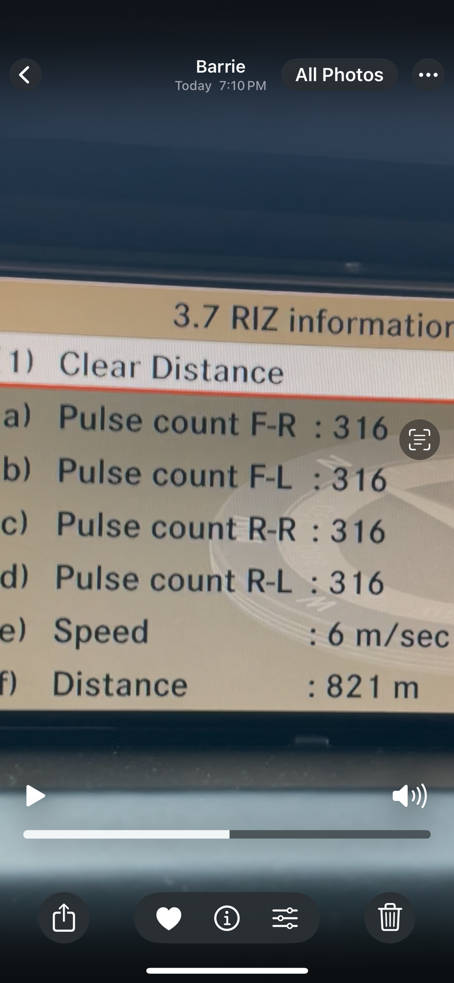

Do all speed sensors need to be absolutely in-sync? (Video screenshot attached)
Do all speed sensors need to be synchronized?
I have left side in since with one another and right insync with one another. But to be clear should all 4 be clocking and stepping together in a “absolute mathematical” sense?
video attached from RIX engineering menu onscreen of command..
you will see one or two Lag on the left and right.at times however rarely, they will sync.
you will have to pause the video and step through slow mo to watch tracking of sensors.
if m/s decrease, vehicle is braking, and increasing speed means acceleration.
i may elect to try parts bingo and replace all wheel speed sensors.. to rule out dirty/degraded sensors.
*upon visual inspection of hub inner side of drive shaft, I can’t see reluctor ring separation, nor do I get any “impalusible errors for any wheel speed sensor”. So I’m *** u me ing that I can atleast rule out wheel speed sensors by putting new ones in.

*my vid is too large, will attach some screen shots while braking speed is decreasing at 3

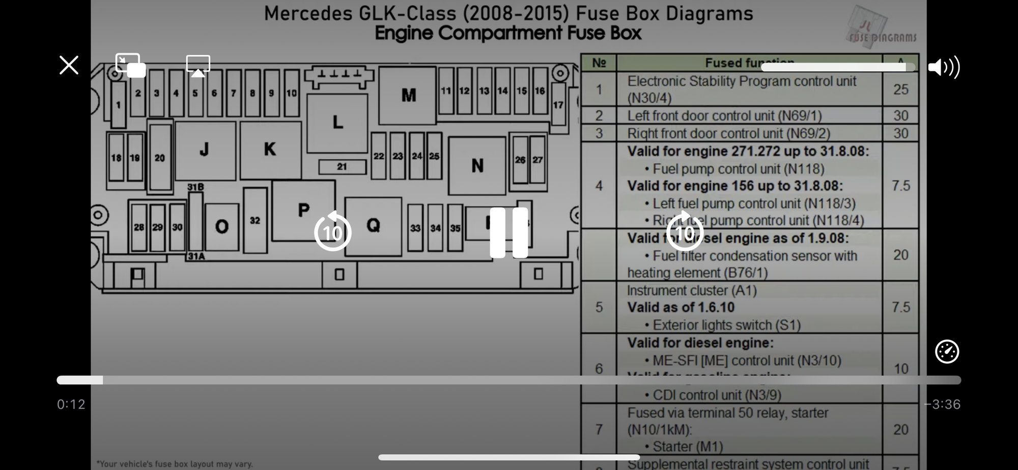

i even got fuse diag checked all fuses.., esp fuses all good:
#1,14,20

I'm not sure what you're getting at, but the numbers in the second screen shot make perfect sense if the car was turning to the right, or, if it's over 787 meters, the overall course was to the right. The numbers in the first screen shot show the car going in a straight line, or averaging equal amounts of left hand and right hand turning.

Hey @John CC
at both iterations of pics vehicle is driving straight and not turning.
What im showing in the first pic is a rare anomaly for my wss’s where they’re all “in-sync”. They’re is never, never a time where they’re all synced.
the Second pic is during decell where you can see tracking way off; could be due to brakes grabbing differently but car doesn’t pull.. nor “brake hard” as if abs is compensating.
so, if someone is willing to video they’re RIX data and prove out that in all cases.. the wss’s need to be syncd’ then I can parts bingo swap my wss’s for all new and worse case replace both rear tone rings after wss swaps..
