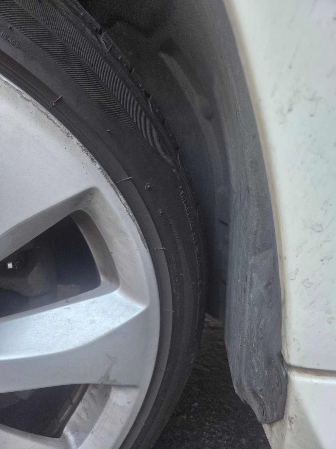

GLK350 2011 RWD
Originally Posted by John CC
Turn the steering full lock then see how much clearance you have, then
I turned the full lock, here how it looks like. I can put the biggest finger in the gap, so by avg estimation there is 1 more inch possible to put in. What do you guys think?
