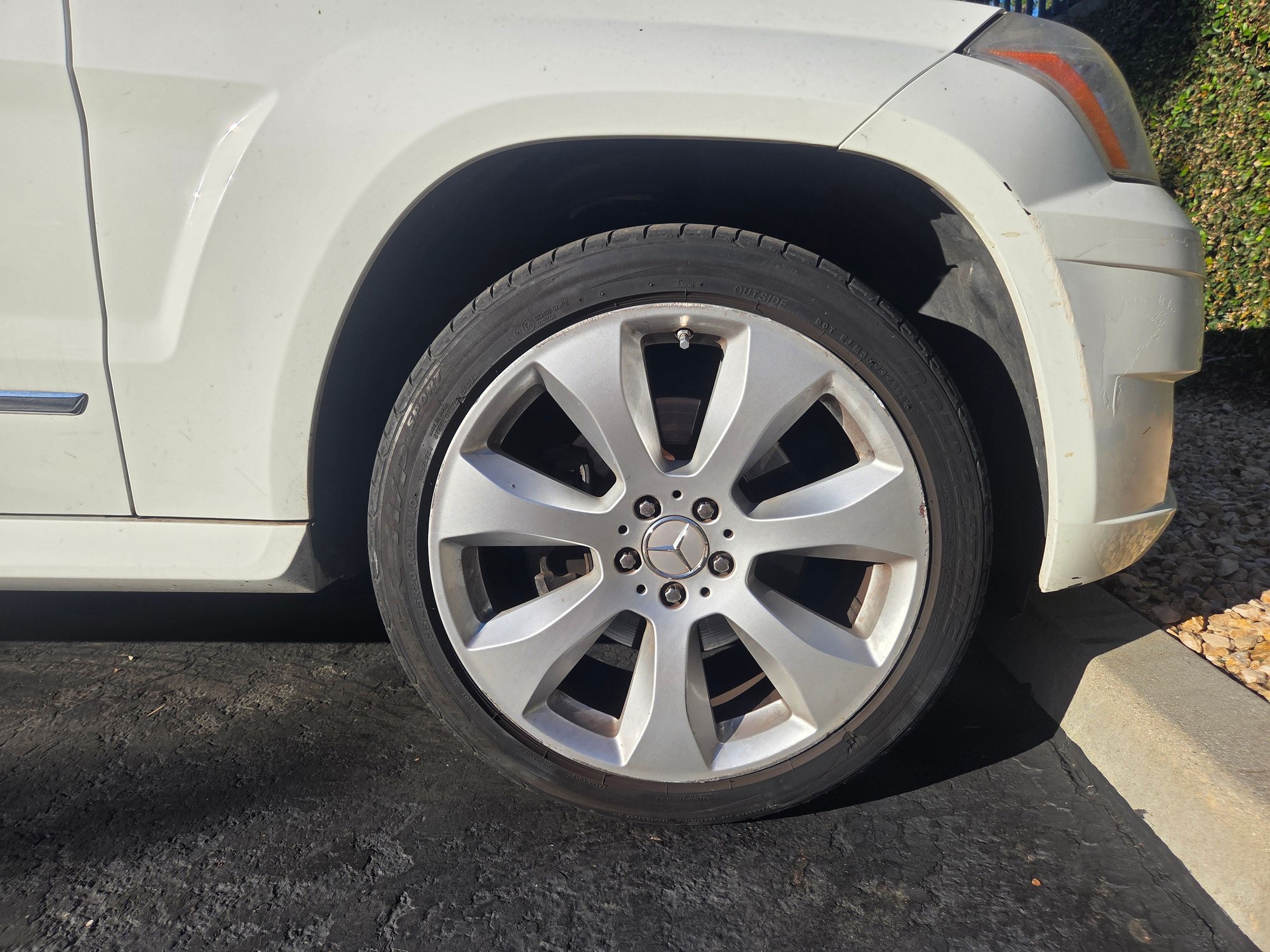

just for reference, this is my front and rear wheel. in my opinion, there is PLENTY OF space to fit in
front
front
rear
rear

At the top of the page click on Tools-> Tire rim calculator.
Turn the steering full lock then see how much clearance you have, then try to imagine what would happen if you drove over a bump.

That's 10% larger, 3% is normally the recommended limit. You'll have huge speedometer error, reduced acceleration, reduced braking ability and probably you can only drive in a straight line without rubbing.

got it. thanks for your input
