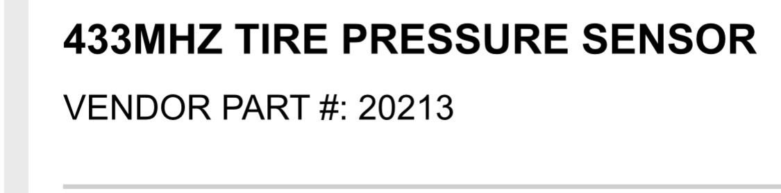

Tire rack sent me 4 #20213 for my 13 gas that work . No programming . But they took a few hours to auto connect . They have worked fine.

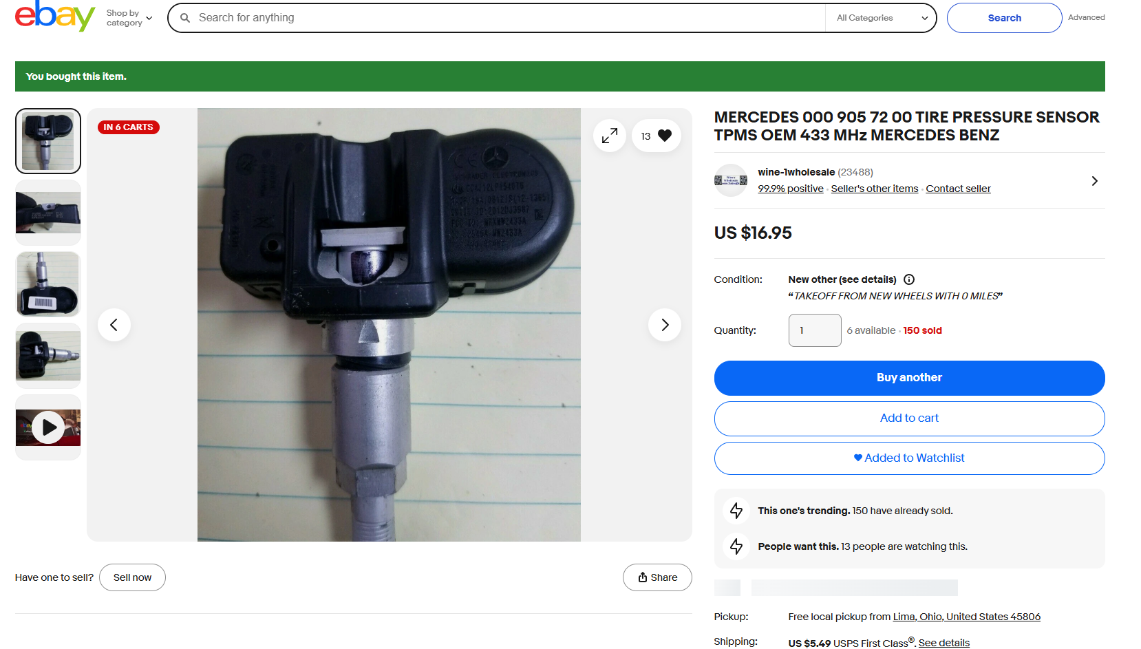

1st time was when a sensor battery died. I bought a generic sensor on ebay and it worked perfectly. had a tire shop swap it out and it linked up to the car within driving 2 minutes. It was automatic and I did not have to do anything.
After that I found a seller on ebay selling Mercedes "new-take off sensors" so I bought 4 and they work perfectly. I originally just bought 1 to replace a dead sensor myself. Then shortly after another sensor died so i repeated the process. I swapped the sensors myself using a floor jack to push the tire off the rim and was able to stick my hand inside and replace them.
Then I was having 4 new tires installed so I had the generic sensor replaced with a Mercedes branded sensor, and had the last old sensor replaced.
heres what the generic sensor looked like. Its not the exact listing i bought from.
Heres the exact listing for the MB sensors I bought and have installed right now: Even though they were listed as new I went ahead and bought the Schrader rebuild kits to replace the stem, nuts, gasket, cap and valve core.

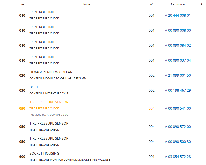

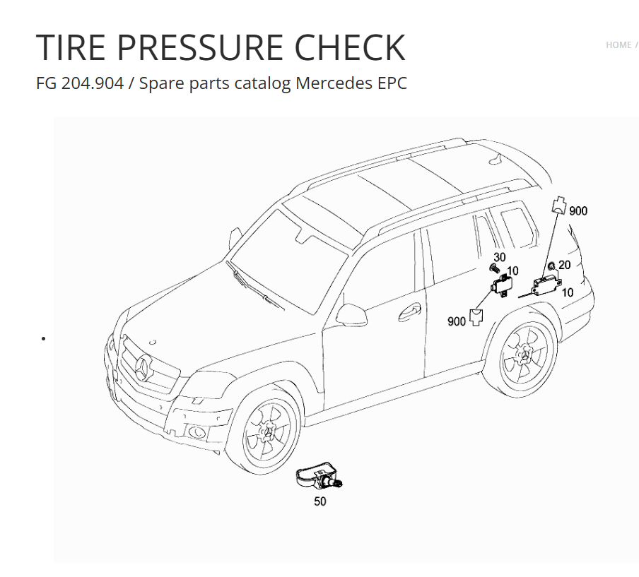

I looked up the parts diagrams. Not sure of your vin so i picked GLK250 Bluetec.
It shows the same sensors I used as working.
https://www.ebay.com/itm/155662191606
Only 6 left. (Right now...)
