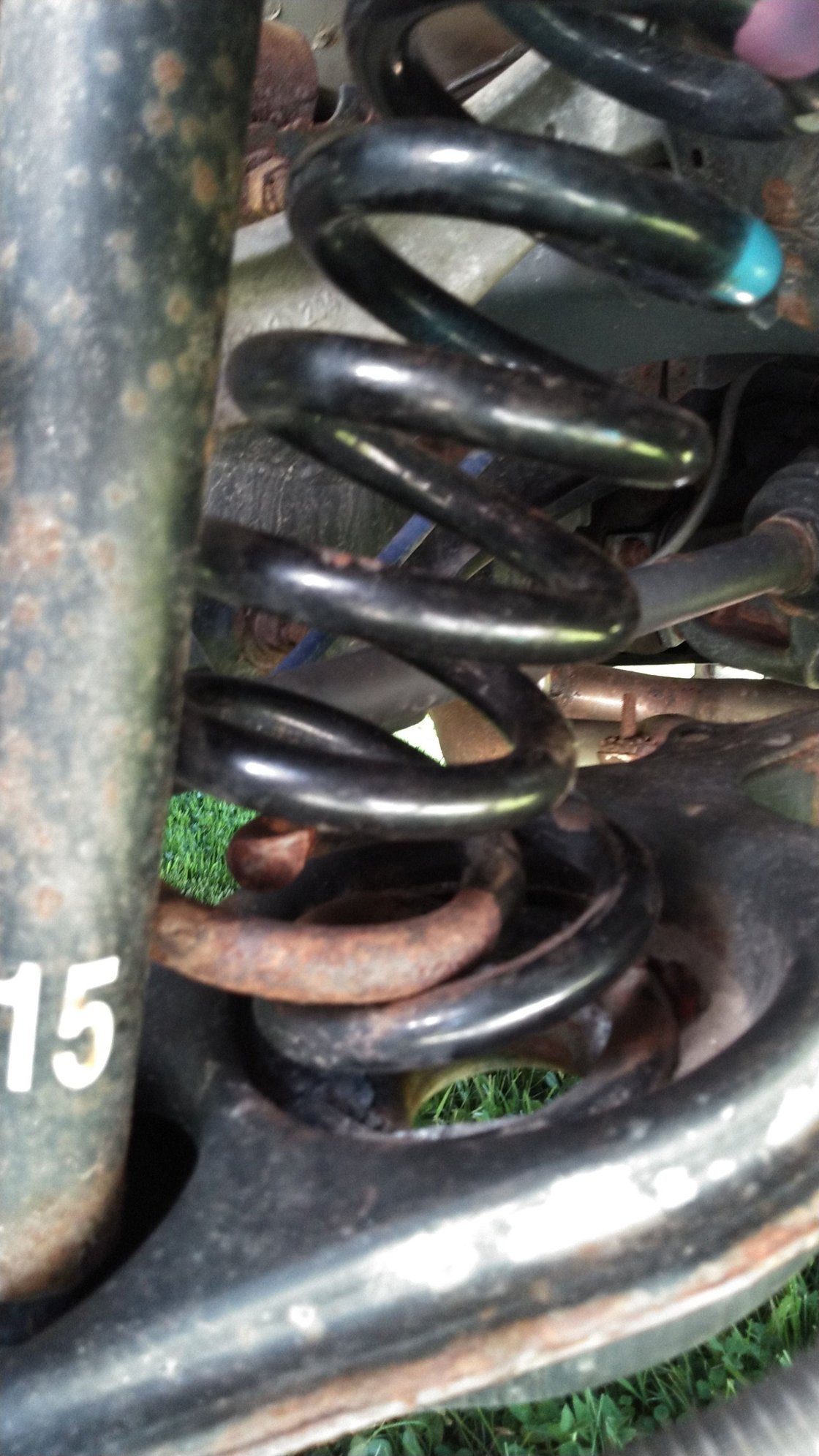

So we recently picked up an inexpensive GLK250 and I’ve been picking away at a few issues. After inspecting the rear suspension for a floaty/sway feeling I’ve found the left coil has a broken piece at the bottom. It looks like some have had success replacing without a specific compressor so will tackle this myself. After reading comments, some have had issues with Sachs and other brands increasing ride height. I definitely don’t want it to ride higher and have contemplated lowering. Can anyone comment on springs that won’t raise the rear? Should I grab a set of lowering springs and just throw the rears in for now if I was thinking of going this route? Personal experiences appreciated.

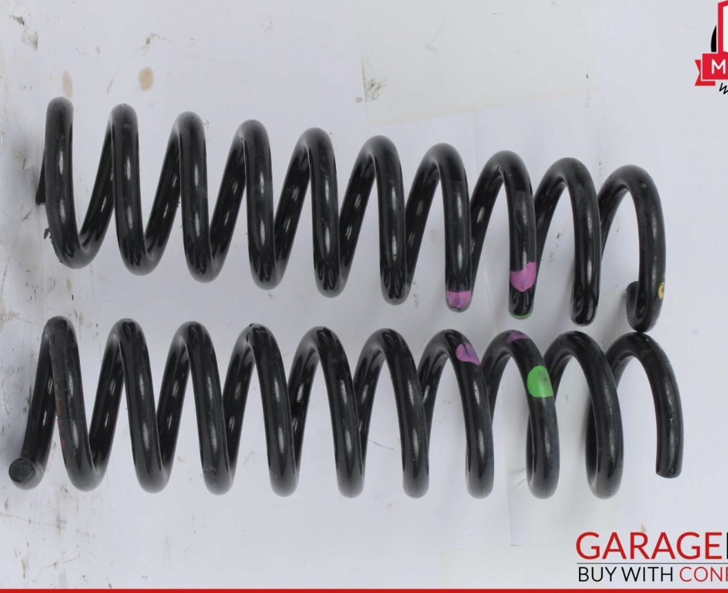

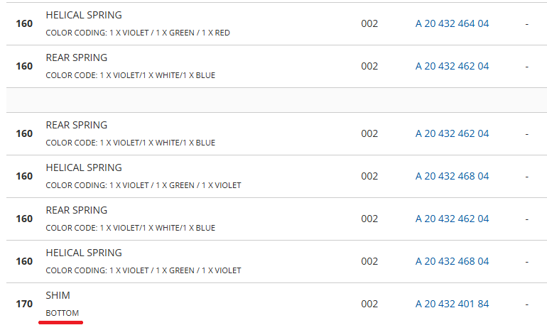

I would just replace with the same Mercedes springs.
If they are the originals they should have different color paint dots on them indicating which specific ones they are.

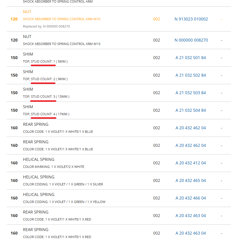

The bottom shims are just thin stamped metal and are probably worn to nothing and should be replaced. The upper shims are rubber and look like a big hockey puck. My old ones looked fine so reused. There are a few different thicknesses for the upper shims, other than measuring them they have a certain number of nubs on them. I happen to be at my local MB dealer parts dept picking up some parts and had the person look up the exact part #'s with what my car came from the factory with using my vin.

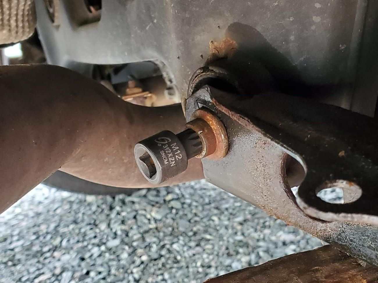

I replaced the springs without a spring compressor. Support and take the tension off the inner spring control arm with a floor jack, remove the nut and bolt then slowly lower the jack all the way and you can pull the springs out safely. Using a cordless impact wrench to spin the bolt out came in handy. Just go slow and make sure all the tension is off the bolts, dont want to snap the bolt. While doing the springs i realized the spring control arms are rusted as well so I have a set i'll be installing hopefully this summer.
I did have to buy an M12 triple square socket for the bolt heads. The nuts use a regular socket.

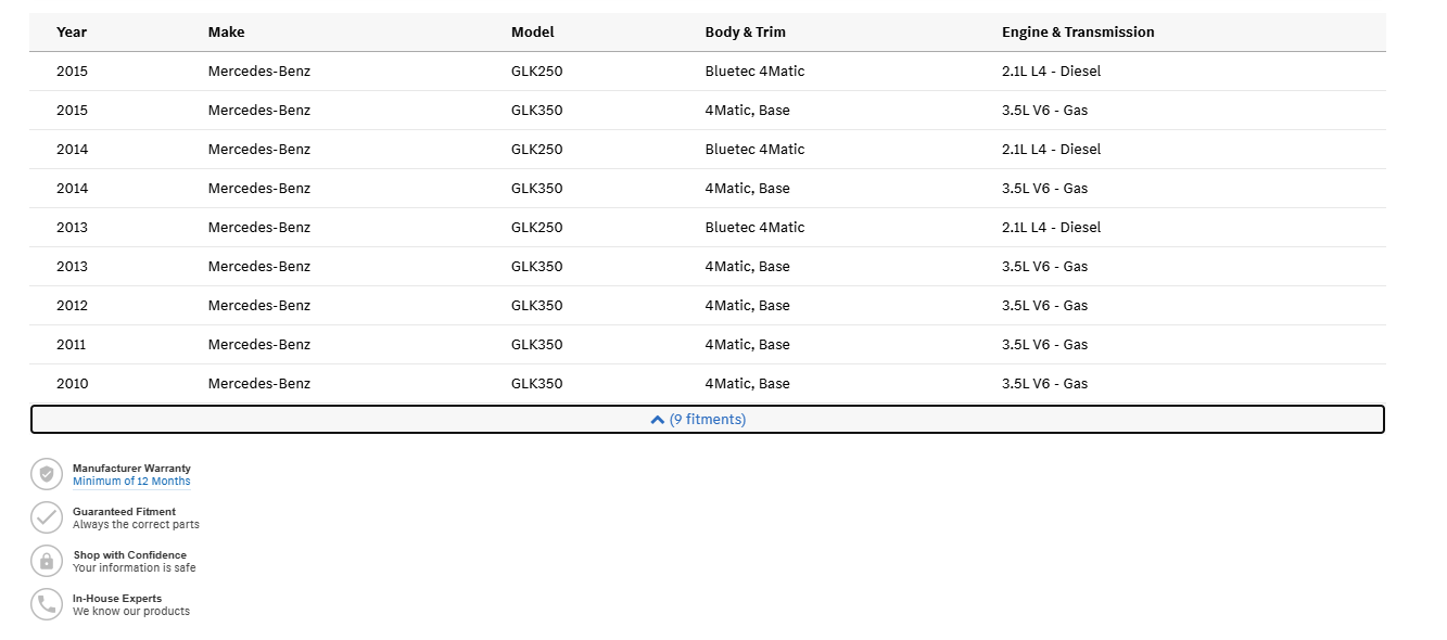

With the part #'s for the springs in the parts diagrams above you can plug them into this website https://www.mbpartsource.com/oem-par...ing-2043246204 and see which submodels they come in.
They will all fit. If you dont have the sports suspension you can always buy the springs that come with the sports suspension and install them. When one of my front springs broke I ordered a replacement sports strut but was sent a strut for the luxury/base. I installed it since I needed to drive the car while waiting for the correct strut and it fit fine, it was just a little taller.

The bottom shim is reportedly magnesium and is part of the "anti corrosion" package. I'd say it doesn't work that well, given all the broken springs and rusted control arms, but they certainly don't make it any worse. Replace them with new.
