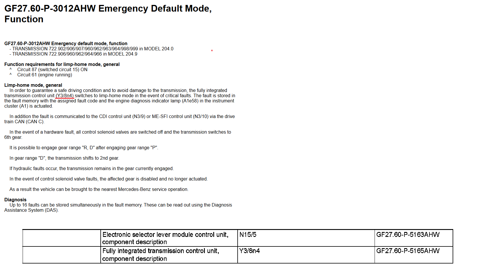

If Y3/8n4 is bad, you’re eventually going to run into a situation that will trigger limp mode. That’s why there’s a big and IF. It’s just so common and can be caused by other things that some states are exempting it where it is the sole failure on emission inspection.

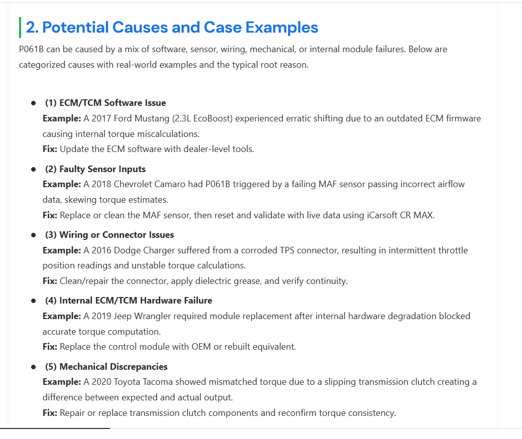

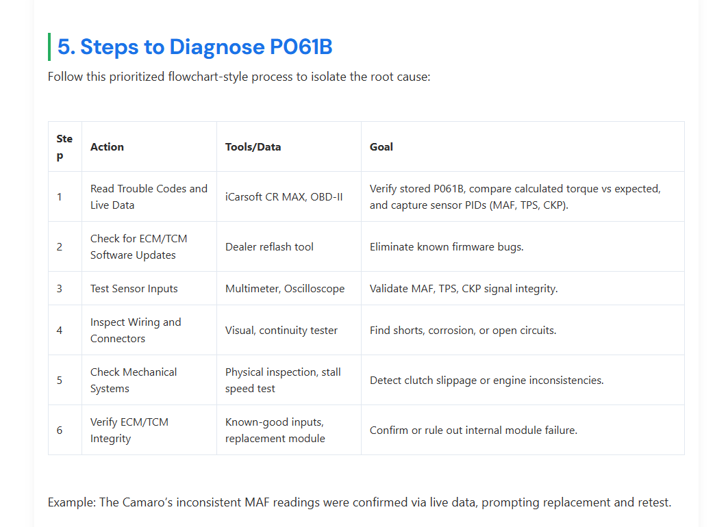

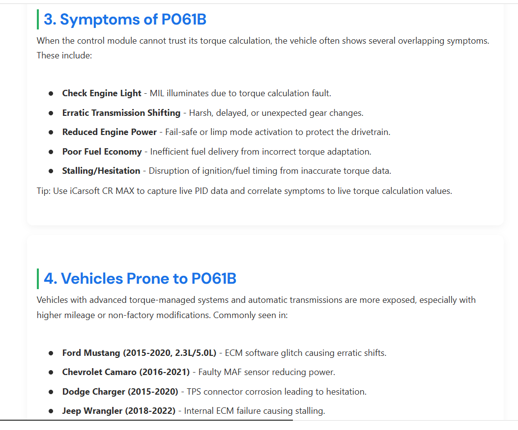

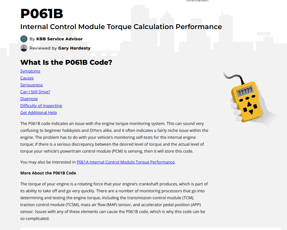

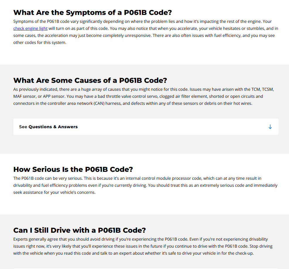

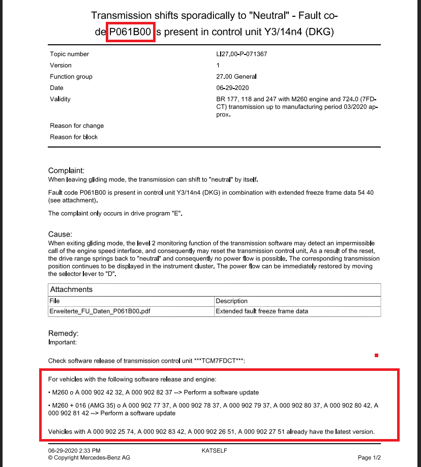

Spent about 20 minutes searching for that code and reading about it. From KBB they say it can be complicated to diagnose and fix, also says you should avoid driving the car. You may not have a check engine light on now but it could be triggered in the future or even could have been on and erased previously. From reading thru threads a few people have dealt with the code who have tuned the car, one person had the ECU replaced to solve the code fault.

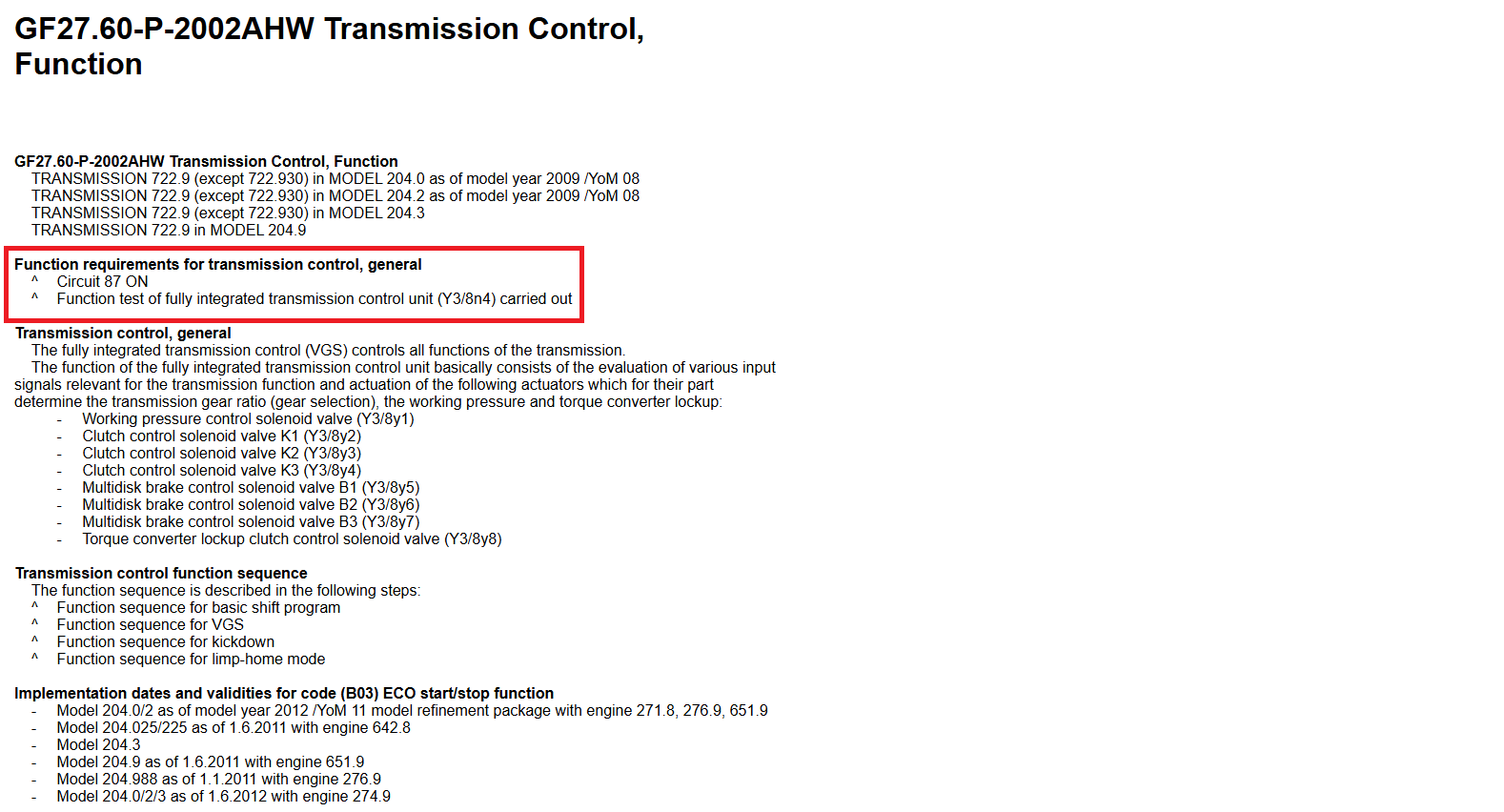

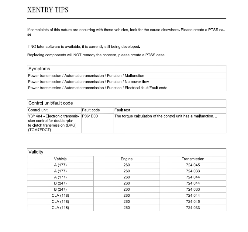

Came across a Xentry worksheet on code P061B00 which is not the same but looks similar. That involved a software update apparently.

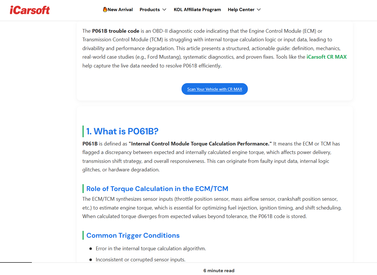

iCarsoft has a good article on P061B. They use examples for other cars and list the solution. Could be simple and inexpensive or could be expensive.

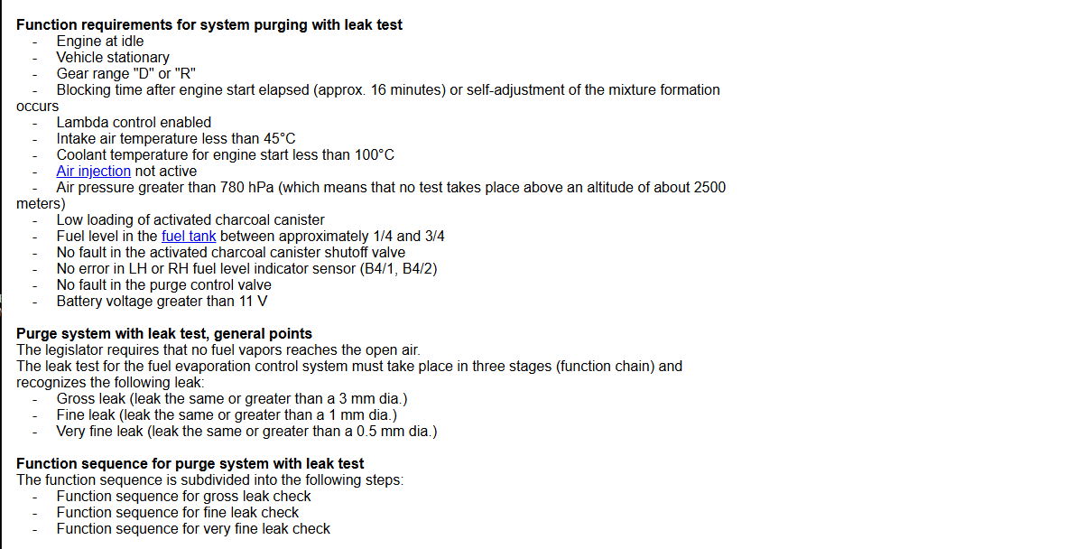

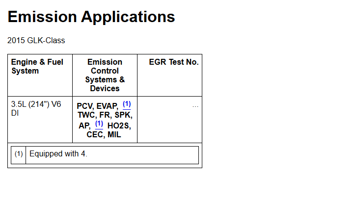

I dont see how this code would effect emissions. The emissions checks if your cats/O2 sensors are working, checks fuel system for leaks, think that may be it but could be missing something. This P061B code seems related to drivability of the car. The car could be saying its not ready yet due to the specific drive cycles not being completed, car hasnt been driven enough after codes erased. I could be wrong but I think my obd scanner will perform the tests.
Heres the requierments for the fuel system leak tests.

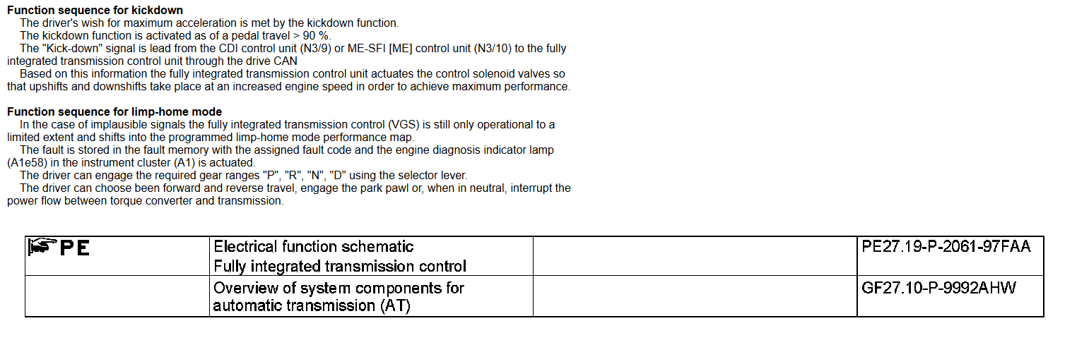

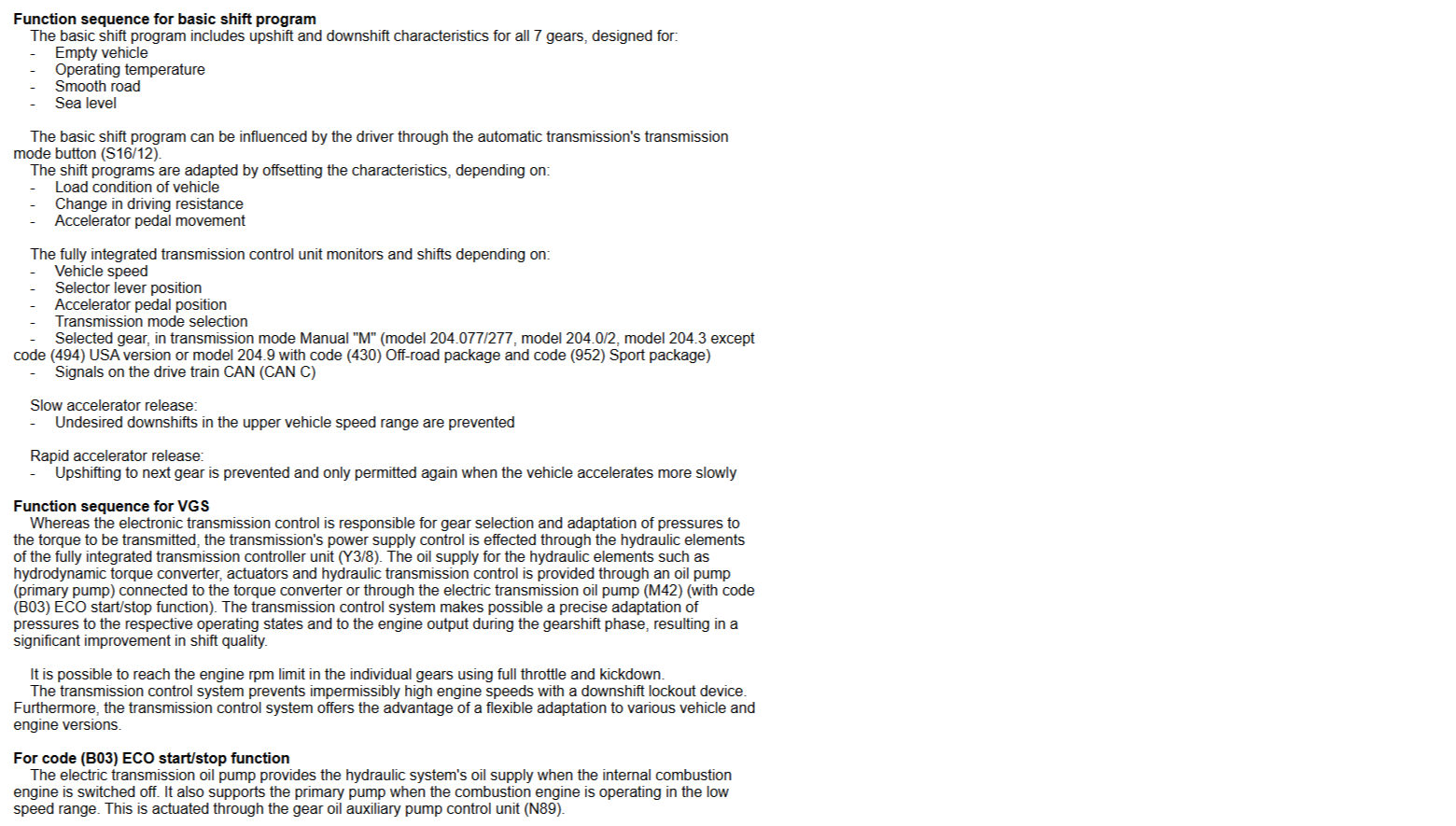

It’s deeper than I ever went and I’ve been pretty deep into the 722.9.
