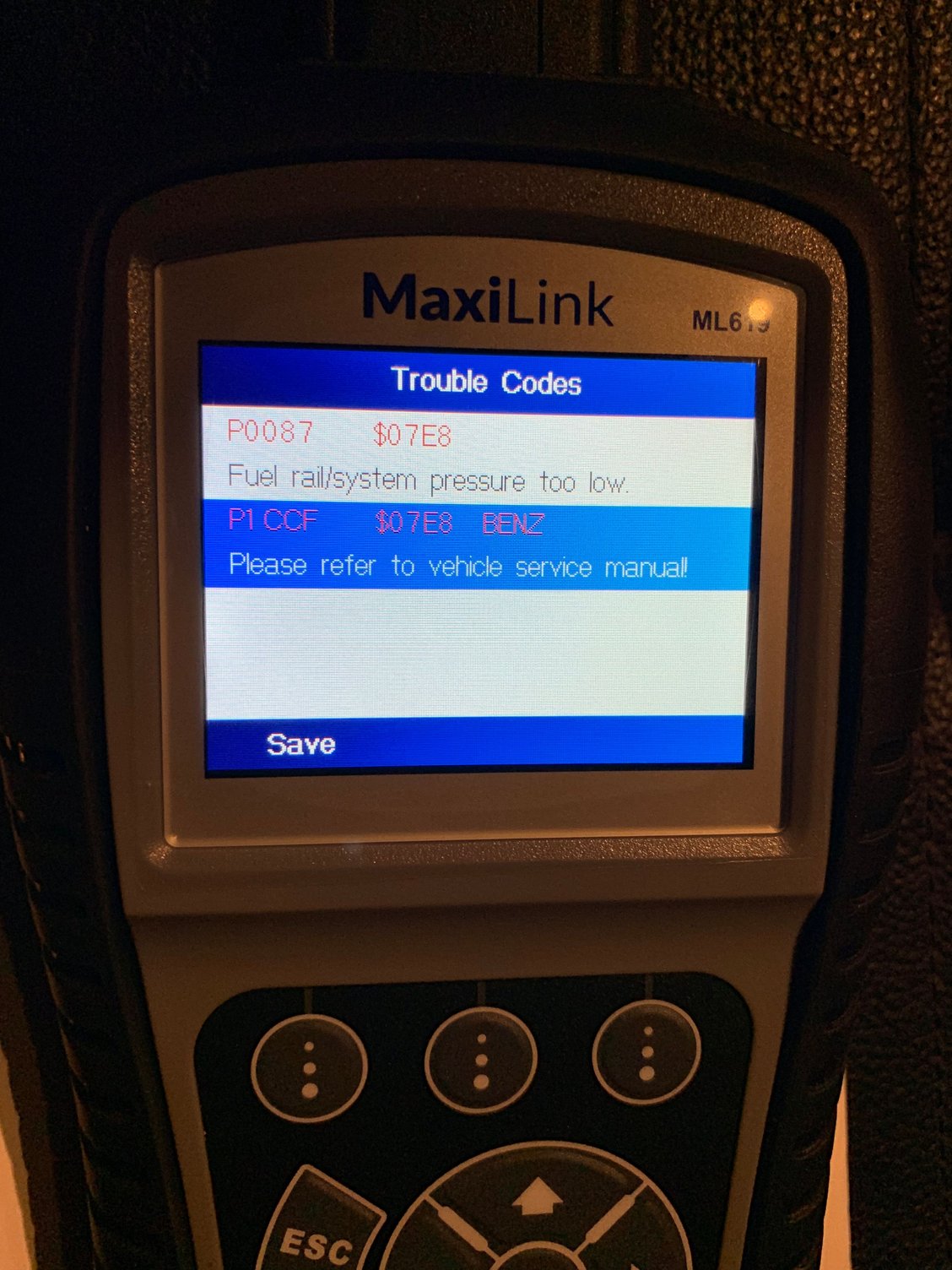

I have a early 2017 (first use May 2016) GLS$50 with 57k so just out of warranty, it seems as if the fuel pump may have failed. The vehicle will not start, it does attempt to start but seems to starved of fuel, this is reinforced by the error codes: P0087 - Fuel rail/system pressure too low & P1 CCF.
My issue is I cannot locate the fuel pump, It is not under the middle row seats (per GL450) not in the footwell of the front seats, i can only assume it is under the third row seat?? but there does not appear to be the space for it to located there?? I have not yet removed these seats to check.
Can anyone be of assistance?

Are you sure the filter is not clogged up?
Is there some reason you don't want to ask MB to fix it?

Hi, thanks for responding, it may well be a blocked fuel filters, but t believe the filter and pump are in the same location on this vehicle? So I would still need locate it to inspect..
Regarding MB doing the repair, the vehicle is no longer under warranty and this is a relatively easy fix, if only I could locate the pump, without tearing the whole interior carpet out.

I just went through this with my X166. Thought it was the fuel pump or the sender unit as well but given the fuel standards now it's not too likely. Ended up getting a C4 scanner to diagnose and the active test showed it was the left high pressure pump instead. It's almost impossible to diagnose the problem without the MB Star scanner.

I think I have a similar problem. Has anyone confirmed where the access holes are in the floor for the fuel pump and sender? In the previous gen X164 they are below the middle row seats. I just removed both seats of my X166 and I see nothing under the carpet but solid steel with some sound deadener. Did they eliminate the top access and make you remove the exhaust and drop the tank just to access? Or an I not looking in the right place? Thanks.

docfnky, was there a specific code that told you it was the left high pressure pump instead of the fuel pump? Or did you have to run through a series of scenarios to narrow it down? I had the dealership check it out and they recommended replacing the fuel pump ($1,800.00 ). But like you, I'm skeptical and want to try and diagnose myself. Thanks.
