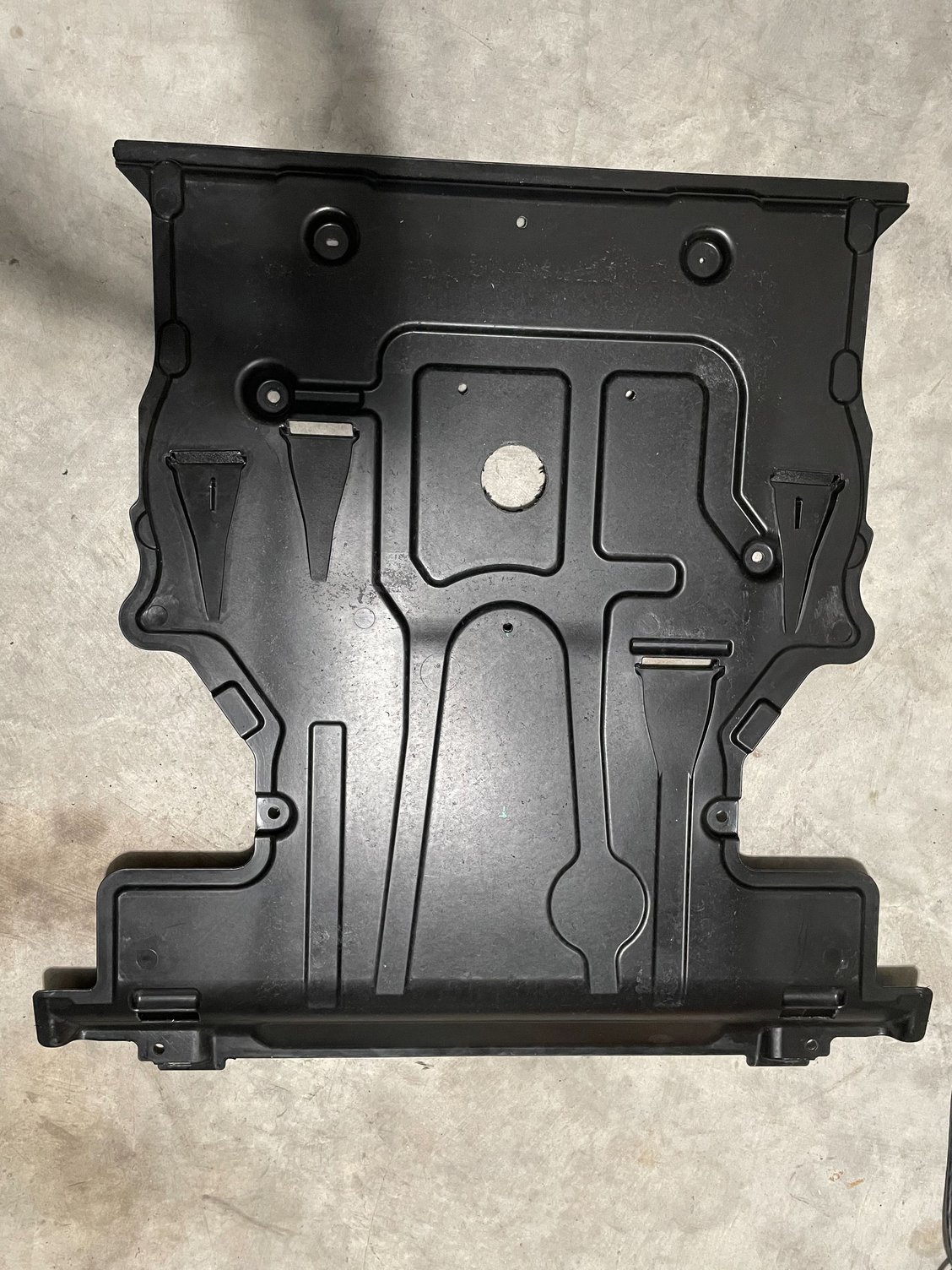

I cut a hole in the belly pan so don't need to remove it during my next oil change. Have to stuff some rugs or so to prevent it from over-splashing on the inside during the drain.

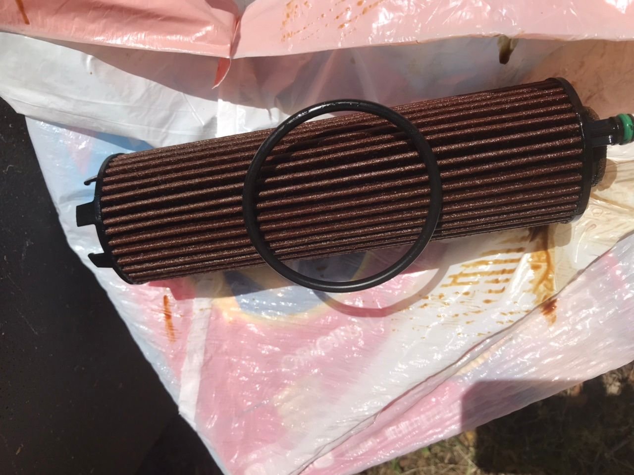

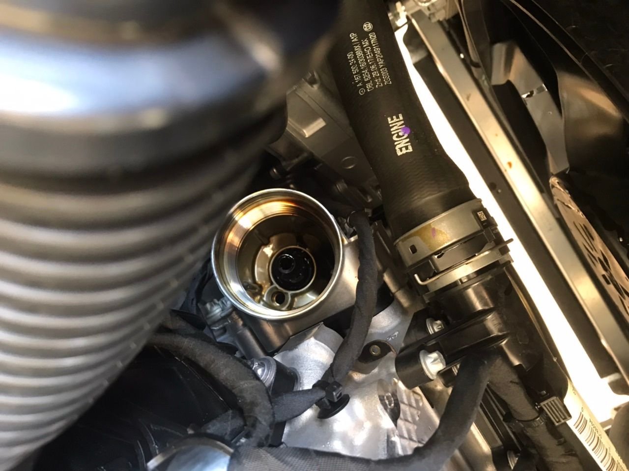

1) This is done before draining the oil to make sure you have the tools to remove the filter and the correct filter before training the oil and then it’s too late. Remove the inner retaining clips from the air intake vent then remove The actual retaining clip. Swivel the air duct out of the way which is pretty neat because the Mercedes emblem is integrated in and it rotates.
2) Use the filter housing removing tool or socket (I have to post the size I forgot) to remove the filter housing.

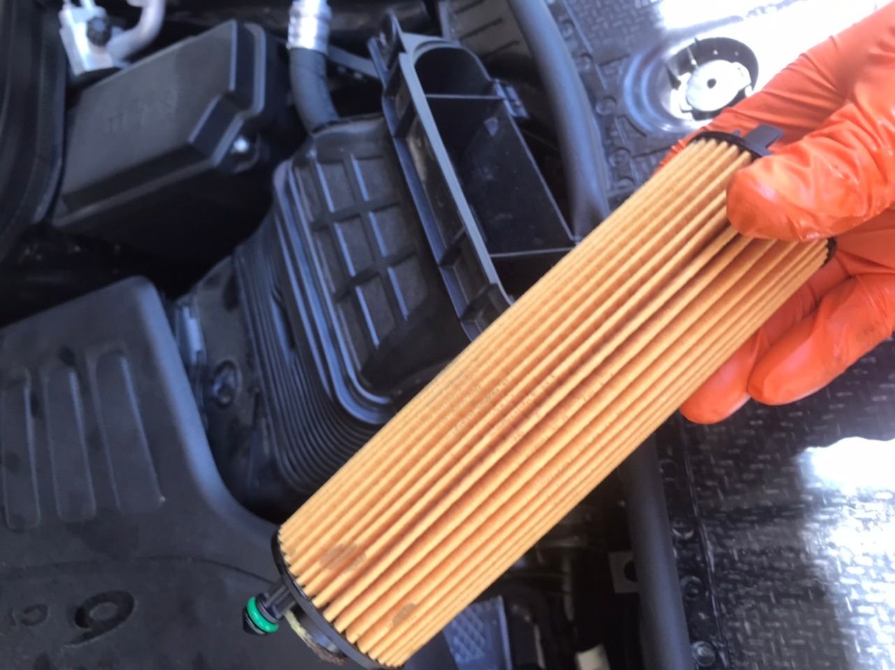

3) Remove the old filter and gaskets and replace them with new. There’s only one way the filter can go in due to the barb protrusion so put the filter in the engine first then screw the cap over it. If you put the filter in the cap first and then try to screw them both in at the same time you could break the barb off. When it’s all done just hand tighten until the housing is snug. Once the housing is tightened to the point that it contacts the metal portion of the engine, apply 25 Nm. Do not try to over tighten because you’ll just crack the housing. Having the filter housing on when you drain the oil will slightly reduce the velocity of the oil draining when that step is performed and therefore result in less of a mess.
Notice the area for the barb to enter
Old filter
New filter with barb on bottom

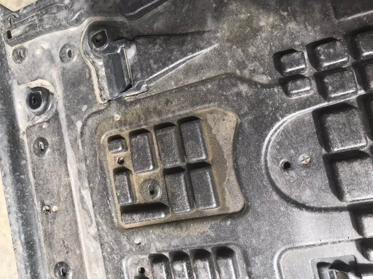

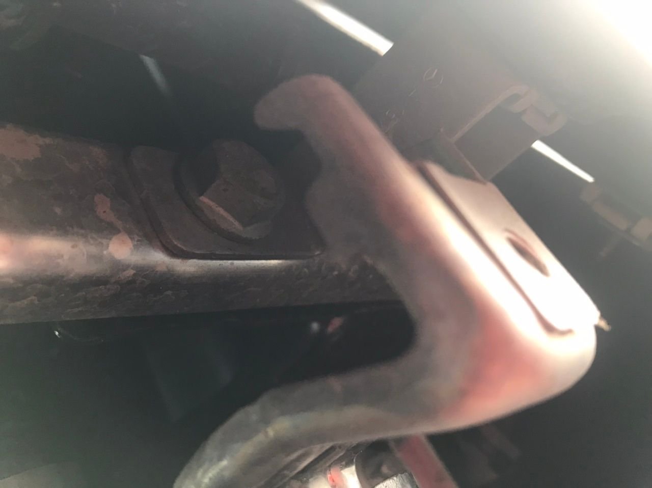

6) remove the bottom guard and note that the front is held on by two retaining hooks so don’t just jerk it off or you will break the guard…it has to be pushed towards the front of the vehicle pull down just slightly and then removed it’s a lot easier than what it sounds.
Lift guard cutout section above metal retaining hook when removing and replacing…don’t pull or jerk as it may brake.
Bottom splashguard removed. I believe it was 8 screws. No need to loosen other splash guards to remove this single one like some other Mercedes vehicles.

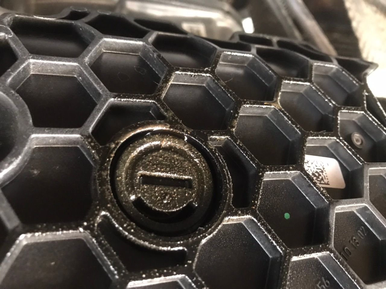

First oil change had oil leaking around factory drain plug this was before it was touched at all. By the time the vehicle needed an all change, The level when checked electronically on the dash was showing the level between minimum and maximum and initially it was maximum. This could’ve been just regular oil usage as well but still not too excited about the oil visibly present on a brand new vehicle… again I use to change oil as a means to pay for my college and this is not normal to me.
Factory oil leakage before first oil change

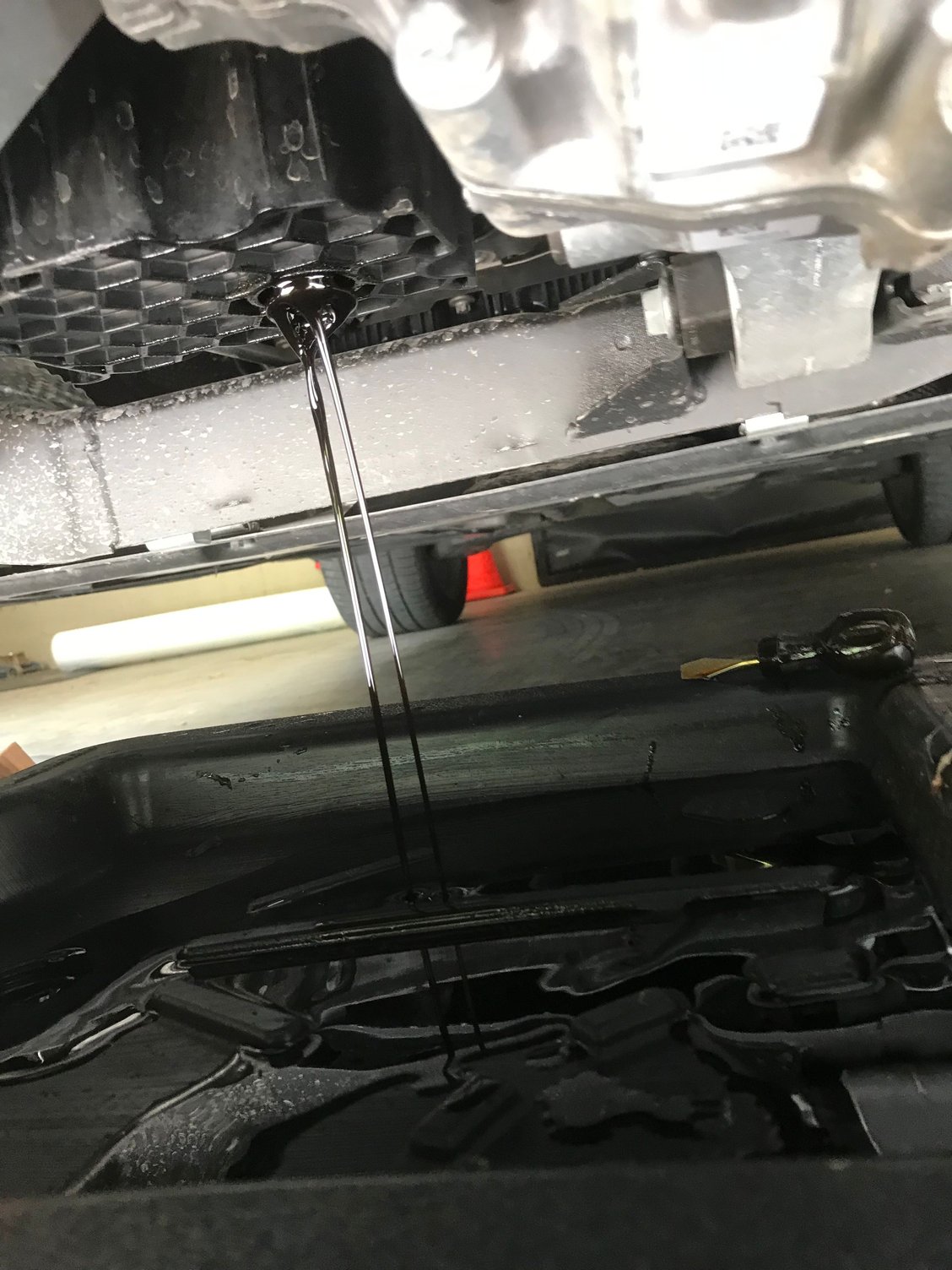

6) lay down a little plastic or cardboard and then put the oil catch container under the drain.

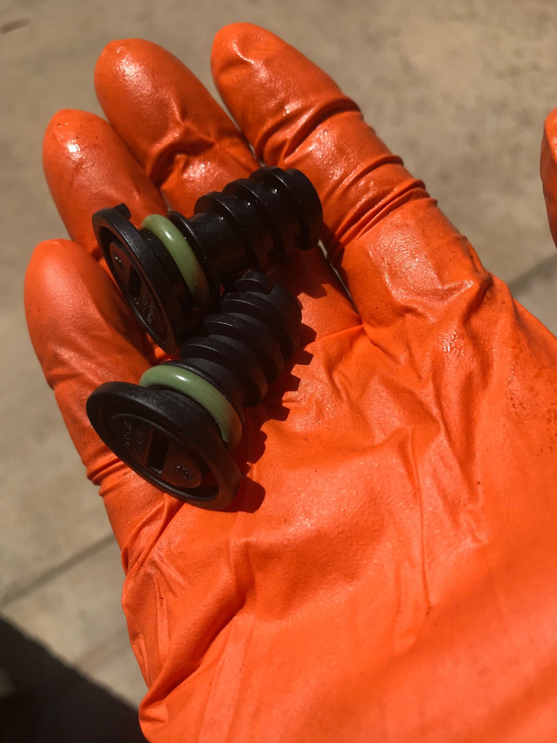

7) With a flat head screwdriver, unscrew the drain plug but not all of the way because you don’t want to make a mess… let the vehicle start draining. Have a beer or dram of whiskey and then put the new oil drain plug in and tighten. I wish Mercedes would’ve mold it to alignment arrows or lines in the plug and oil pan for verification but… when it’s hand tight it will just stop turning and if you over tighten all it will do is deform the plastic slot where the screwdriver goes. No Nm specified for the plug.
Leaving the drain plug and does not make a mess
New and old plugs

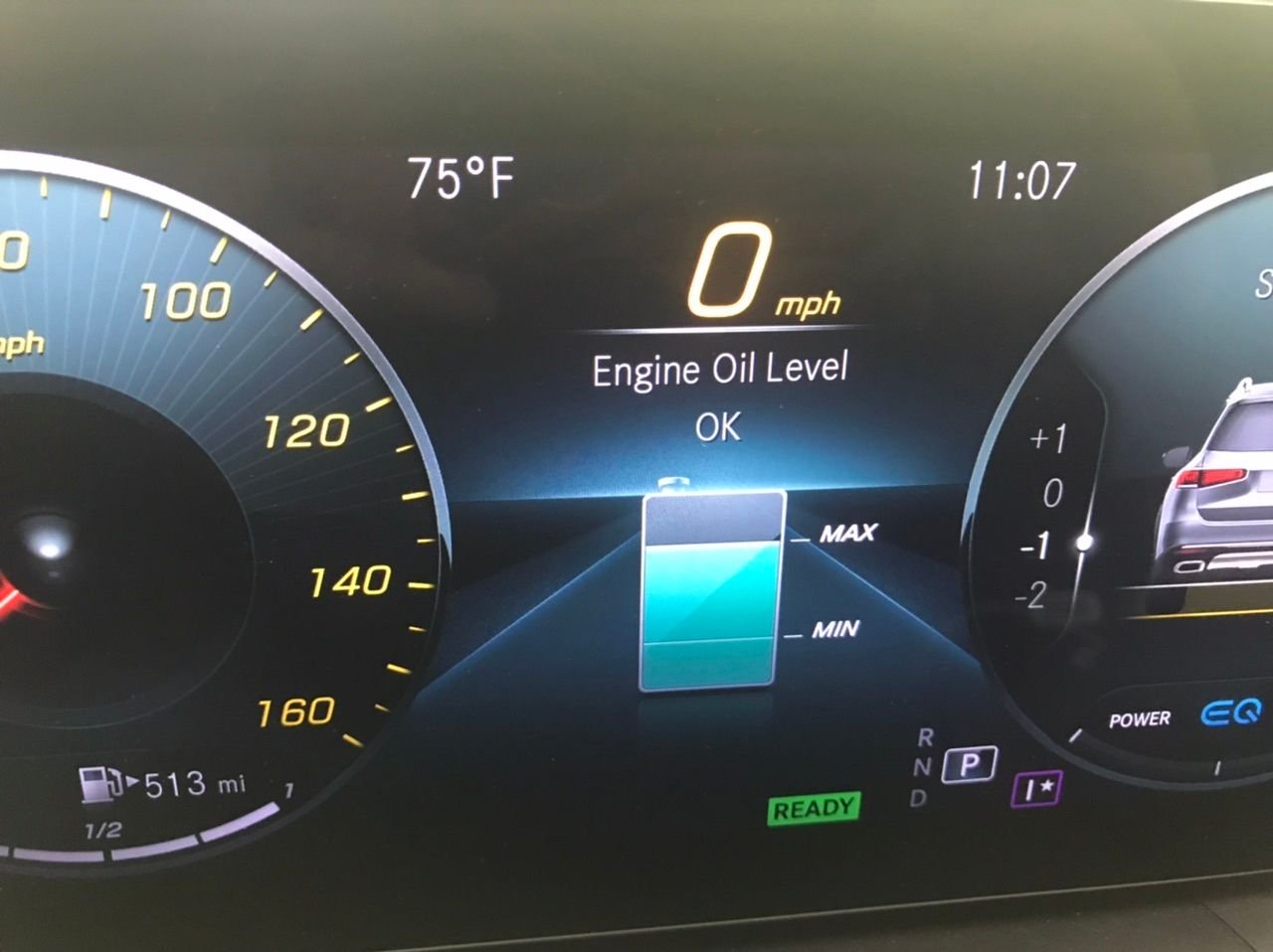

9) Start the engine and check for leaks. Let the engine run and check the oil level via computer:

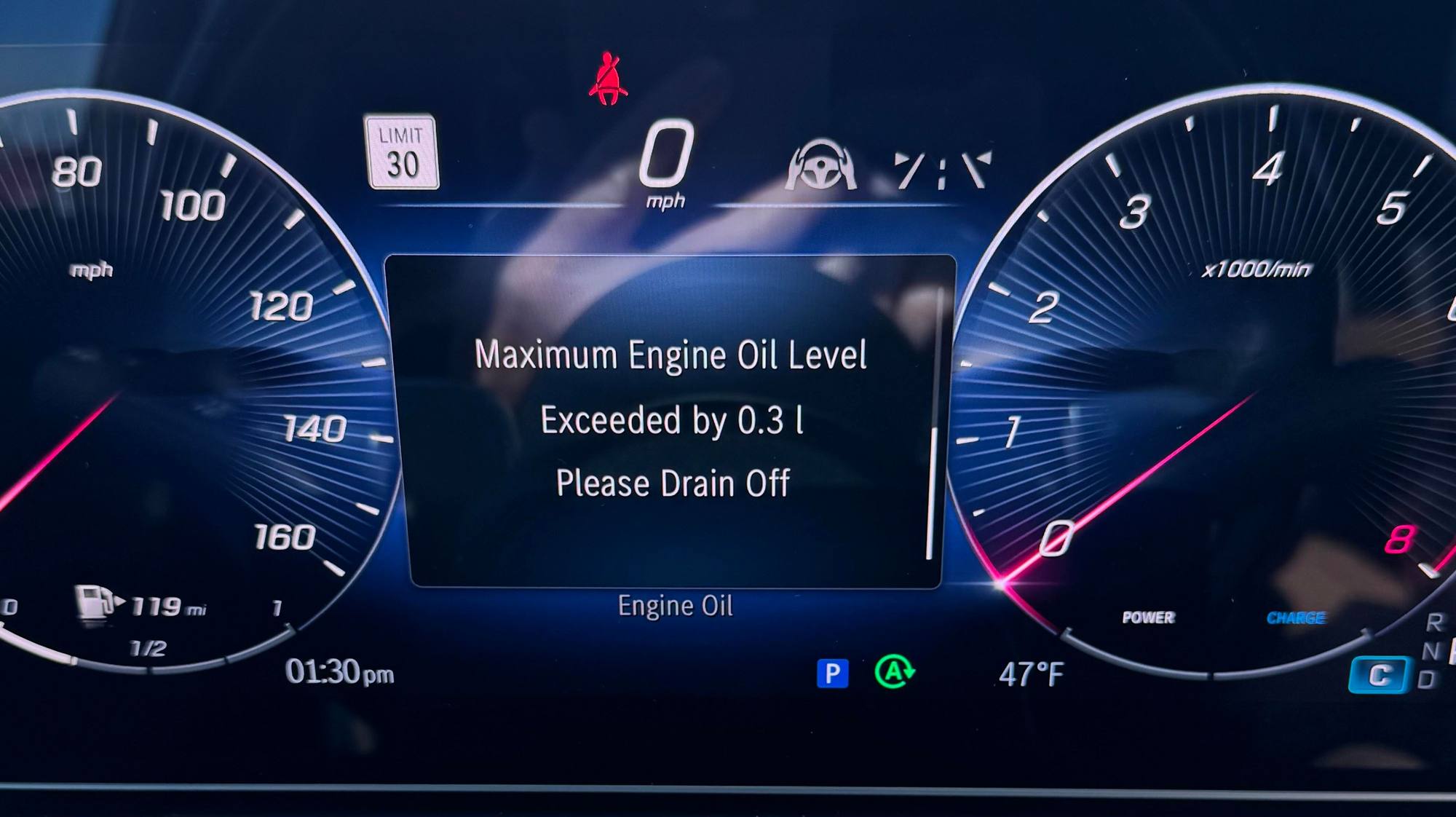

2024 GLS450 1st oil change confusion on capacity

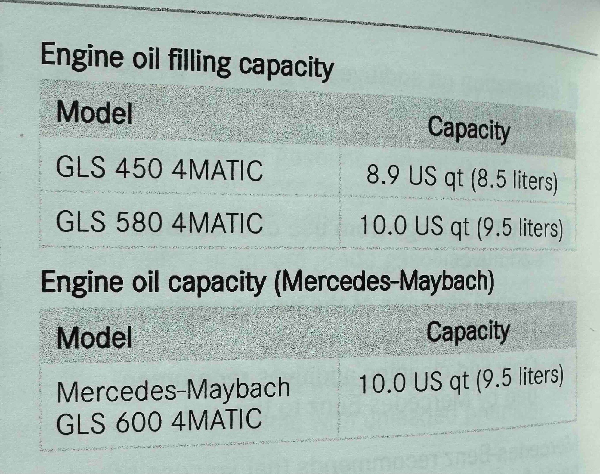

The service manual that came with my 2024 GLS450 indicates 8.5 liters of engine oil but the onboard computer engine oil checking says the max capacity is 8 liters of engine oil. Which one is correct? I called Mercedes and they said follow the book. I'm using the workshop -> engine oil to check the oil level. Holding the home button for 5 seconds and then the OK button for 10 to get the workshop app to show up.
Pour in 8 liters then check with the onboard computer with a warm engine. Add 0.5 liter if needed.
Old Jan 23, 2025 | 03:49 PM
  #38
dtmdogz's Avatar
Joined: Jan 2025
What is the correct oil capacity? 8 liters (computer) or 8.5 liters (book) 2024 GLS450 X167
Old Jan 23, 2025 | 05:48 PM
  #39
chassis's Avatar
Joined: Sep 2018
Posts: 14,663
Likes: 4,567
From: unbegrenzt
2017 GLE350 4MATIC
Don’t know. Use the on board indicator as the decider of “full”.
Buy 9 liters. Pour in 8 liters. Check the on board indicator. Add more oil if needed. If no more oil is needed, save the 1 liter for next time.
Don’t overthink this.

Total "Oil capacity" is one thing, but there will always be some oil remaining that didn't drain completely.
So the only way to do it right is sneak up on "Full" with the (electronic) dipstick.

Thank you for the answers. I didn't do a great job in explaining the interface on the 2024 GLS450, I think the pictures I've attached help explain. There's no oil dipstick. The only way to check the oil is through the workshop app which shows the measurement of the OIL numerically. Unfortunately, the book contradicts the computer for the OIL CAPACITY at 8.5 liters for book and 8 liters for computer. I went with 8.3 liters for mine,

That's why I called it an "electronic dipstick."
The fact still remains that there's no way to tell how much oil has been drained, and how much is left in the crank case.
Specifications don't know or tell that.
You have to add until full.

I believe the system targets +/- .5L for the warnings. I misread 10 Quarts for 10 Liters the first time I did our 580. The workshop menu showed exactly .5L over but it took two weeks for the overfill message to be shown. After reading the specs right and buying 5qt bottles the 2nd oil change landed about .2L or .3L over with no warnings.
