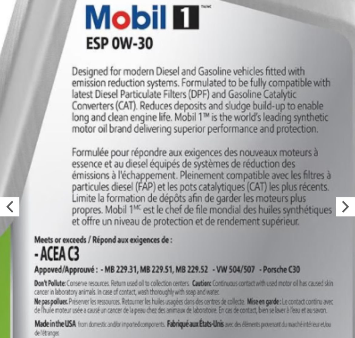

Mobil 1 ESP 0W-40 or 0W-30 & Mercedes 229.51 and 229.52 spec
Mobile1 ESP 5W-40 & Mercedes 229.51 spec

Sorry to tell you this but you used the wrong oil. 229.5 is not the same as 229.51. 229.5 is not up to date for this vehicle, unless you manual is different than mine, your engine can only use 229.51, 229.53, 229.61, 229.71. If you want to document the oil change for MB warranty I suggest you go out and get the correct spec. and change it, so you don't give them a reason to refuse engine warranty. I do my own oil changes too and used MB purchased oil last time. You can get other oils that are approved, see https://bevo.mercedes-benz.com/bevol...229.51_en.html
yeah you’re right it looks like I need to get the ESP. I’ll update the post to avoid any future confusion for others.
https://www.mobil.com/en-ca/passenge...bil-1-esp-0w40

Did this yesterday. Notes:
Service A popups started around 11 months use / 8,900 miles and said "Due in 27 days."
Oil used was Mobil 1 0w30 ESP from AutoZone. Meets 229.52.
Oil filter was Hengst 256 184 00 00.
If you choose to use the air suspension lift, do the lift first. Mine did not work unless car was running.
Air lift barely allows enough room for a 200 lb middle-age amateur mechanic. More clearance would make the work easier.
Do not drop one of the body clips that secure the air intake. Don't ask me how I know this.
Oil filter socket 27 mm was procured at Harbor Freight.
I replaced the drain screw with new item; the old one looked perfectly good and I would think these could actually be re-used a couple of times.
The belly pan can be replaced by starting some screws loosely at the front and then bending the pan slightly to position correctly at the back.
