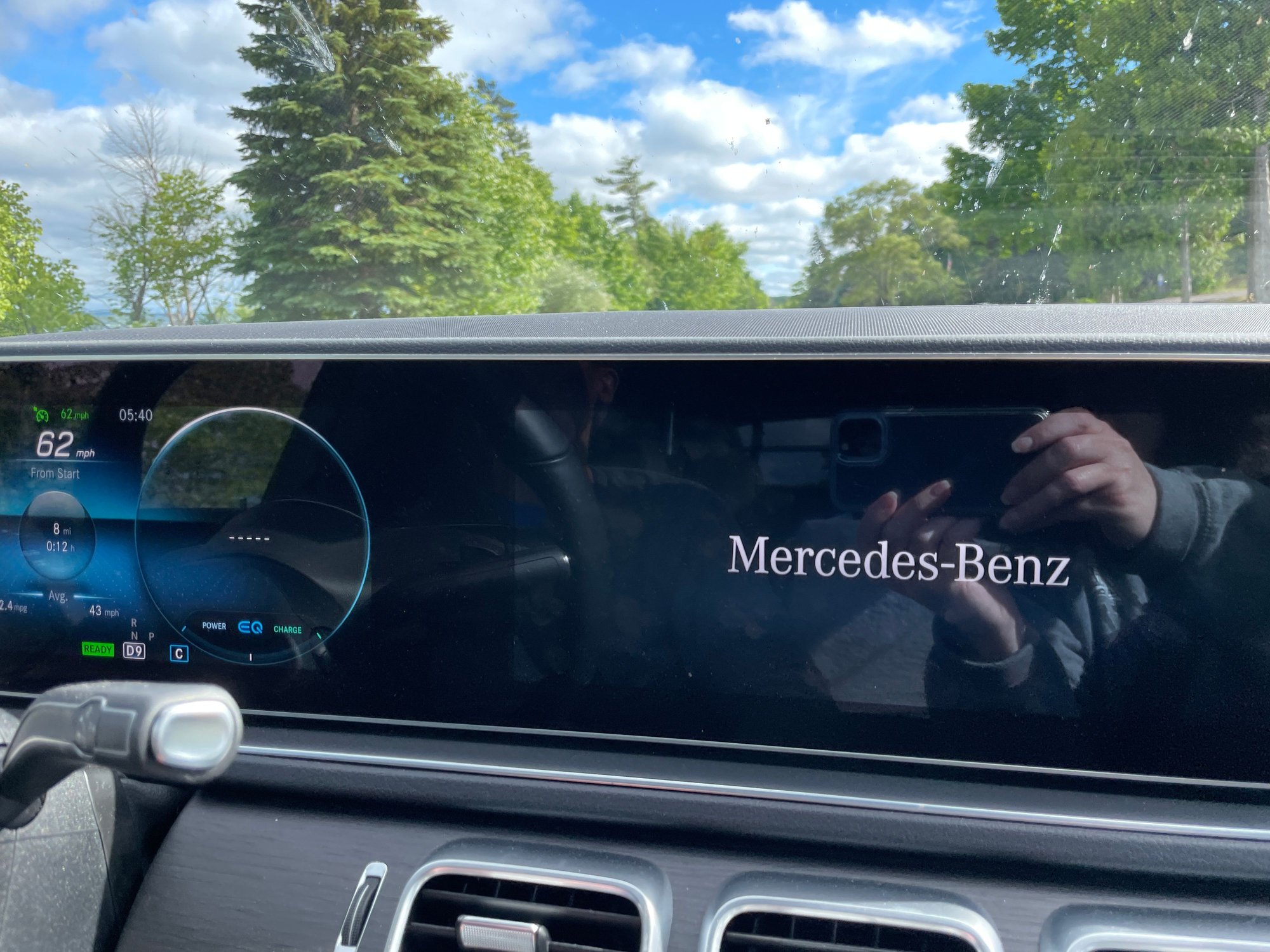

Dash computer is restarting over and over
My dash reset and part of the dash is blank and the big part just says Mercedes-Benz and it keeps resetting and never showing the Home Screen. It interiors the radio when it resets. We turned it off and let it sit a few hours and it didn’t fix it. Any ideas on how to get it to reset for good?

Internal hard drive is failing. Take it to the dealer and they'll know how to fix.

thank you! And OMG! This vehicle has been nothing but technical problems since I bought it this March. I’ve had multiple trips for false check engine warnings. Is it a lemon yet?
wanted to add that this was 100% right. The dealer thought they’d be able to download some software, but had to replace the hard drive. Thanks so much for the great diagnostic!

I think that it is likely that your problem is the subject of NHTSA recall number 21V354. Google that number and you can read it. Unfortunately, NHTSA says the status of the recall is "incomplete, remedy not yet available." The recall was issued May 14, 2021, and MB is supposed to notify everyone by letter of the recall. I have not gotten my letter yet, apparently because MB can't figure out how to fix the problem, which is thought to be software related. It is a recall - a serious safety issue - because the backup camera is inoperative and backup cameras are now required by law for safety reasons.
My GLS 580 was built in March of this year and in late March, with about 200 miles on the odometer, the MBUX did something similar; it just went blank on startup and would not come on at all. The radio was also inoperative. The dealer fooled with it all one afternoon, declared the main control unit deceased and then gave the car back to me with a blank screen after saying that they hoped to get a new control unit from Germany in three weeks or so. I locked the car in the garage overnight, and next afternoon the MBUX came back on and has not been a problem since. I posted about it last March. You might look at that thread and try the remedies discussed.
If it does not come back on after locking it and leaving it alone for a while, I would print the recall and take it to the dealer with the car and invite them to either fix it or give you your money back.

they did try the soft are fix saying they did it for someone else but had to replace the hard drive as Eaton said. It only took 4 days to get the part. I wouldn’t EM accept it back in the meantime as they attempted to have me do - I said that it was not drivable in that condition (no HVAC, distracting on/off of the screen, etc) I asked them to pull the fuse and they did that and had many, many safety errors alert. So there are more safety features than just the backup camera impacted. I get it back today, will update with the status in a week or so.
