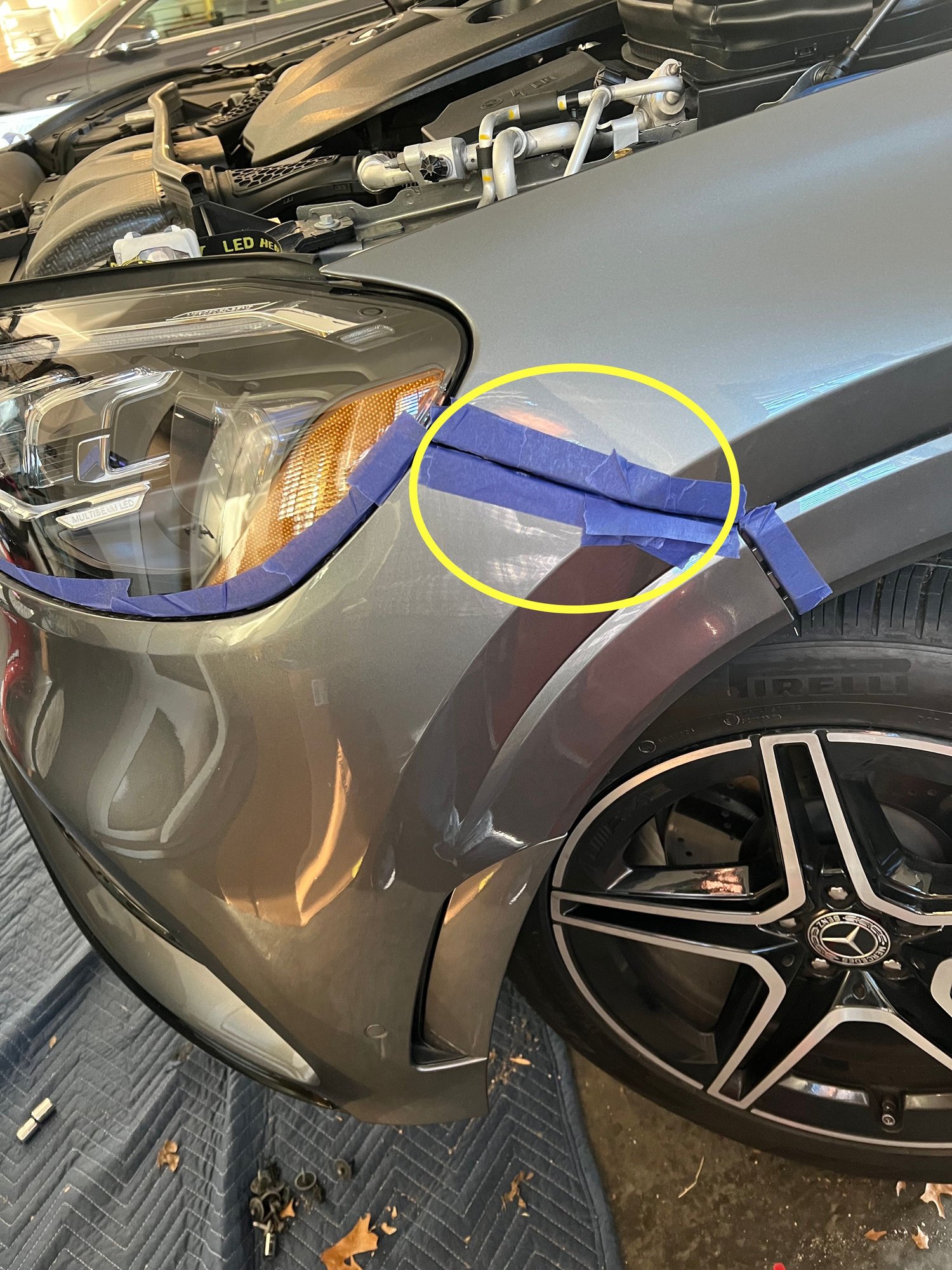

i am in middle of installing the cks grill and i ran to a problem.
I am unable to locate the 4x wheel arch trim clips on each side. I have AMG Night package, and the wheel arch trim on the front bumper looks to be 1 piece instead of 2.
Does anyone know it this step is neccessary for the AMG night package GLS450?
Here is a pic of showing no wheel arch trim:
AMG Night Package: (With the bumper wheel arch trim looking to be one piece as the bumper
https://cimg6.ibsrv.net/gimg/www.mbw...c640ef987.jpeg
Non-AMG Night Package: (with a plastic wheel arch trim)
https://cimg2.ibsrv.net/gimg/www.mbw...d2ca819b6.jpeg

It looks like the AMG Night package wheel arch front section is part of the bumper assembly, judging by the split in the arch at the bumper seam/edge. So you not need to remove this to remove the bumper - it will come away as is. For the regular one-piece wheel arch surround, the front part was unclipped just to release the bumper, but the arch stayed in place. So yes, looks like you can skip that step.

I also have the AMG Night package on my GLS and for the life of me I can't seem to be able to get the bumper to separate at the arch seem on the driver's side (came apart easily on the passenger side). I have removed the two upper bolts in that area so I know that's not the problem...any tips from the group?

Just finished installing the CKS grill on my GLS. Big shout out to clunker for putting together the guides above...they helped immensely. Like takkie my GLS has the AMG night package and I can confirm that the four clips on each side mentioned in the guide are not present and can be skipped. Another issue that I ran across was that there is a clip on each side of bumper right where it meets up with the seam on the fender flair that was not mentioned in clunker's guide (not sure if it's specific to the AMG package bumper or not). It was driving me crazy as the bumper wouldn't come loose. Wish I had a better picture but this is the keyhole slot where this clip goes in...
The plastic clip has a button top that only fits through the wider part of the hole. The problem is that you can't slide the assembly back to drop through without removing the other half of the fender flair from what I could tell. I eventually opted to just cut it off as there are plenty of other clips holding that area in place. Here's what the piece looks like that I cut off to give you an idea of what I'm talking about...
Lastly I'll mention that the four round push clips mentioned in step 3 of the guide needed to remove the TGS are an absolutely pain to get to release. In the end I couldn't get them to budge no matter what I did so I ended up shaving them down slightly with a razor blade so that we would push through the holes in the TGS. Hopefully both of these tips will save someone else some frustration.

haha - the plastic nut thing, i also had to break off one side in order to get it off. After one side is 'loose', the other one is easier to wiggle through (still difficult but more manageable)

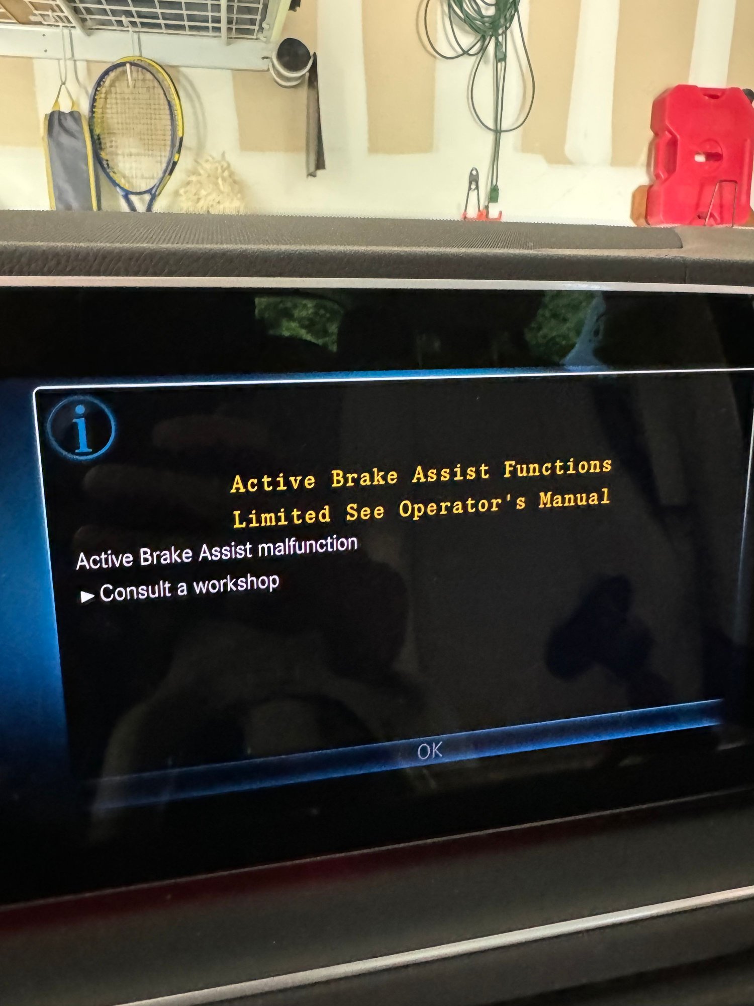

Did you guys get an error after the CKS grill was installed?
Old Oct 3, 2024 | 03:40 PM
clunker's Avatar
Joined: Feb 2022
Posts: 54
Likes: 18
X167 GLS450 W113 280SL W463.227 300GE
do the rest of the distronic system still work ok? check all the sensor modules (front and to sides) are seated (should be no need to remove any panels to reach/check those.)
