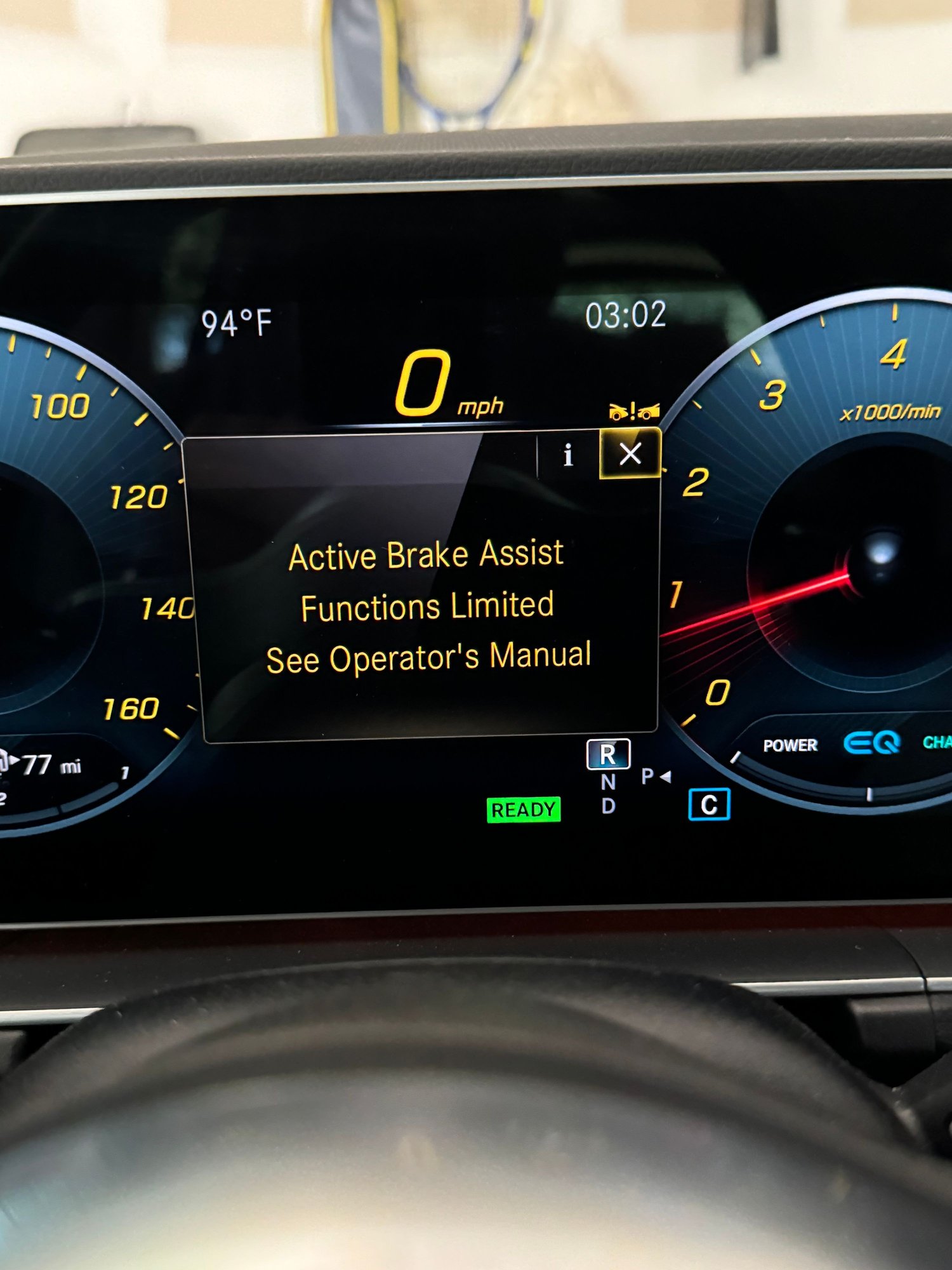

Old Oct 3, 2024 | 12:31 PM
hangten's Avatar
Joined: Jun 2019
Posts: 11
GL 450
error message
After replacing the grill, did you guys get this error message?
