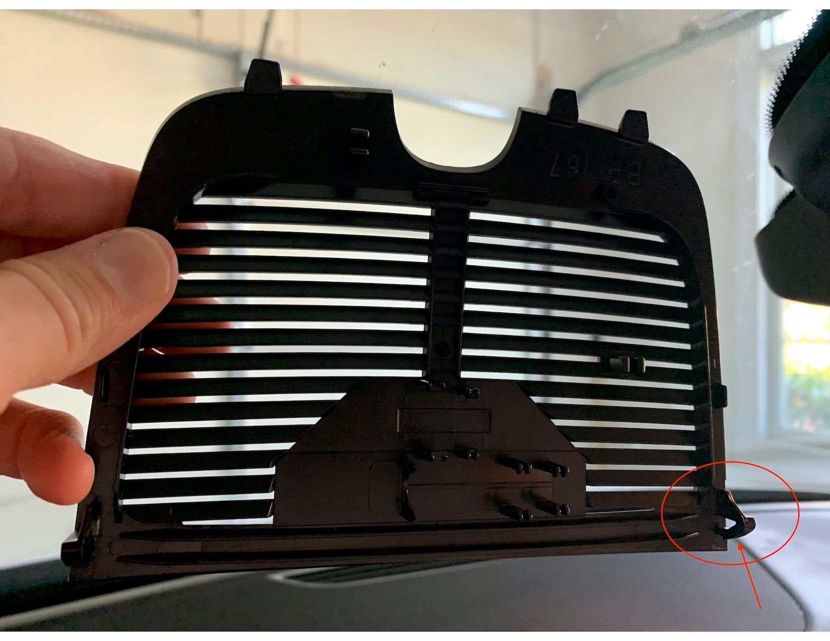

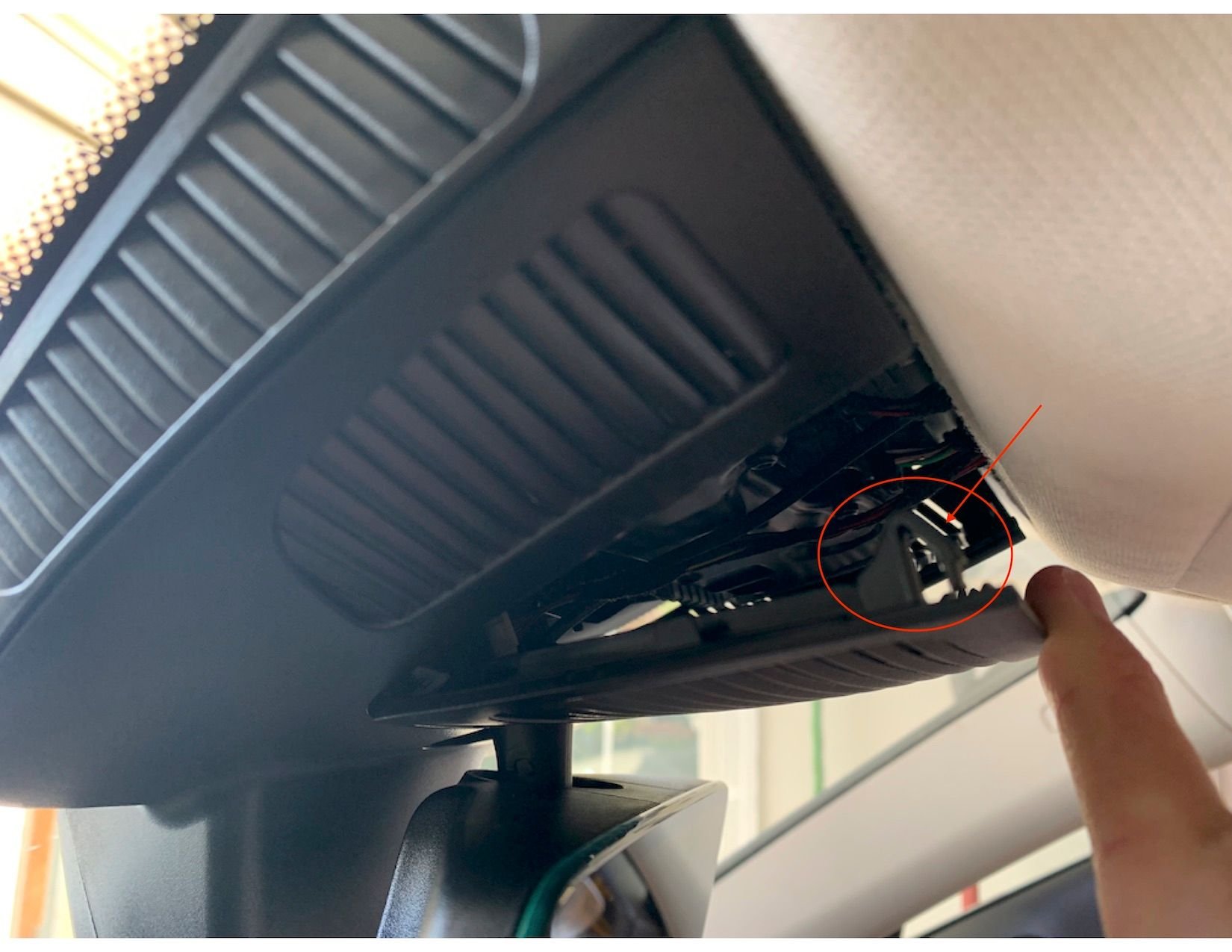

Only tricky bit was releasing the top catches on the middle panel (you noted these) - they would not release with a comfortable amount of pulling pressure.The back edge of the catch needs to be pushed in using the spludger (tool they provide) or a flathead screwdriver to release - see markup of a couple of your pics (hope that ok) to highlight these. Can also use angled needle pliers to squeeze the catch.
