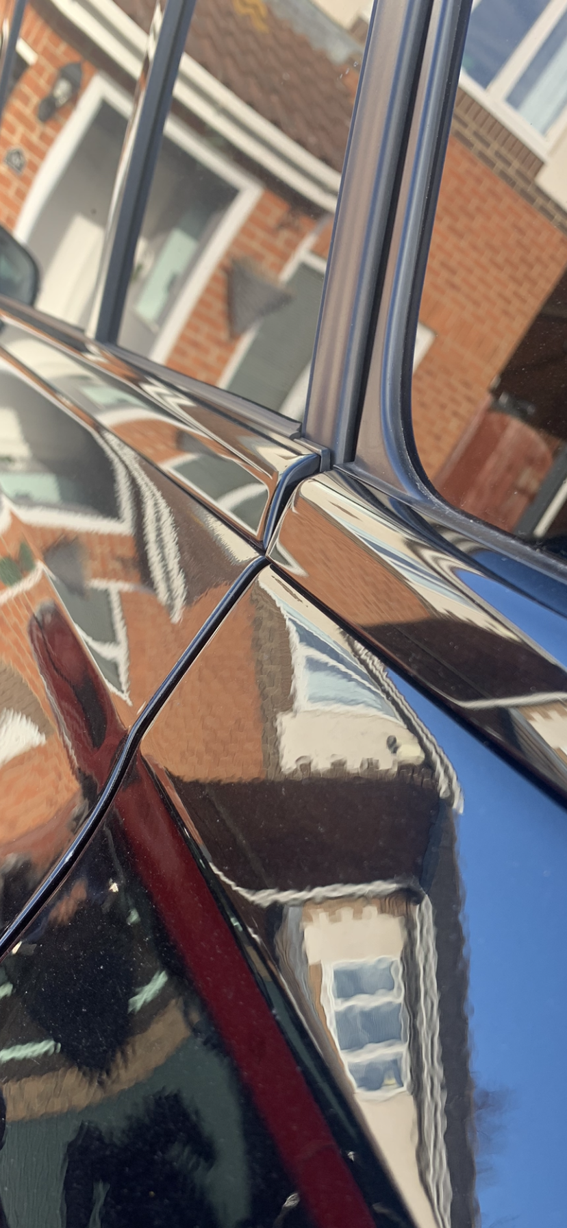

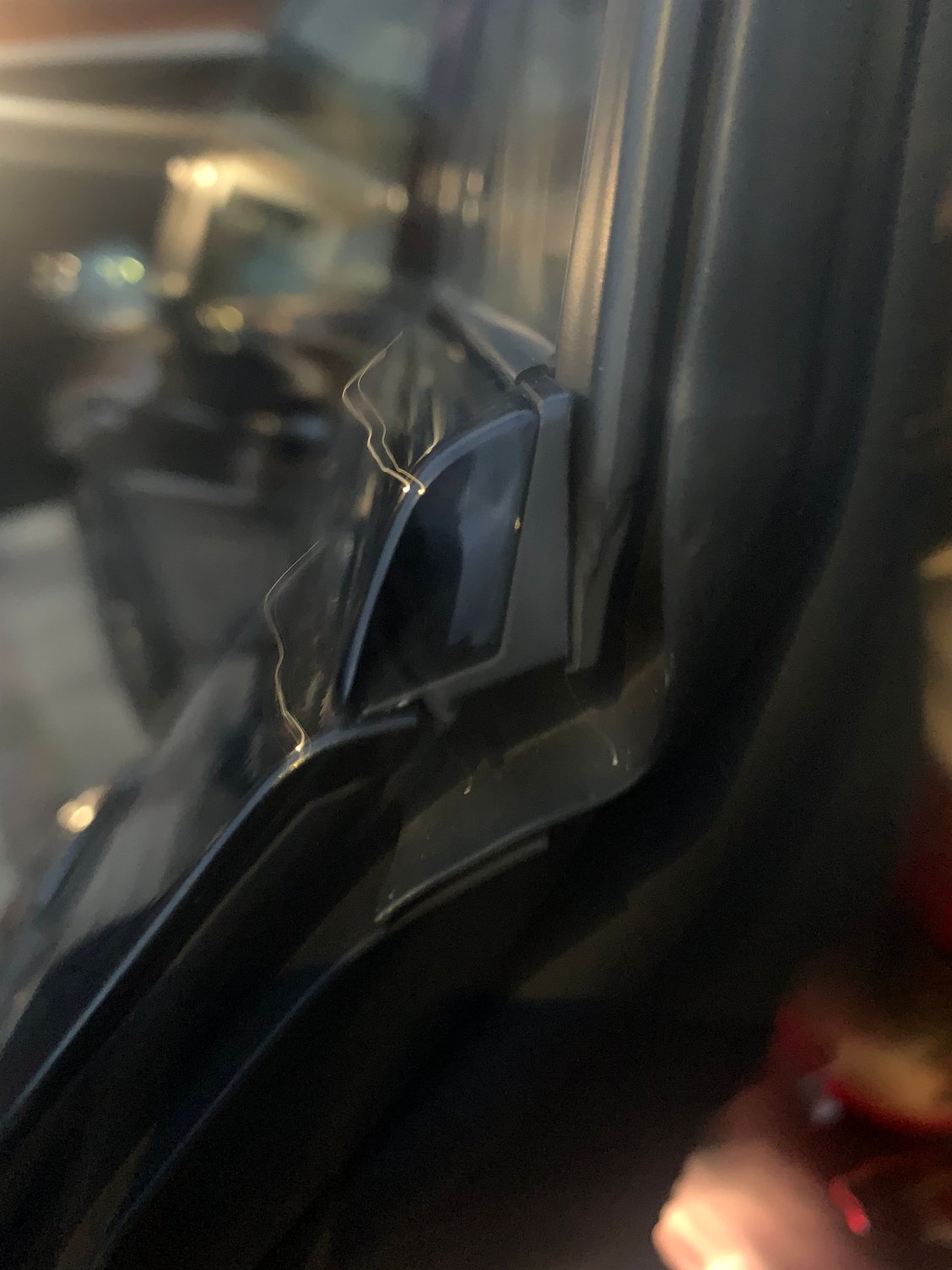

Hi guys
The back edge of the weather seals on the rear passenger doors dont line up well at all with the rear quarter ones, they’re high and the shape is just wrong, or the fit is all off, anyone else have this and had it corrected, vehicle is a late 2021 AMG GLS63.
Ive attached a couple of pictures, they dont show it that well, and too much reflection so apologies for that, it’s much more visible in real life, really poor panel fit up from Mercedes Benz.
Thanks
Carl

I have a misalignment issue on my drivers rear door but it is the metal on the door where the vertical edge meets the curve for the wheel opening. Unfortunately mine requires reshaping the metal and thus paint etc. The dealership bodyshop has agreed to make the repairs under warranty, but I have been dragging my feet since I have had so many mixed bodyshop experiences that I am dreading the process and results. I cannot imagine they would not be able to resolve this without bodywork and should be willing to do so under warranty. To me it looks like those trim pieces are possibly defected or installed improperly and just need to be replaced or reinstalled.

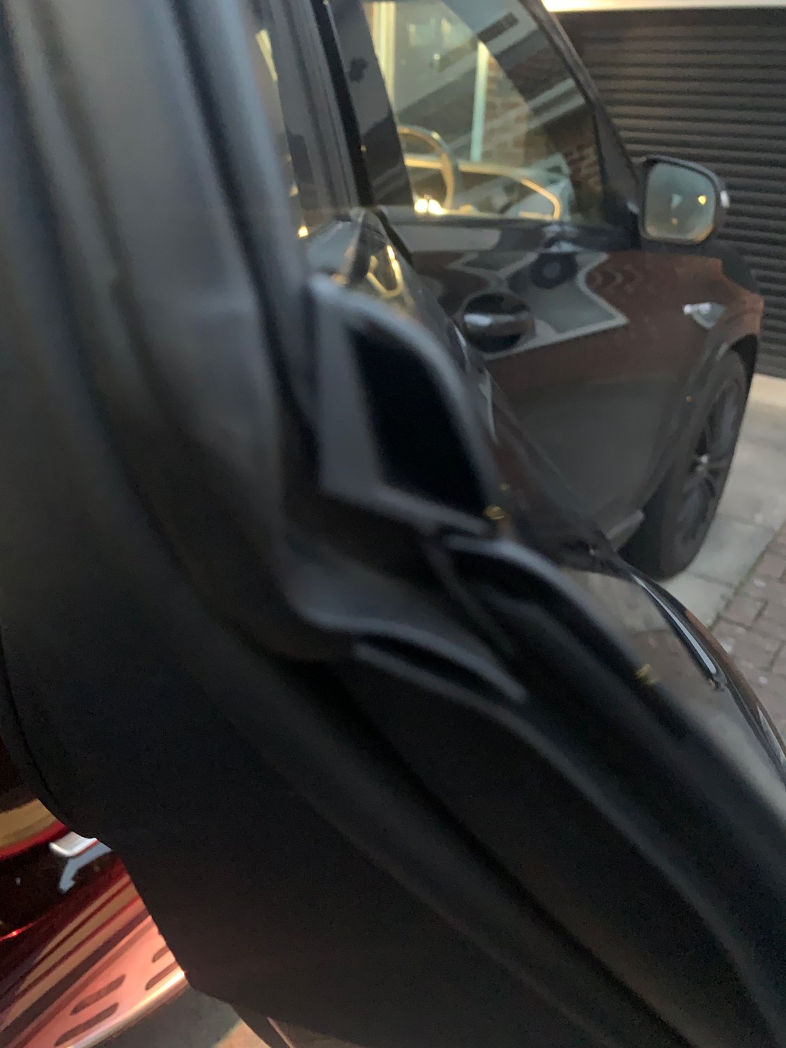

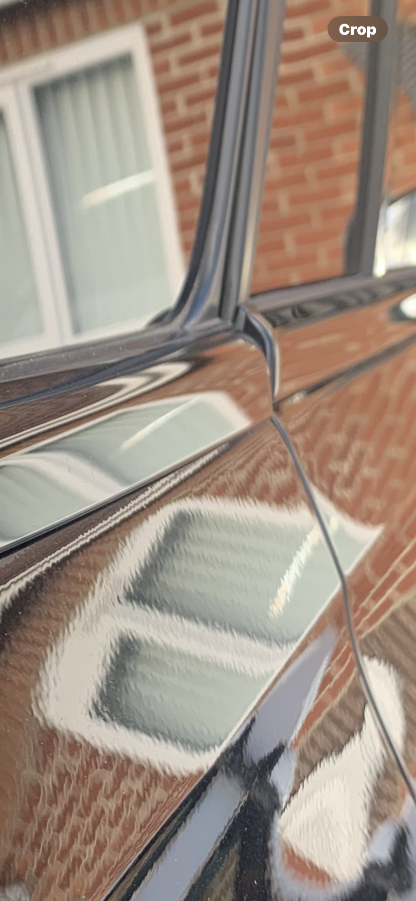

Could one of you guys be able to take a photo on the edge of the door looking into that weather strip so I can see how it’s meant to look when the strips look when they line up properly please, these are mine.
The first pic, left had door is better than the other in terms of alignment but neither are what I’d call correctly flush, like I’ve seen on the dealer forecourts.
A comparison with trims that are right would be really helpful

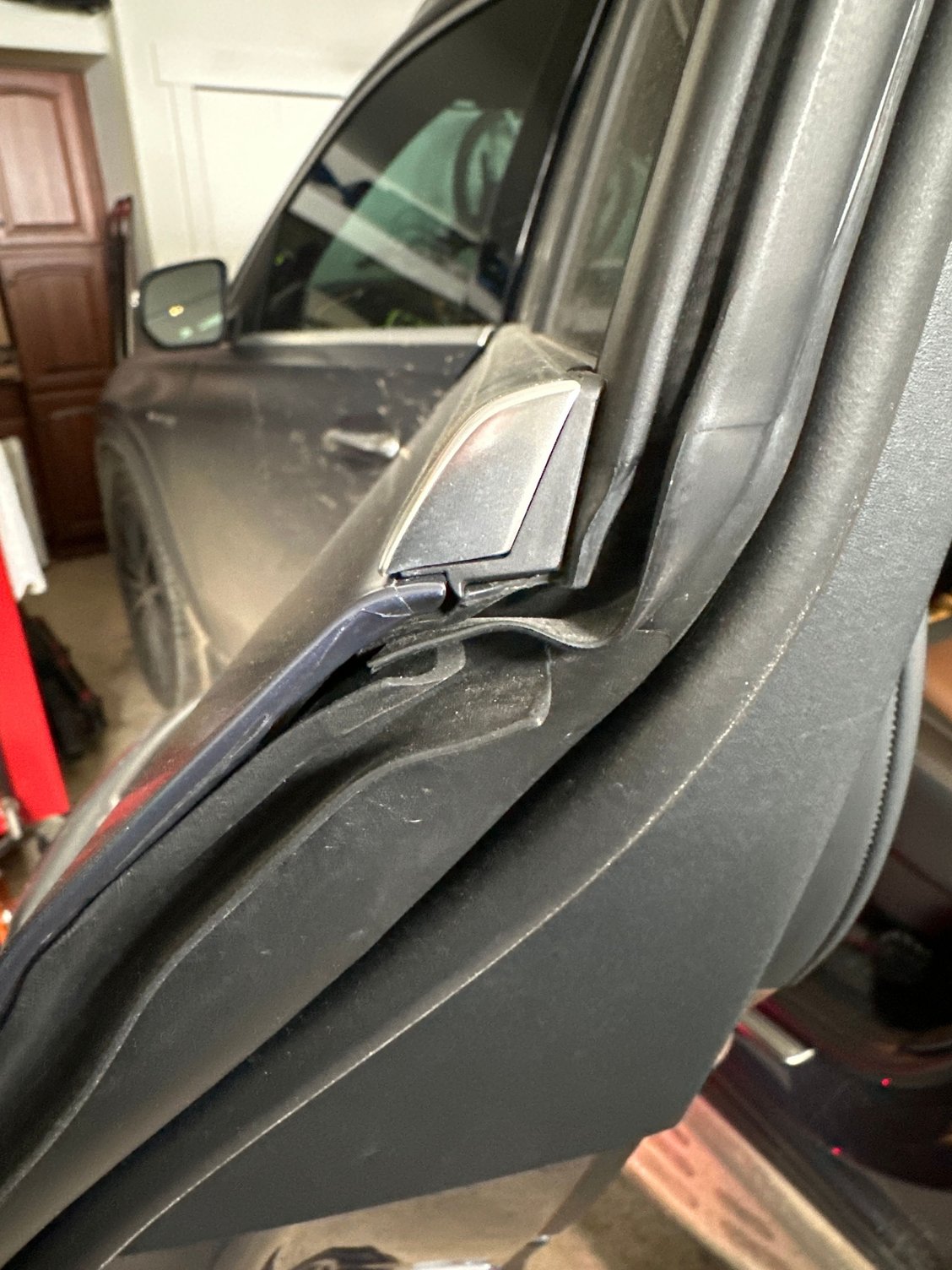

Here
Left passenger door. Cannot access my right in garage. But they are similar on how they are grounded/attached.

Do you have the ability to measure paint depth? Electronically? With this issue and the instability your feeling along with tire mismatch (I know of two London MB dealerships that I dropped into last time there two weeks ago that can get the appropriate tires)…I’m now thinking something could be off with that vehicle (damage) and was not reported.
Each part should have part numbers along with production dating. If you ever pull them off and they are newer than the make of the car…or if the rear quarter are newer…then something is not true to the car.
Hard to tell…but in one photo I see a pretty large amount of orange peel that is typically indicative of a repain or clear respray.

Thanks for the picture, I can see the rubber seal seems to tuck up differently underneath the trim strip but I doubt that would affect the angle of the strip itself, yours seems to sit parallel with the vertical trim whereas mine seems to tuck in too tight then sit off at the top, the angles different, that’s what I’m seeing on the vehicle with the doors closed. I wish I knew how to remove them safely.
