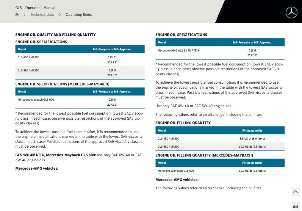

Attached are two screen snippets from the manuals. One for the 2020, and one for your 2024. You're right, they have changed the oil specs over the years. Note on the 2024, they still recommend the 229.5 for the V8's, but want the ultra thin for the i6. I'm with you, I think 0W-20 is too thin in the Texas heat. I'd go with the 0W-30 myself. I've got 229.52 in 5W-30 ESP Mobile 1 in ours for the last 5k miles.
Also interesting is the quantity difference (slight). 8.9q for the 2020 vs 8.5q for the 2024. I'd be curious what the difference is between the two engines to warrant the change?
In the attachments, the one that show the oil drop icon, is from the 2020 manual. The one with the blue shaded segments is the 2024.
