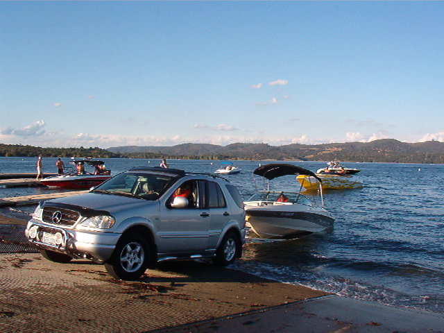

Low gears are excellent when towing, especially what I do every weekend (see picture)...switch to low gear and the truck just crawls up the ramp on its own dragging the boat up with it.
