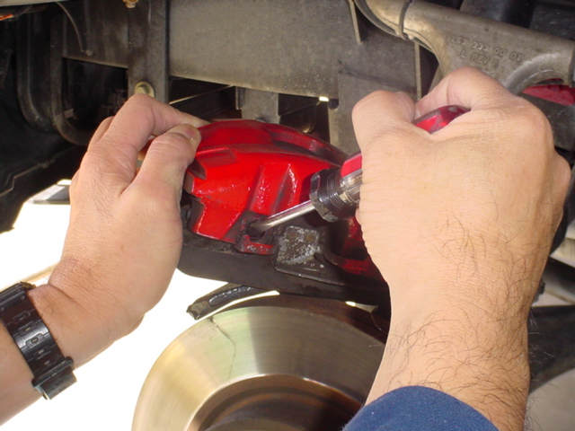

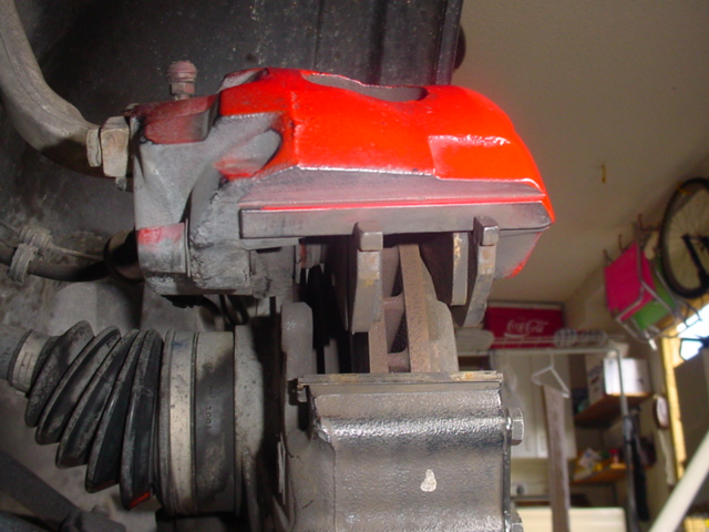

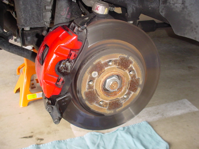

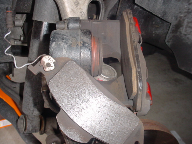

i know
but you need to pry out the pad first using the flat screw driver to ease out lifting the caliper, i check these pic out that you can follow.
Attached Thumbnails HELP - Can't Remove Rear Calipers on ML320-dsc02064.jpg   HELP - Can't Remove Rear Calipers on ML320-dsc02065.jpg   HELP - Can't Remove Rear Calipers on ML320-dsc02066.jpg   HELP - Can't Remove Rear Calipers on ML320-dsc02067.jpg   HELP - Can't Remove Rear Calipers on ML320-dsc02068.jpg
