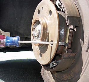

The rear pads of the 430 are very easy to replace. The rotor isn't. The problem is that you have to back off the emergency brake pads. To get to them, you have to stick a screwdriver into the bolt holes on the rotor and loosen the star gear the adjusts the drum brake shoes. I have a picture.
I have used Pagid mostly and they are fine, but dirty. I think dirty is good though, soft pads wear fast but brake well.
I have drilled rotors up front, but wouldn't bother back aft. You don't really need them in either place, but I figure Benz puts them on the high end models, so how bad can it be?
I took this picture with the rotor removed so you can see what you have to do inside the rotor, because you can't see any of this when the rotor is in place.
