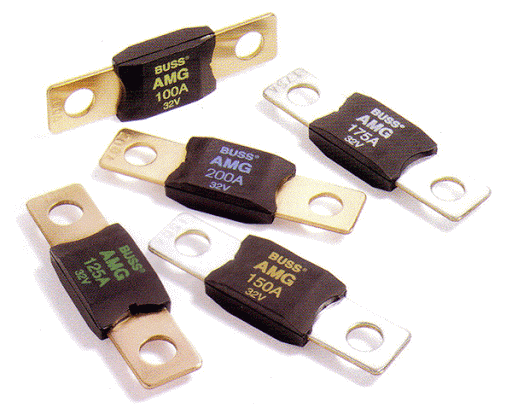

You have to change or weld the fuse at the battery connector thet attempt to go bad a lot and it also turns on the coolant light on

Did you ever fix your issue? I seem to be having a similar issue. Intermittent coolant light while the level is fine, ac clutch kicking on and off, temp raising above 80 but not over 100,and the fan isn't kicking on it seems. The ac is what lead me to the issue and without the fan running the high pressure side of the Ac system keeps kicking the ac on and off.
Old Jun 24, 2021 | 04:33 PM
c32jet's Avatar
Joined: Dec 2006
Posts: 118
From: Los Angeles, CA
Yes, the fix for me was to buy a cheap / large high amp fuse and broke it in half to use the copper. I put the pieces in under the fuse - basically reinforcing it - and have had no issues since. Must have been a contact issue. May be able to achieve the same result by giving it a good cleaning...
Hope this is helpful. I also disconnected and reconnected the various electric connections a number of times trying to diagnose... could have been that as well.
