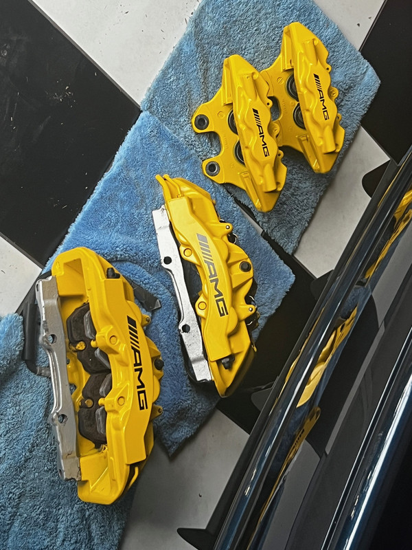

Here is a picture of what I got any help would mean the world.
