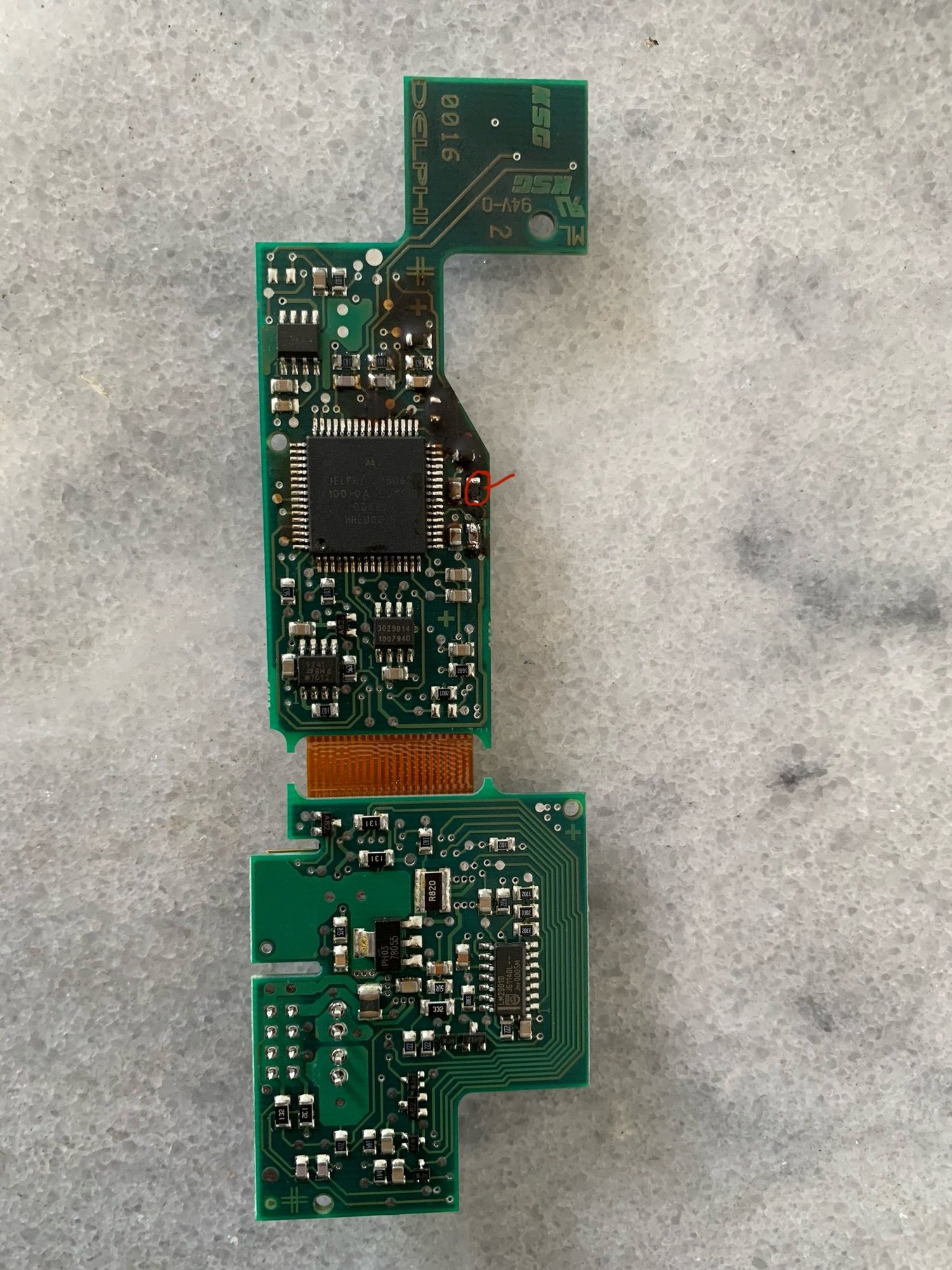

I disassemble the circuit board and try to clean and check every components. Then I am thinking of clearing the codes by removing -ve terminal of the battery. I will update you the final result.

Wow, Looks really nice, It may survive. Clearing codes with neg. battery cable removed, MAY clear some codes. BE SURE that cable is off the battery and key not in the ignation while you are hooking it back up. Fingers crossed for your good outcome with that board and system. If after putting all that back together you {could} still have codes. If at that point you do still codes try to find a local shop, not dealer service that has the Star Scan that will save a bunch in diagnostic costs.
Good Luck,, keep us posted.

An indie shop here will charge about US $100-$150 for a scan while a dealer with the Star diagnostics will charge double that. Even after a scan the issue remains that the electronics on your shift module are dead and likely you will need a new module. You could pickup a code reader that will scan for faults for less than and indie shop and put the money saved toward a new shift module.
You did a great job of cleaning it up. Hard to tell from the pics but do you see any discoloration /cracking at any of the solder points?

hello,
there is positive hope today. I got to electrician to solder some resistors on the circuit board and changed a 563 resistor (indicated in red circle) with a new one and I assembled. Then the problem “stuck in P” is resolved. (This is good progress). But the problems of shift change to speed up is not solved. Reverse shift lamp isn’t working. Shift display on the dashboard is not showing.
So I planned to check and change other resistors. If you have any suggestions, please let me know.

There appears to be an area of discoloration that involves that resistor. Perhaps have your electronics guy check the circuitry along the entire length of the discoloration. Good luck, it sounds like you are making progress.
I recently had to pull the PCM on my 95 ford f150. 3 bad capicators. In that processs I learned there is used whats called { silicone conformal coating spray}. that coats the entire circuit board to prevent moistuer from corroding and shorting all the little circuit points. My PCM is slid into the firewall from the engine side and even though not completely exposed to the elements it did get moisture and condensate residue build up on the capicators and connections. Talk with you guy that did the repairs and see what he says about using that after ya'll are fairly sure that the ele. work is complete.

Yes! The issue solved and it works successfully. After changing the damaged resistor, clearing some codes by removing -ve terminal of the battery and using a diagnosing scanner removing stored fault codes.
In conclusion of this kind of problem, I suggest the following to other members to be helpful:
1. If your module is affected by water intrusion, it is better take a photo of the module at the beginning. This helps you to identify the affected electrical component.
2. Clean the module and Try to replace the affected element.
3. Clearing some codes by removing -ve terminal is partial solution. So I also recommend going to code scanner.
4. If you have time, I recommend to check the components of the module by electricians , rather than buying the whole shifter.
