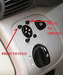

can the FOLDING MIRRORS function be included also in programming memory together with seats and steering memory settings?
I have a folding mirror but I have to manually press the button to fold it?

I checked on the settings on the steering wheel, and noted there is only one option that is:
“MIRROR SETTING WHEN PARKING” –the
passenger side exterior mirror can be adjusted and
programmed to assist the driver during parking
maneuvers"
I guess such function does not exist on my specific model?
There is small button though to press inorder for the mirrors to fold/unfold.
I was wondering If there is a hidden menu (one of those secret functions)
not written in the Manual that such could be incoprated in the memory settings?

Folding can be added to any car and so can parking assist. It is 10% parts and 90% software activation.
