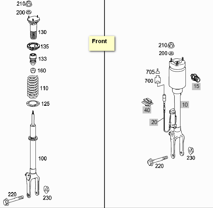

Been hunting for a conversion kit inorder to move from Air to steel springs, and notice that there are no versions made avail for W164 ML500 equipped with ADC.
My question hence is, are there any physical difference between the physical mounting of the ADC and Non ADC equipped suspension.
Wouldn't the standard replacement parts of a non ADC ML500 fit into an ADC car.
Understood that the system would throw fault codes and such, but i am trying to convert my car as such for more reliability in my part of the world (Brunei).
With my Arnotts replacement only lasting 2 years before leaking profusely, I really need to get something more reliable.
I would have thought itd be possible to change over, albeit needing additional upper mounts for the front, or even the whole strut assy out of a non ADC optioned ML500.
Ps Im not concerned about devalueing the car by doing this. Air suspension is considered a handicap in my country, due to its inability to last in any application by other manufacturers.

Yes you do the change over as long as you can get the complete units from a junk yard W164 chassis. No other parts are necessary.
Then you decide if you want to leave the pump and hoses, etc. installed or not.

Top Man Maj,
That illustration helps me take note of the stuff needed.
I am much obliged indeed for your advise.

For the fronts, I would need items 130,135, 133 and 125 inorder to attach conventional spring and strut replacement associated with this car, and for the rears 140, 145, 125 and 120 to be able to locate rear springs.
If i was to go will OEM brand new Bilstein struts with H&R, and remove all the Air suspension, these item I see as per the diagram would need to be purchased also to allow fitment.

You can do whatever you want, but if you buy a complete used unit, you won't need any parts.
Forget about the Bilsteins because you would have to dismantle the entire strut and it requires a special tool to compress those springs.
