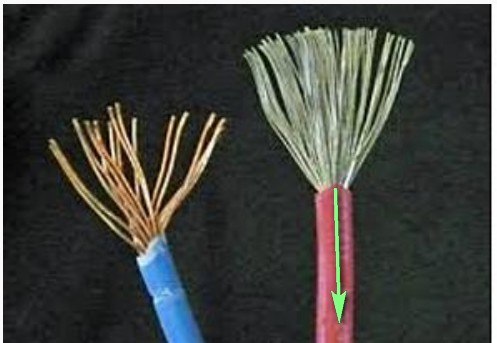

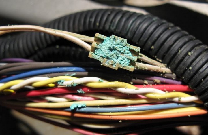

Are you saying that one wire broke or the two wire connector to the pump was disconnected?
I cannot believe that a water leak would cause either one, unless the wire was corroded.
If any of the wires or connector looked like the below, then you have a connectivity problem.
Please take photos of your wire repair and make it so that I can identify with them.
Attached Thumbnails 2007 ml350 liftgate-wire-corrosion-1.jpg   2007 ml350 liftgate-wire-corrosion-2.jpg   2007 ml350 liftgate-wire-corrosion-3.jpg

When corrosion occurs at a wire or connector cleaning the tip of the wire will not stop the corrosion, It will continue to travel up the wire to its heart content and little or no connectivity will occur.
