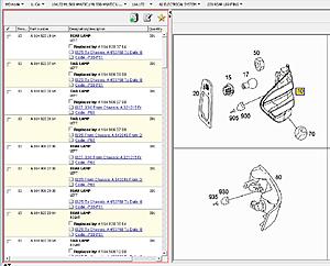

Attached Thumbnails Please Help with 2009 ML550 LED Tail Lights-2017-09-13_094829.jpg   Please Help with 2009 ML550 LED Tail Lights-aaaaaaaaab.jpg

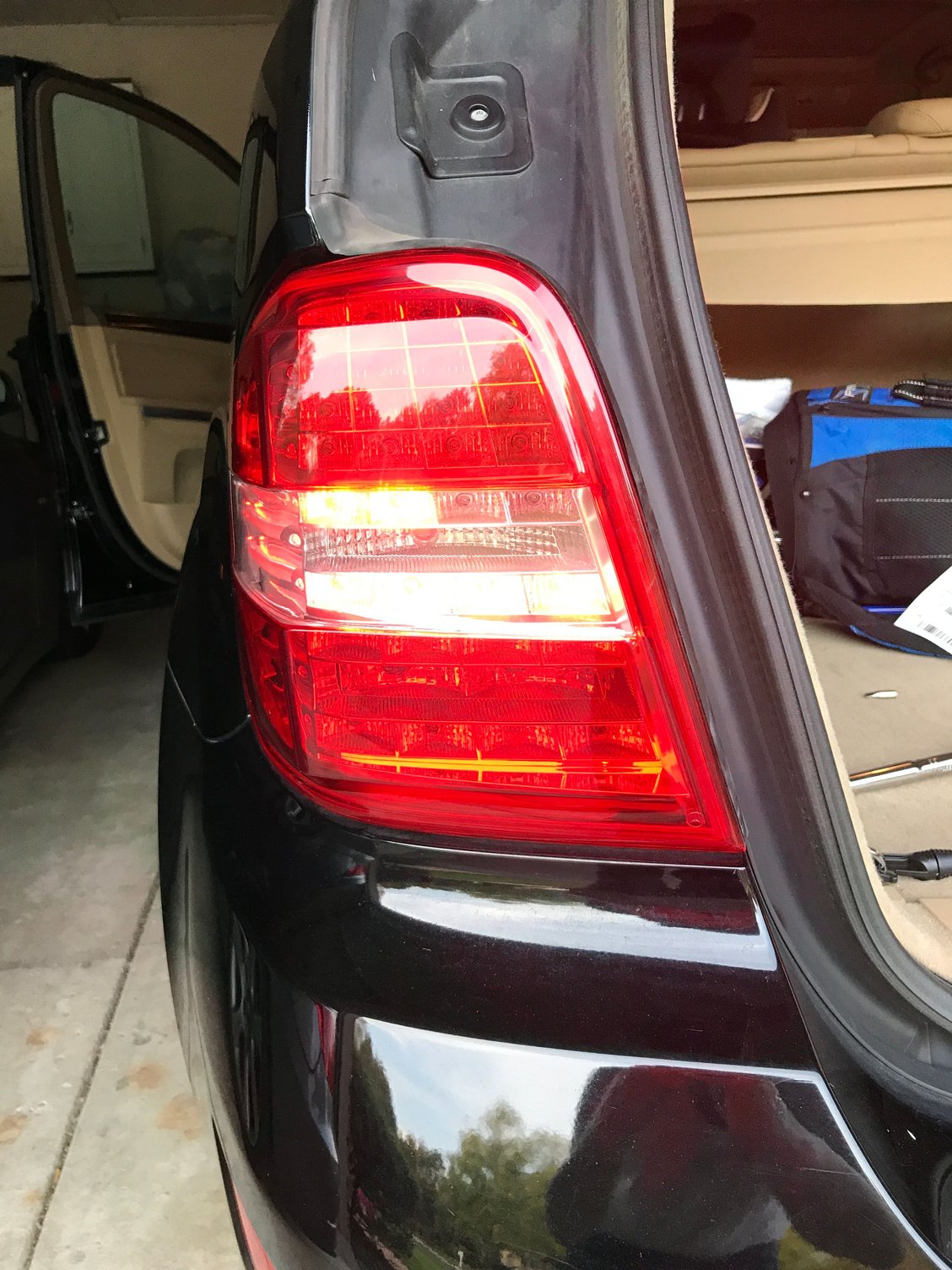

yes, LED tail lights. See the attached picture. Here is the light. Notice the white center lights. There are 8 LEDs and only 6 of them work. On my original one it's a different set that don't work. I should add that ALL Other lights in all 3 tail lights I have tried work fine. The only issue is with the White Turn Signals. And of course the computer throws an error.

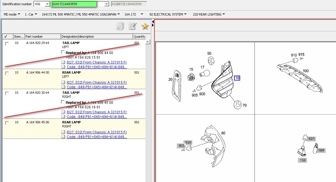

Originally Posted by grubster
According to your vin # these are the tail lamps.
Here is the info on your DATA CARD.

Grubster, I am not suggesting anything. The part numbers I supplied should be compared to the part numbers you ordered/have.
As a matter of fact, what are the part numbers stamped or labeled on your original ones?
