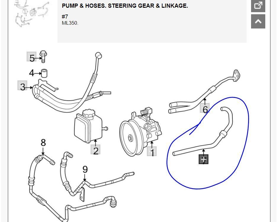

Hello,
Can anyone confirm that the hose circled in the picture, if disconnected at the cooler/radiator side will leak coolant if removed? i didnt think PS return hose connecting the reservoir side to the radiator had coolant passing through.
Thanks for any insight if anyone replaced that hose.

That hose carries P/S fluid from the pump to the radiator, not coolant.

That hose is definitely part of the steering system and will only leak P/S fluid not coolant as mentioned above.
Part of the radiator is used as a power steering cooler. It is separated from the coolant side completely -- the radiator hoses carry coolant to and from the radiator. Think of the radiator as two separate units built into one (radiator - coolant AND power steering cooler - P/S fluid)
If you remove that hose, most or all of your P/S fluid will leak out of the system. It is at the very bottom point of the system, so it will drain the reservoir, rack, and cooler entirely.
Having said that, the P/S fluid capacity of the system is very small (between 1 and 2 liters if I remember correctly). So the best thing to do is order extra P/S fluid, drain the entire system when removing that hose, then fill up with brand new fluid. Along with replacing the hose, you have basically done a flush (ok just drain and refill, but not too far off) of the system. This fluid gets old and gunky over time, so new fluid is a great thing to have.
I am planning to drain/refill my system soon by removing the bottom clamp (#160 in the picture above).

ok thanks !! that's exactly what I was thinking and my plan!

so i replaced the reservoir and return hose and filled with green pentosin fluid...havent seen any leaks...guess its fixed! weird because didnt see anything wrong with either part??? who knows

Maj. Dundee, can you please post the part numbers for all hoses?

Will this diagram also apply to 2006 ML350 Base?

Here are the part numbers and a copy of your DATA Card.
