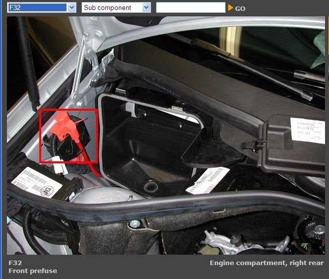

With the eng. running after 5 mins., check fuse #7 in the Eng. Compartment Pre-Fuse Box for 12v..
After undoing the top clips I still cant open the box. How does it come off?

Here are the directions.
Hi Major,
Is there a way to get the cover off without breaking the edges. The so called clips look so integrated into the body; it seems impossible to undo them. Thanks
