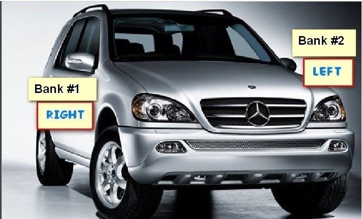

In this case, if the cam timing is over-retarded, the engine light will be illluminated and the code will be set. The "B" camshaft is either the exhaust, right, or rear camshaft. Bank 2 is the side of the engine that does not contain cylinder #1. This code is nearly identical to P0022.

Code P0025 refers to the left bank which is the left side sitting in any vehicle regardless if you have right or left hand drive.
