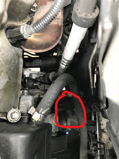

EDIT: Went out to take a look at the car. I can't really notice any large external leaks. There is a little oil residue on the left valve cover gasket (right side of the engine, facing you), and one of the lines connected to either the PS or some cooler seems to be weeping a bit. That said, there is not much there, it's not really blowing back on the chassis in large amounts, and it certainly doesn't account for 1 quart every 200 miles. What do you guys think? An alternative hypothesis, is there an oil level sensor that could be going bad?
Noticed some oil around the edges of this valve cover and some very light moisture on two spots on the exhaust manifold.
What are these lines and where do they go? The top line has some weeping that starts here.
And deposits here, but there is no pool of liquid on the garage floor.
Here is another angle. There seems to be a little blow-by on the subframe that likely happens when the vehicle is traveling at speed. Behind this point, there is no oil residue on the chassis.

Parts and locations are determined by by sitting in the car, hence you have a leak at the left valve cover.
The valve cover gaskets get tired after 13 yrs.
I have no idea what that hose/cable is. Remove the under eng. cover and see where it goes to.

All, an update. I put the truck up on rhino ramps and took a closer look at the oil leak. Still not sure what these lines go to. Also, it seems that the leak is coming from somewhere else and potentially dripping down on these lines and collecting at the bottom of the pan. Would anyone agree with that?
One of the lines goes into this, and the other goes towards the back of the engine but is almost hidden by the body/header. Again, not really sure if they're the source of the leak or are just collecting oil that's leaking from something at a higher point on the front cover. I will look for a an engine diagram to see where everything is (power steering pump, alternator, etc).
I put two 300ml Liqui Moly Motor Oil Saver cans in the oil. I also ordered all of the parts to redo the left valve cover gasket and breather. Everything should be here this week. I did valve covers on my W208 CLK55, and anticipate that it should be pretty straightforward on the ML. I am interested to see if fixing all of the leaks will impact oil consumption. The valve cover is is leaking enough to actively burn off oil on the exhaust manifold; the other oil leak pools on the garage floor after a couple of days. Maybe it's losing enough oil to add up to a quart within 200-300 miles. Won't know until it's fixed!
