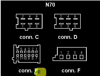

There are two fuses that power up the N70 Overhead Console, $41 & 42..
With the key on. check both contacts on each fuse for 12v.
What does fuse 13 in what fuse box have to do with this?

Originally Posted by DrDoe
On F13 I misread upper console as overhead console. Both F41 and F42 showed 13.8v and the fuses are good. Question: would overhead console get opened (disassembled) for sunroof maintenance?
Now you must remove the Over. Console and at conn. D, check RED wires 5 & 4 for 12v.
What do you mean by "sunroof maintenance"?

Both 4 and 5 wires are red so I got 0v across them. Between 3 and 4, 5 and 6, 4 and 6, I get 12v.
