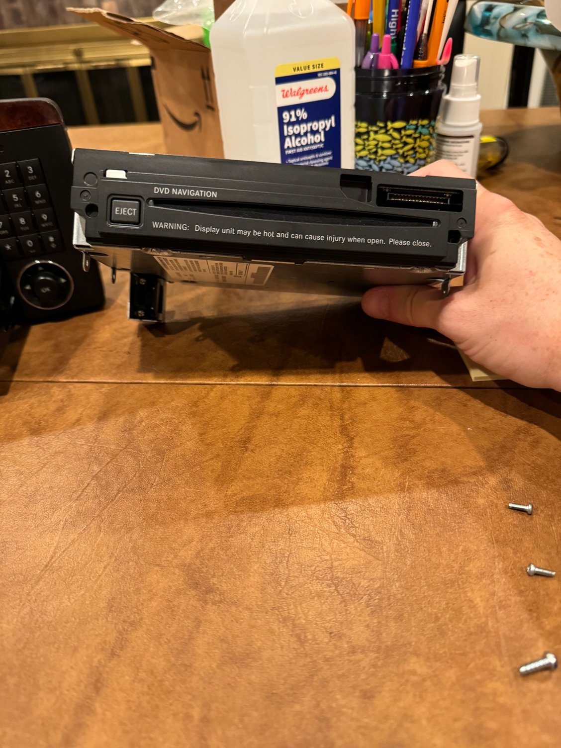

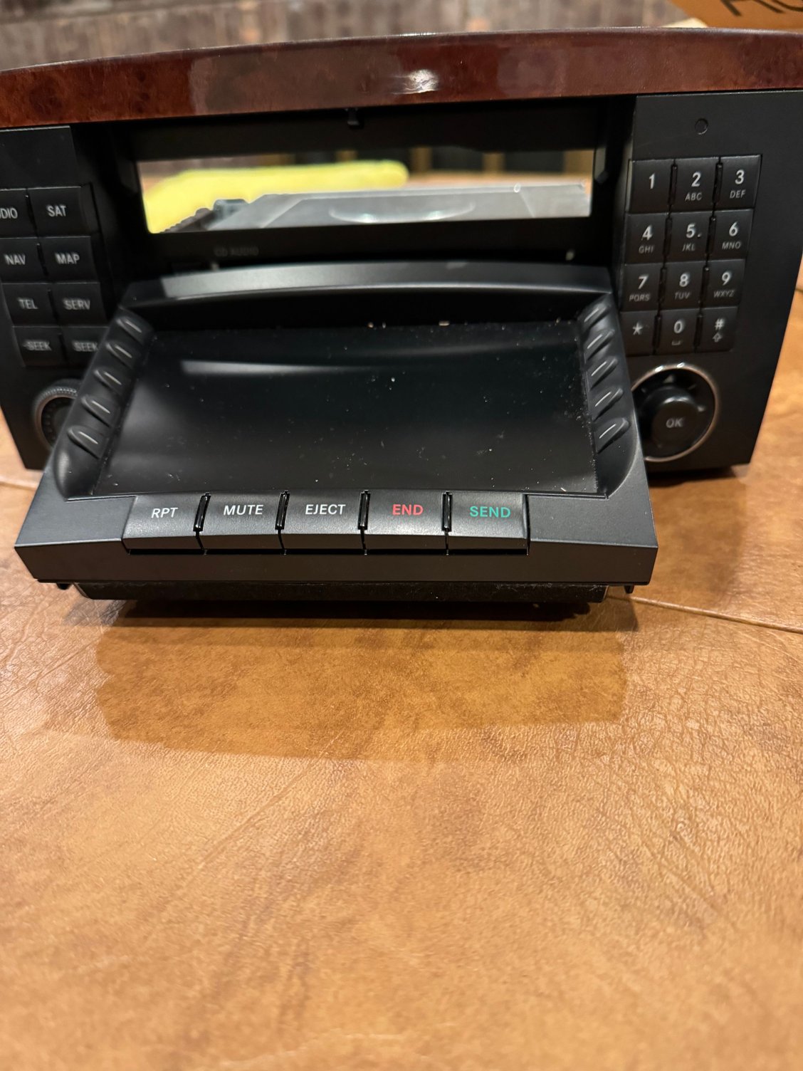

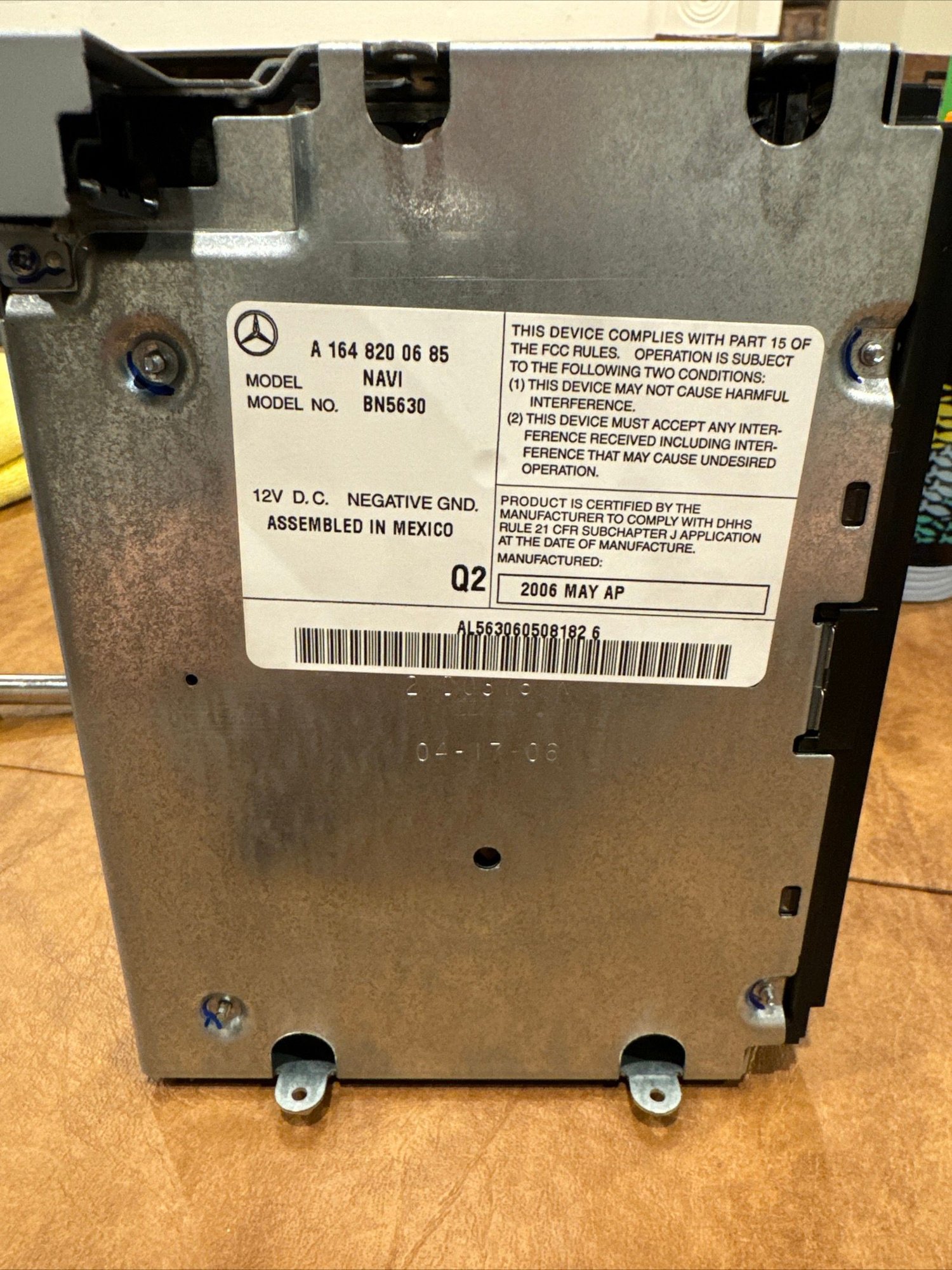

thank you to whoever started this thread! My 2006 R500 had the same issue! I pulled the command out, removed the dvd drive with a few screws and I’m back in business!
Here are a couple pics for those confused about “removing nav”. You are actually removing the dvd drive from the command. After removing the screws, it pulls out from the back.
