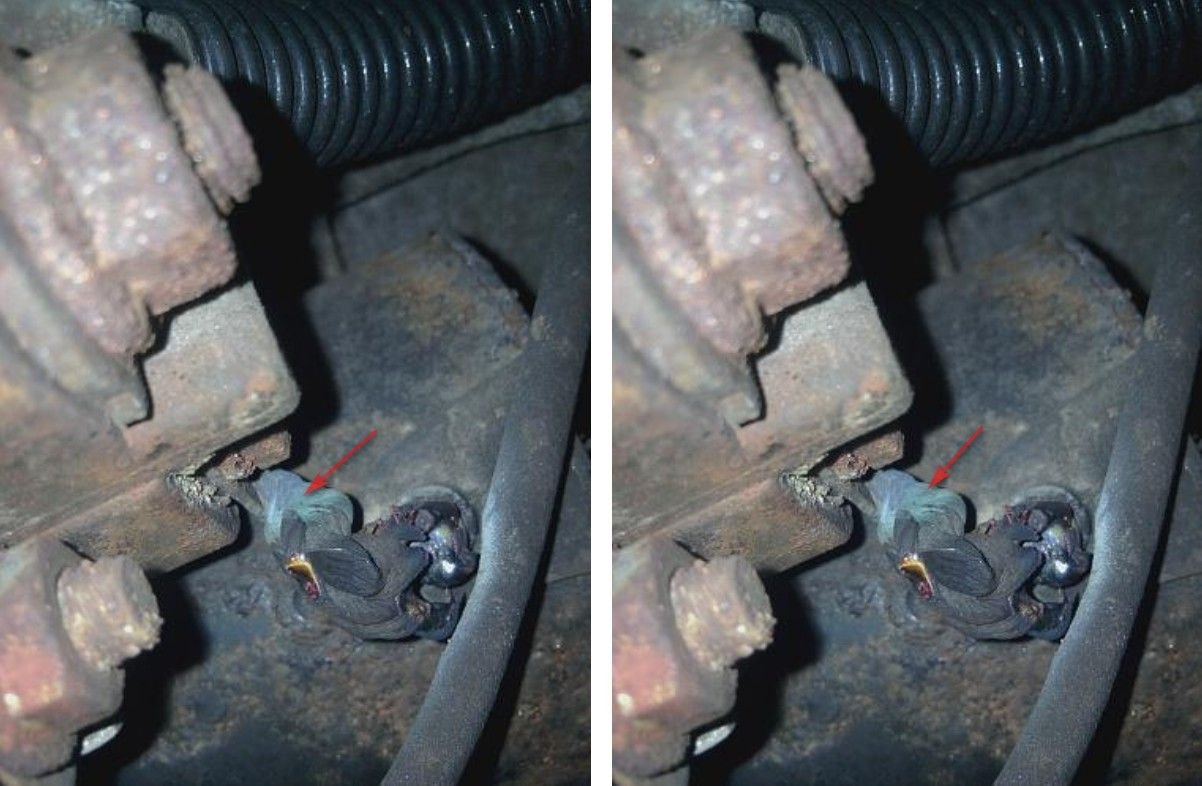

changed the starter - turned out I had somehow got one of the removed cables hooked up around the terminals which was restricting movement

pretty sure I took it forward (towards alternator). Then went upright a bit and taken down behind alternator. Been a few years. I remember i had given up because I couldn’t get it forward and couldn’t work out why. Have a mechanic mate come and he took it straight out ( turned out that one of the cables had fallen back over terminal bolts. ).
