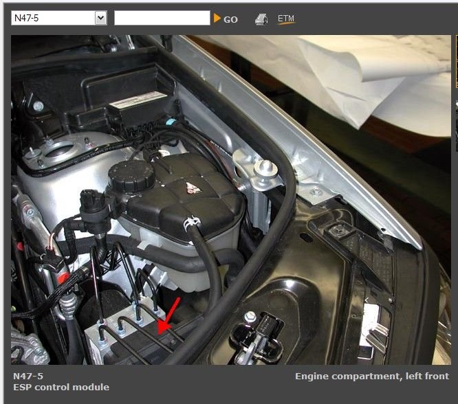

1.6001 The Supply Voltage Of The Control Unit Is Too Low(Undervoltage).

I had the same prob. a month ago. Installed a new battery and the problem was gone. If on a very cold day, your batt. is below 11v, you need a new batt.
Code 6001, which is an EVENT code, refers to cir.30 return flow pump N47-5.
