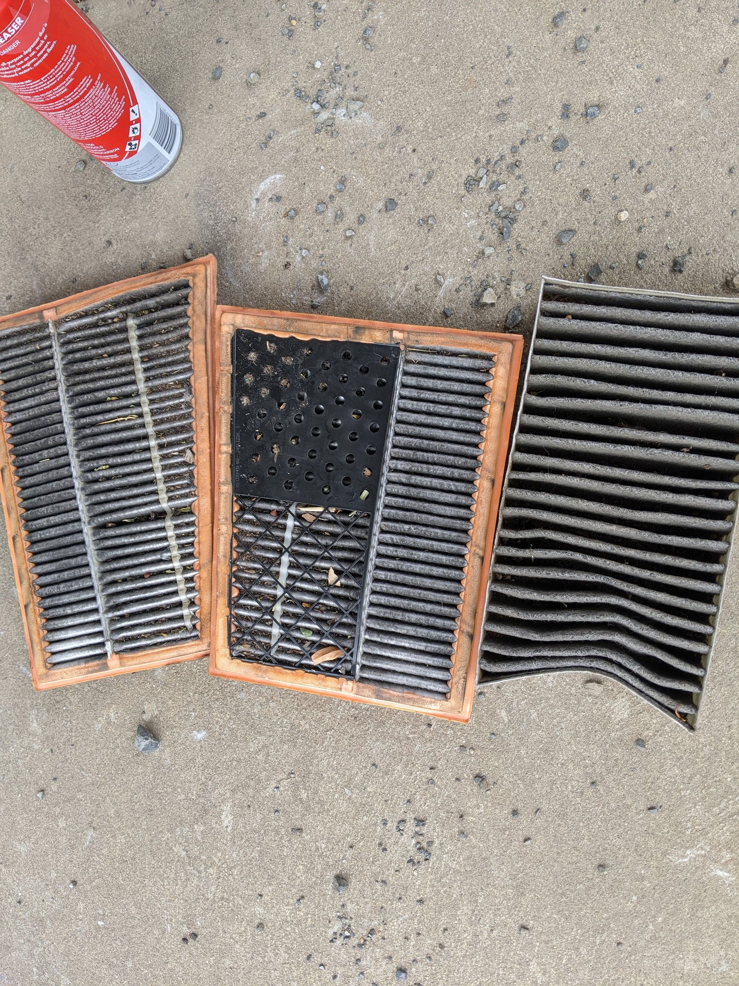

Air cleaner and cabin filter were chockers. Full of leaves, insects, and gumnuts.

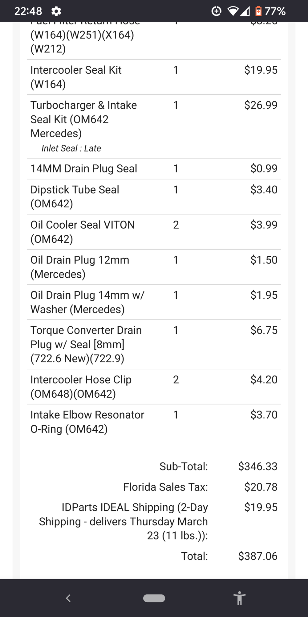

Update!! Items ordered from idparts
Here it comes. A big order from idparts about $650 (AUD). Current TLC spent on car about $2000 (AUD). I mentioned buying the ML320 at below market price but I do plan on showing it some TLC. I plan to keep it short term and sell after 5years. Once it has served its purpose.
$2000 total so far. All values below in AUD
$650 from idparts USA
$550 on fluids (engine, steer, diff, trans)
$300 on filters
$200 on tail light harness
$200 on workshop tools (fluid transfer pump)
$100 on miscellanous (sprays, grease, silicone sealants, rags, brake cleaner, degreaser)
No turning back

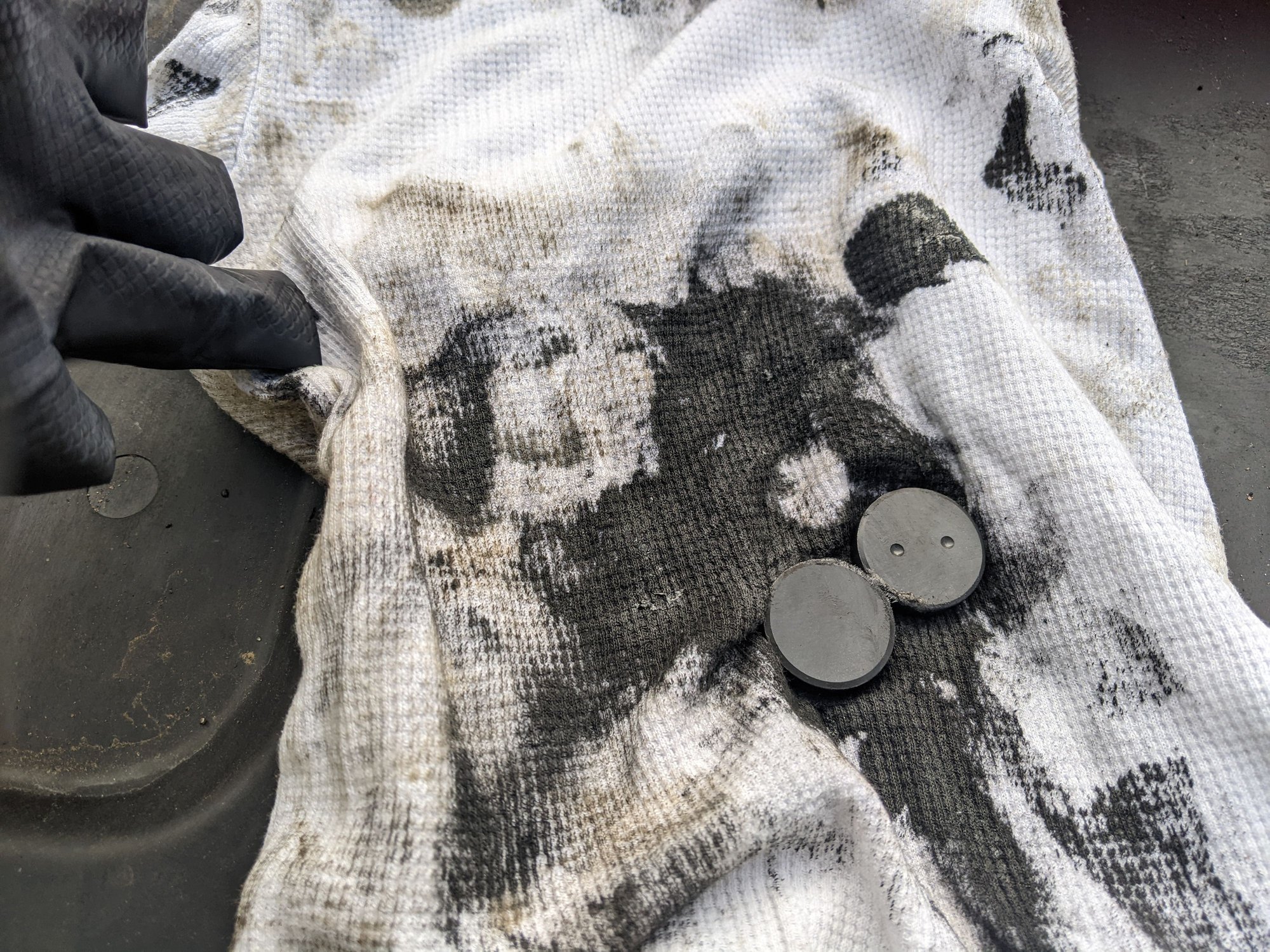

Done diff front, diff rear, and transfer case; oils. MB235.7 and MB236.14/15. Was wondering if there would be a haldex-like filter in the transfer case but couldnt find any filter housing. I would have done the trans oil if the filter plus gasket arrived. Something for next time.

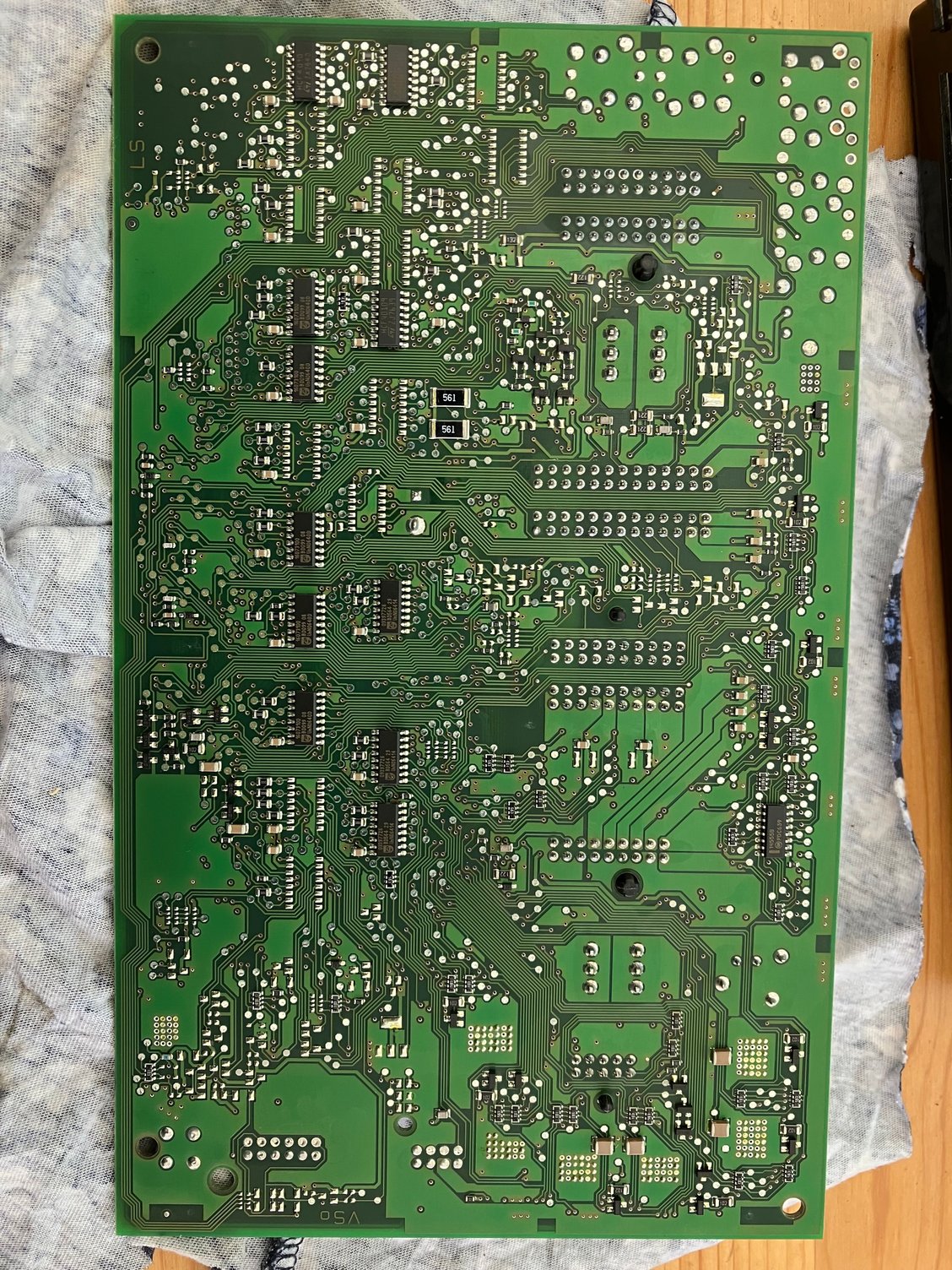

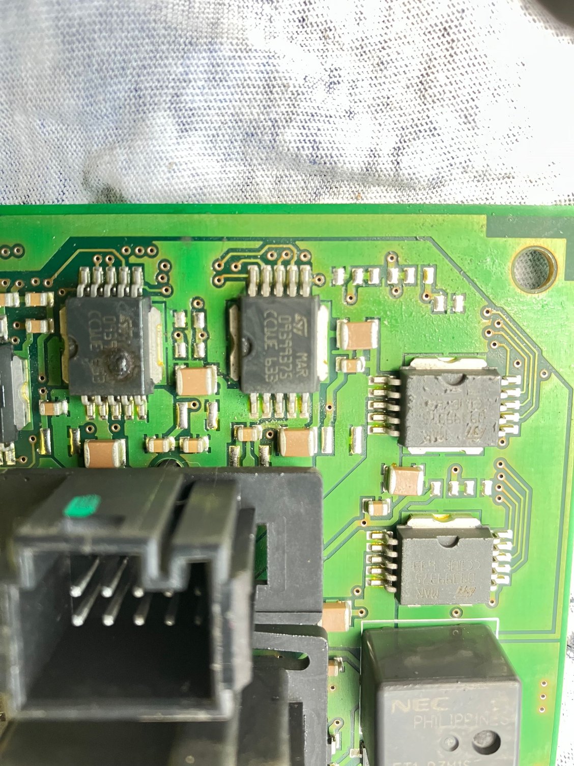

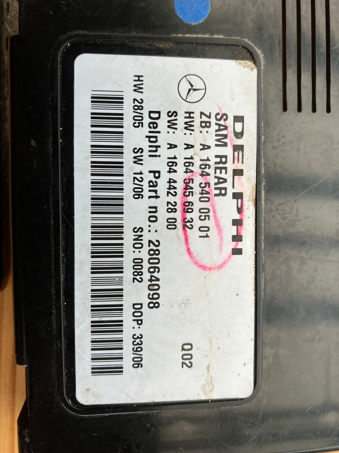

Planning to o inspect REAR SAM and see if water damage has set. Previously thought as tail light contact plate problem.

New API GL5 oil (MB 235.7) on the left and barely visible. Old oil on the right is burnt.

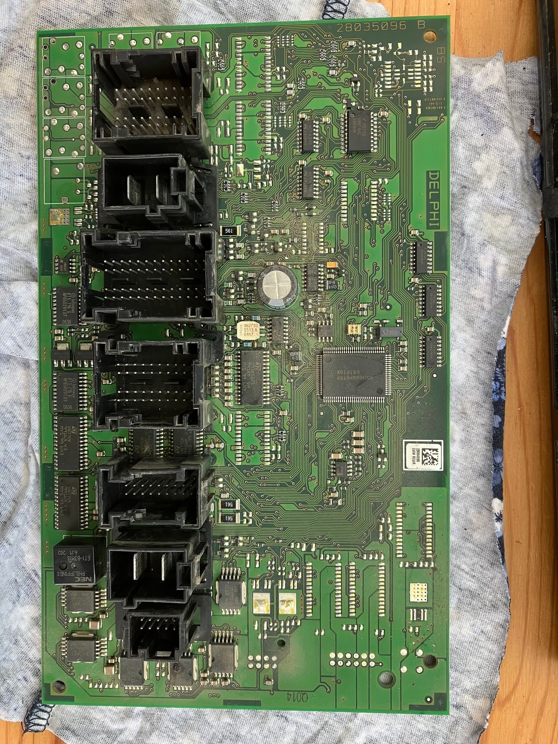

  1. Investigated my REAR SAM since brake lights didn’t work. Found out some transistors are fried. Originally thought as bad contact on plates. ECU refurbish costs $450 in Australia but brand new is at $1200.

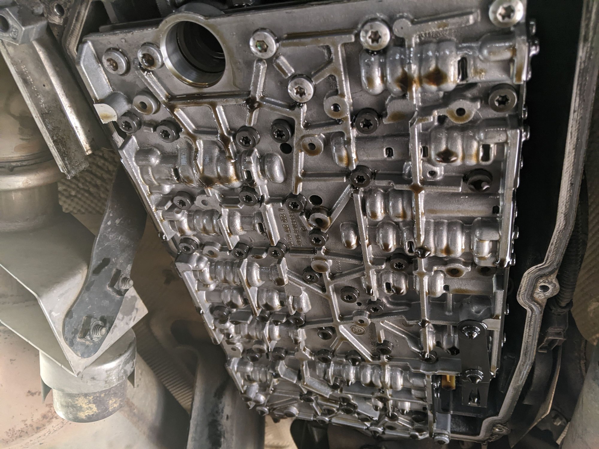

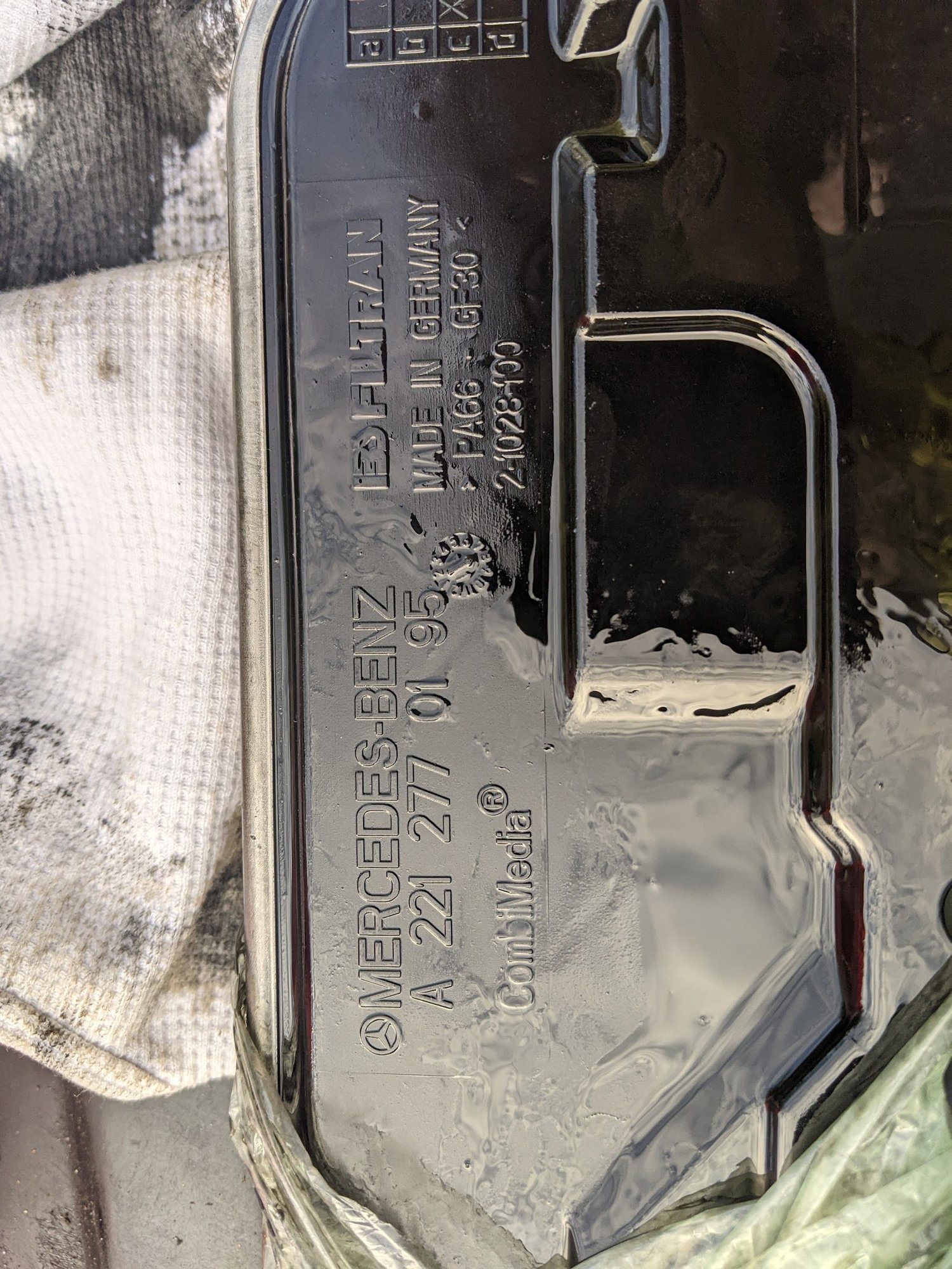

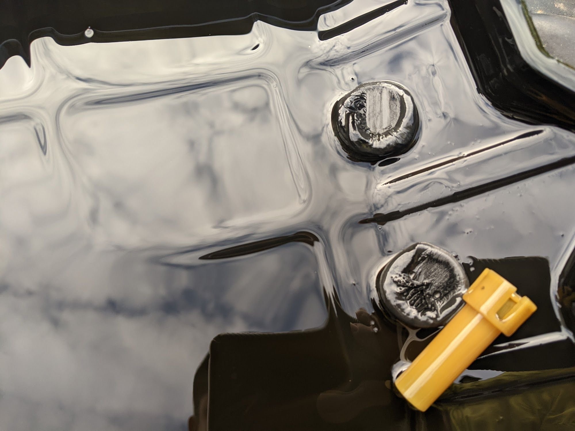

  2. Performed trans service oil and filter. Filled in 10L and allowed 500ml to drain

Will upload pics of trans service later
Trans service

Parts from idparts arrived and will now start changing parts.
New-style pcv pipe and turbo seal
Order arrived from USA idparts
