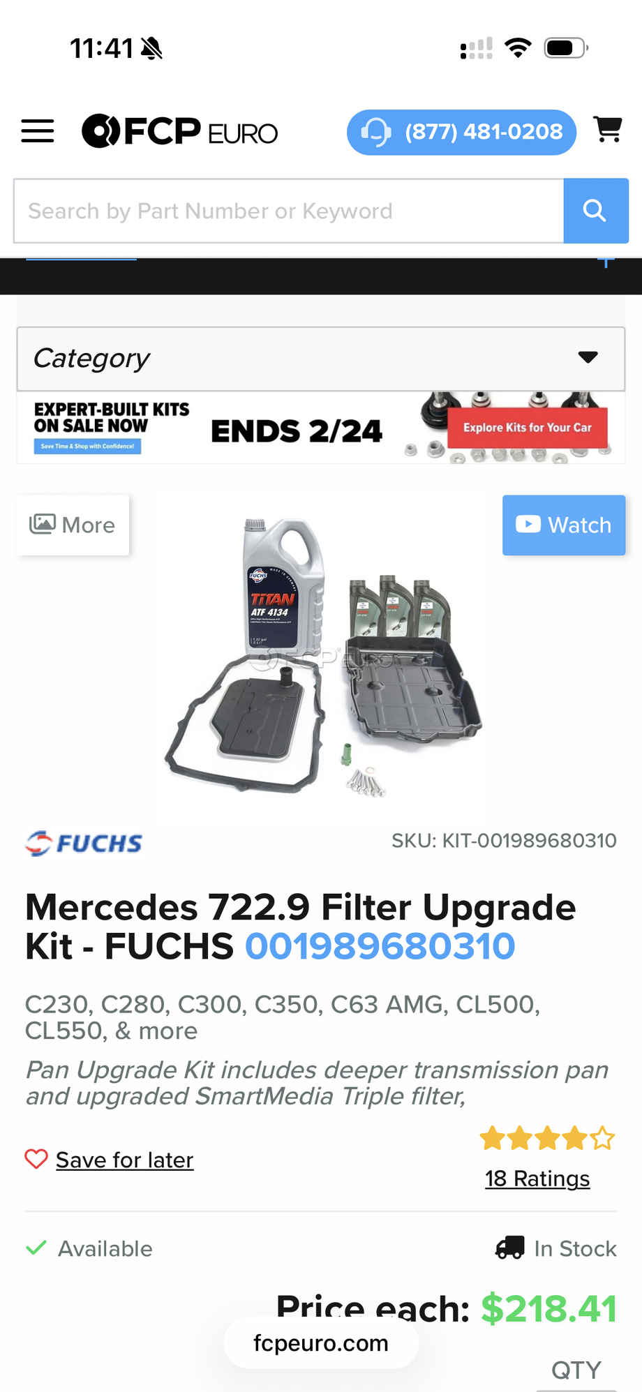

Fuchs Titan ATF 4134 was put back in. Is that the correct fluid? Maybe I misunderstood what the guy said at the transmission shop. The kit did come with the long tube filter.
This is the link to the kit I ordered.
https://www.fcpeuro.com/products/mercedes-722-9-transmission-pan-upgrade-kit-pentosin-001989680310

I misunderstood the transmission guy. Fuchs ATF 4134 was put in and is red.
This is the kit.
This is the kit.
