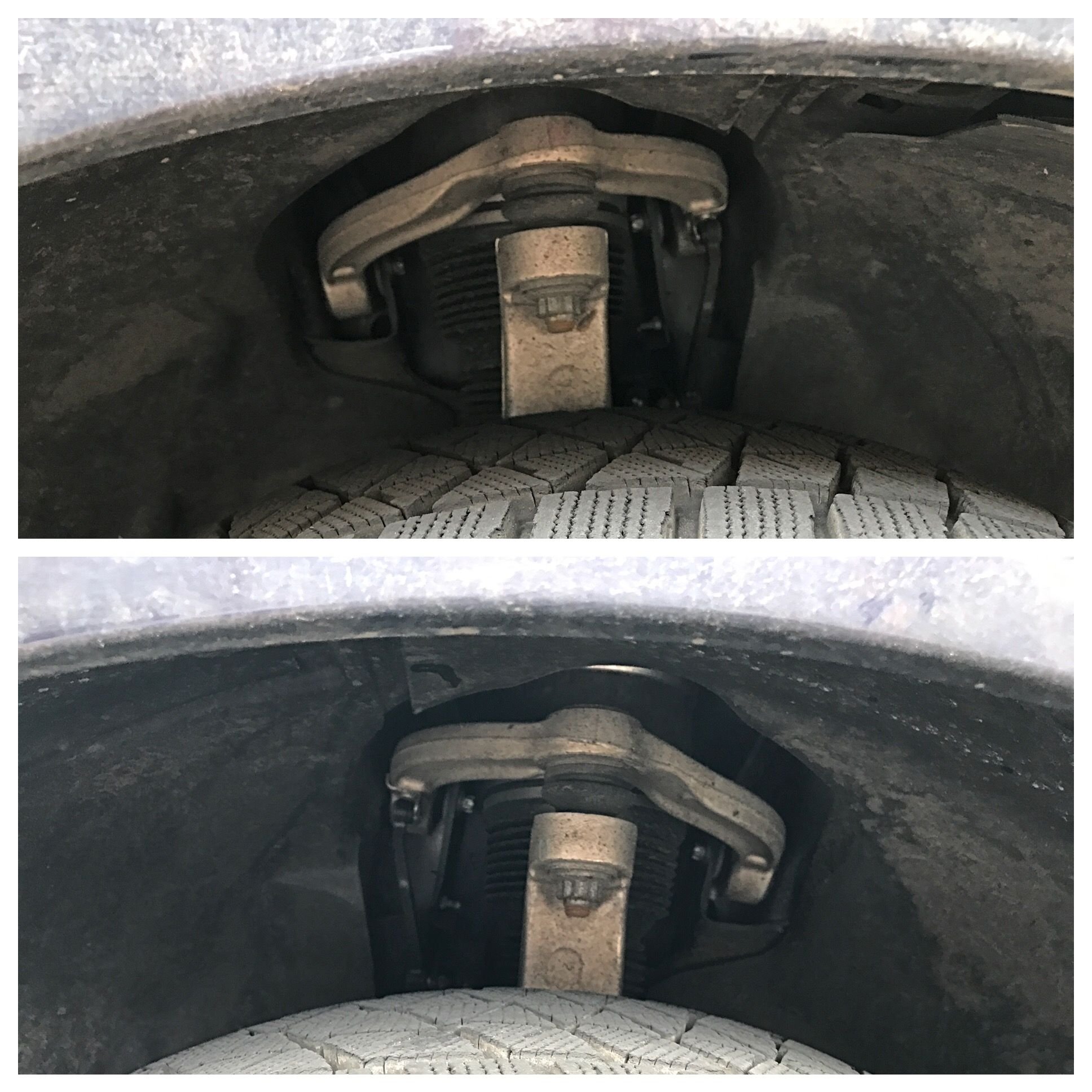

W166 AIRMATIC / ACS/ ADS System HELP !!
Bump ...
replaced both front air shocks with oem parts , new compressor , new level sensors , new sway bar links , new rear block , before the ML350 BTC gave me an error on the dash ( whenever making a left turn on an angle road with speeds above 30 mph )
replaced the rear valve block all fine now , however whenever driving and maneuvering the SUV it's very unstable ( as if wants to go under you / slow response more like delayed responses on body roll / movement)
after several visits in and out the shop
without a car
frustrating/ puzzling moments for everyone
any help ? Ideas ?
Anyknow knows the location of the "roll control " or control unit for the ADS system ?
