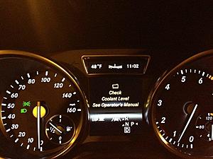

Thank you dear Watson, I am well aware. Please review below.

Could be a bad sensor or sensor connection.

My bad. I didn't know you also got a message on the dash.
