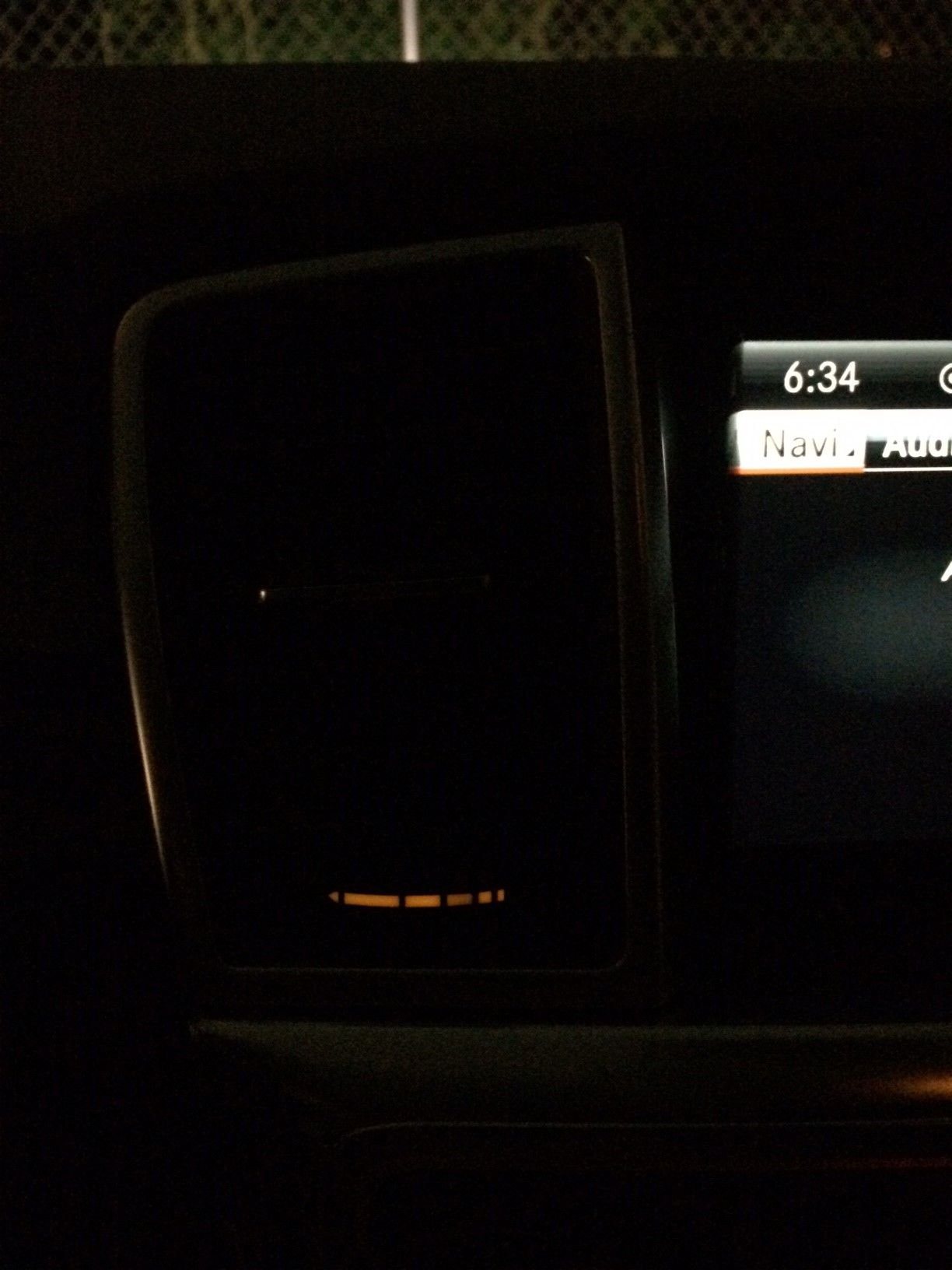

I STAND CORRECTED!
Just went out and cranked my 2014 ML and the knobs DO light up. I had my dimmer so low that I thought there was no light but even at the lowest setting there is light coming from each. Turn the dimmer way up and they really light up!
Here is what it looks like at lowest light level:

Originally Posted by GregGebhardt
I STAND CORRECTED!
guess I should bring my car to the dealer
