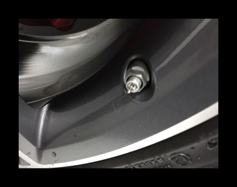

I just did my winter tire swap and here are a couple tips for you keeners
1) NEVER use the fancy dancy MB (or other) metal valve stem caps..you'll look real cool until you have to remove them to adjust tire pressure...the metal welds itself to the valve stem and this is what you get...either a stripped stem or the end snaps off..

Yup... Wheels with TPMS have metal stems not the rubber ones and the 2 metals do corrode together. That's why they come with plastic stem caps that have been painted silver.
