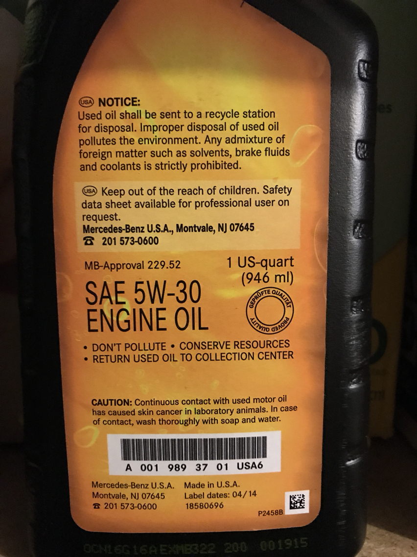

I just received the oil from online seller.
Oil labeled 04/14 its 3 years old.
Please see photos.
I searched online for engine oil shelf life, no real answer. Its between 2-5 years.
Is it safe to use this 3 years old oil?

Yes, that's a fully synthetic motor oil and is perfectly good even after it has been sitting on the shelf for three years, and it is the correct oil for your BlueTEC ML.
