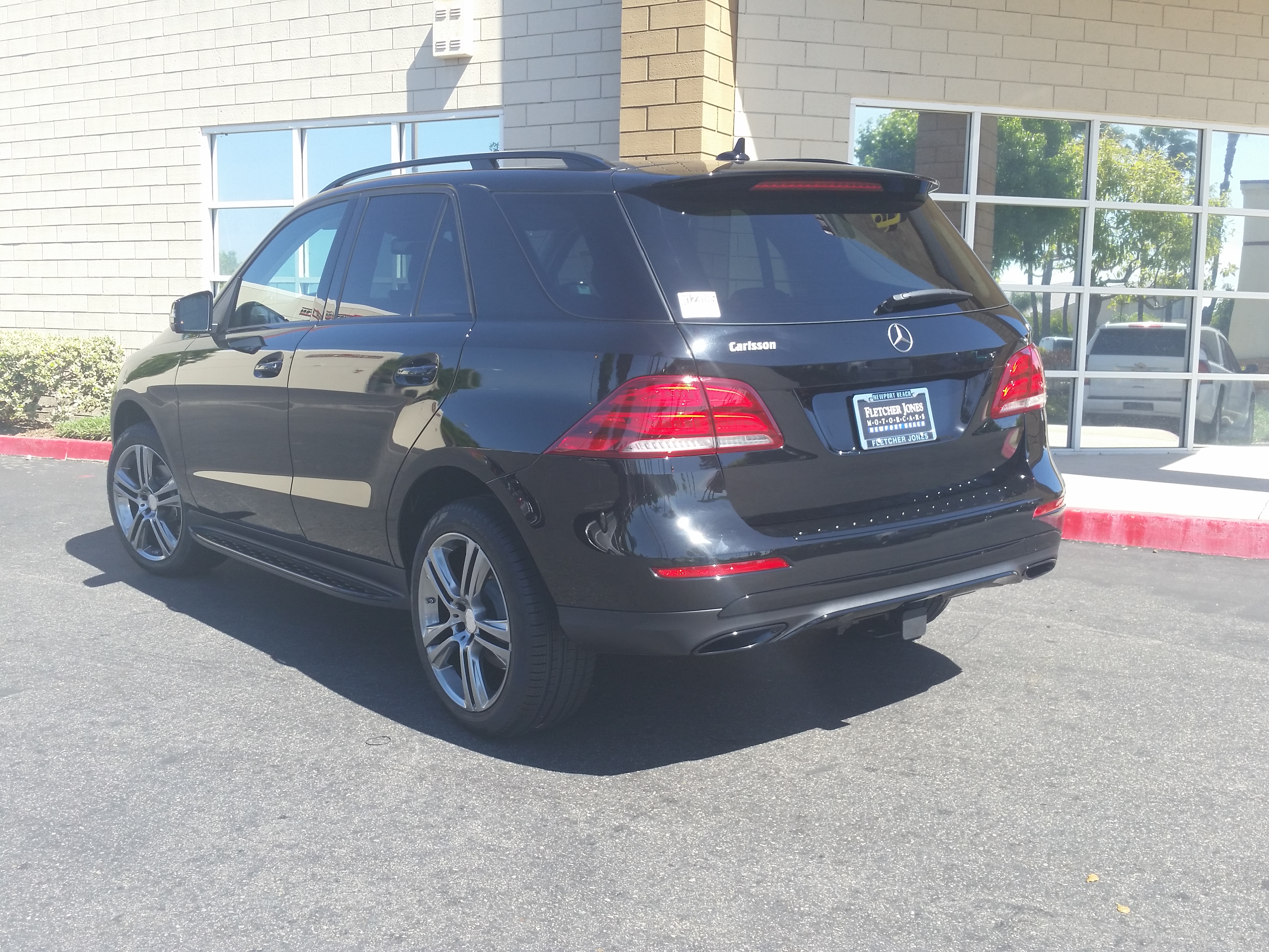

I have experience with fitting the 20x9.5 Tuner applications as mentioned above using Brabus and Carlsson, and both go up to 22x10.0...as the application is taller the rim is a bit wider.
Many of the wheel manufactures have wheel widths that vary in sizes, this also applies to wheels that may have been manufactured during different model generations...some have used 22x9.5 and some 22x10.0. As far as 20 inch wheels go, the 9.5 has always been the most common. What you really need to be careful of is the wheel load rating...the SUV application does in fact require a certain load rating, so some companies might be keen to sell you a 20x10.0 rim that might be typically a rear wheel for an S class or E class application, but that rim I am sure is not properly load rated for the ML platform. Years ago I would see people sometimes do this with the 18" wheels from some select tuners and within a few weeks the wheels would crack.
Brabus and Carlsson both sell 20 inch applications that are 20x9.5, but they also are the SUV specific wheels, and that is basically usually based on the offset...they are typically a ET55 and depending if they are fit with a body package, they utilize a spacer system.
Attached are some pictures for reference.
Hope this info helps.
