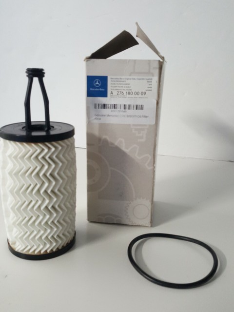

also, in the oil change photo it doesnt appear to be a MB brand filter that came out of the car. Might explain why the internals were so nasty if previous owner went extended changes with a cheap filter...

I think the oil filter that I took out are OEM mb filter. It just the change interval are way too long in my opinion. I am gonna do mine every 10000km instead of 15000km and see if it improve the condition of the oil. Give a shot and try to do it yourself Make sure you get all the tools before you start the job. It really satisfy after you completed
