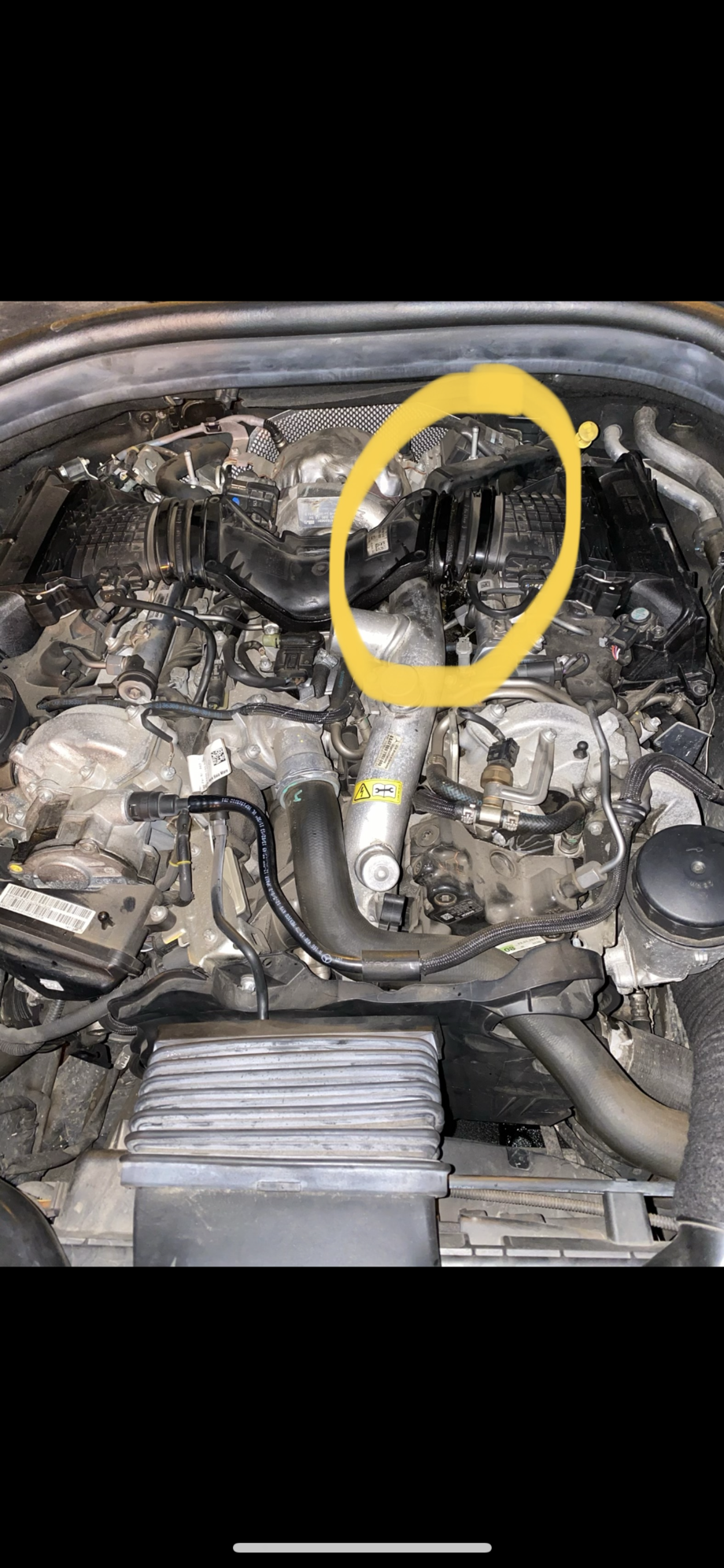

Hey all - 1st post on here!
I drive a 2013 W166 350 bluetech with 51k Mileage.
I’ve noticed an oil leak that has been on going for over a month now but the amount of oil on my drive is not consistent.
I’ve done a lot of reading about the oil cooler seals going on these, but the pictures (attached) will show the oil coming from the top of the engine which appears to be the link to the the air filter section.
Dealers have quoted me £1400 for an oil cooler replacement inc labour, but just wanted to confirm it definitely is that without paying Merc £100 for a diagnostics.
Let me know! Thanks.

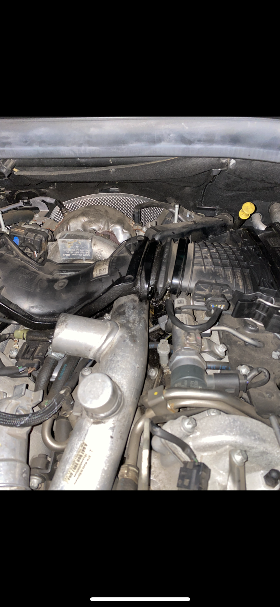

Zoomed out pic of engine.
Area from which oil appears to be leaking.

Silver pipe underneath the oil leak connects to turbo. There is a gasket between the pipe and turbo. Possible leak there.

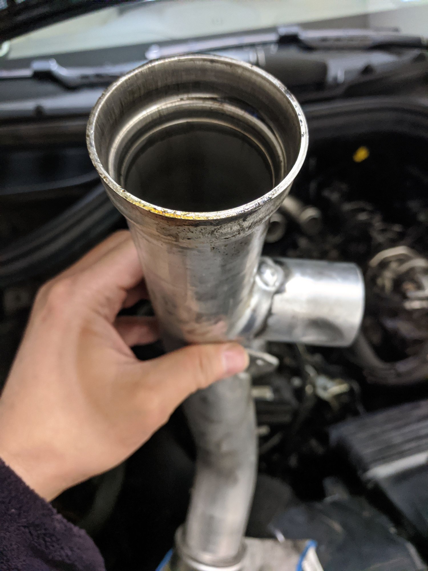

Attaching pictures from my 2014, as I have a leak there as well. You will see my torn gasket.
The end that has the gasket and connects to Turbo.
Turbo where pipe connects.
Broken gasket.

what exactly is the last picture? My only question is, although this sits directly under the black air intake pipe, the oil is dripping from that pipe itself (as it appears I think).
so could it be something else?
if oil is towards the gasket as you say, what do you think I’m looking at for repair costs?
or would you recommend that I get diagnostics done to it?

@Tinda that last piece is the gasket that joins the silver pipe to the turbocharger. The picture shows my broken gasket, it's leaking "oily" air out of the joint. The gasket itself is like $8.00 approx., If you have the right tools, the repair is about 30mins-1 hour. I would take it to an independent instead of a dealer if you want a good diagnostic.

@Tinda I just finished replacing that gasket and the turbo inlet gasket (large orange). The small gasket in my last picture is what fixed my oil leak. It's about 1hr job. You'll need a triple square for the silver pipe, e socket for the intercooler muffler.
