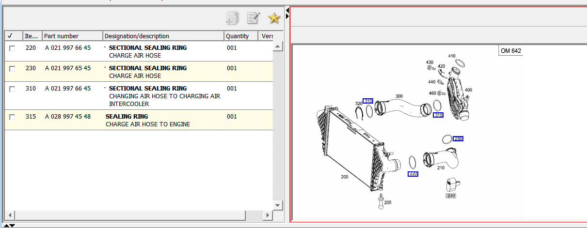

The parts diagram from online vendor doesn't give you all the parts. You need EPC to look at it. This is the one for my 2015 GL350BT. The gaskets are located inside the tube except for the 315 which goes into the throttle.

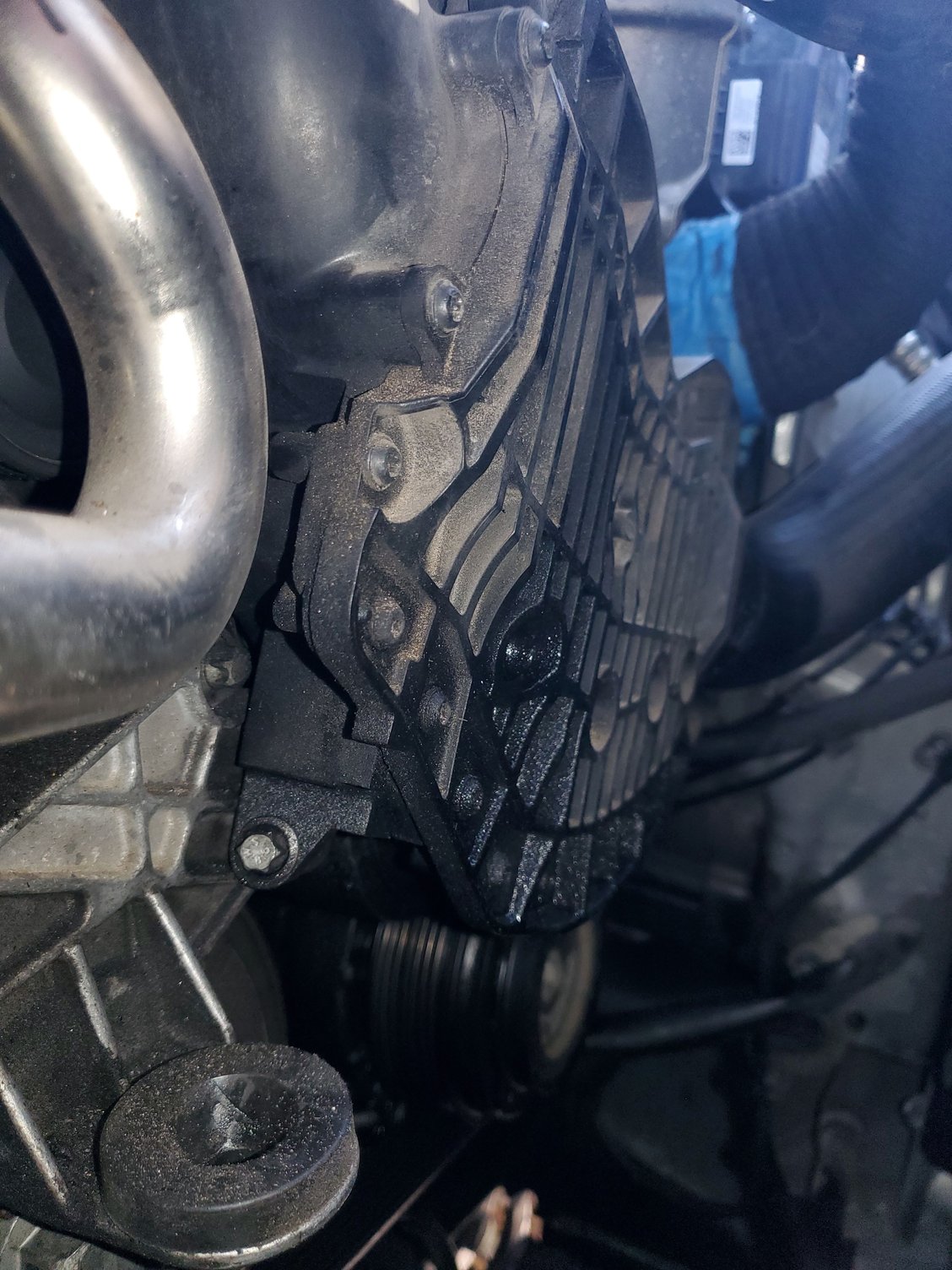

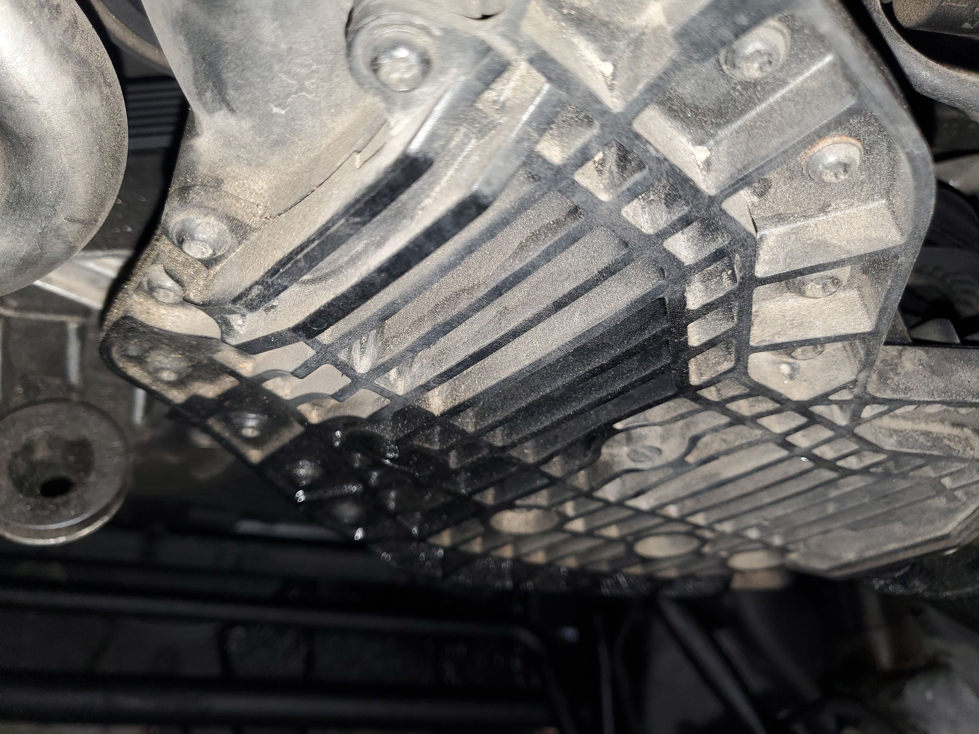

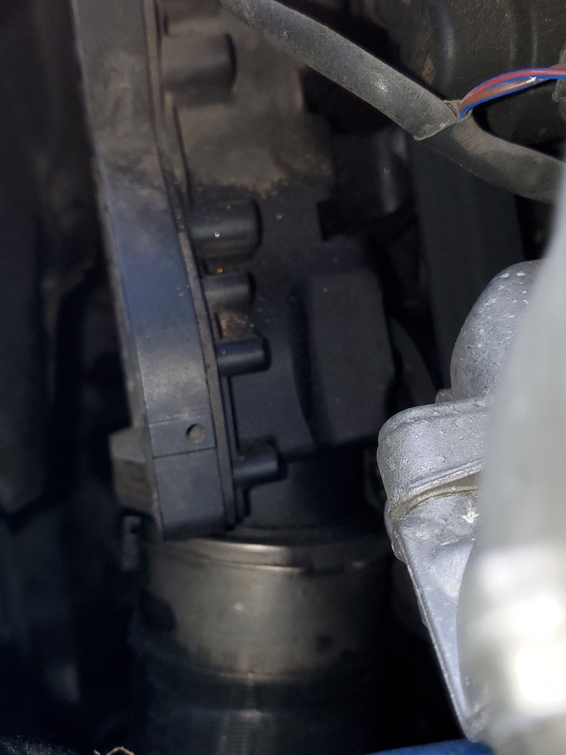

Hi,
I have a 2012 ML350 4matic
Following up on the above oil leak, as I have the same issue with mine. Did replacing the sealing rings stop the leak? Is there supposed to be oil passing by the noise damper to begin with?
Thanks. Appreciate the feedback
Noise damper (left hand side)
noise damper (front pic)
hose connecting to damper

I have seen the noise resonator with slight saturation of oil before. One thing I have noticed is when I took the resonator out, although, I have not opened it I did notice the screws on it were loose. I gave then all a 1/2 to 3/4 turn to "tighten" them up (Be careful, it is plastic that you are tightening screws to). Have not seen any signs of oil since. As a previous post mentioned, there should not be oil in there or collecting. Double check around the area for any other sources of leaks.
Will also want to verify that you don't have any other sources of leaks such at the oil filter housing, vacuum pump cover, turbo inlet and intercooler o-rings. I've had to replace all of those over time to remedy any oil leaks that I have had.
