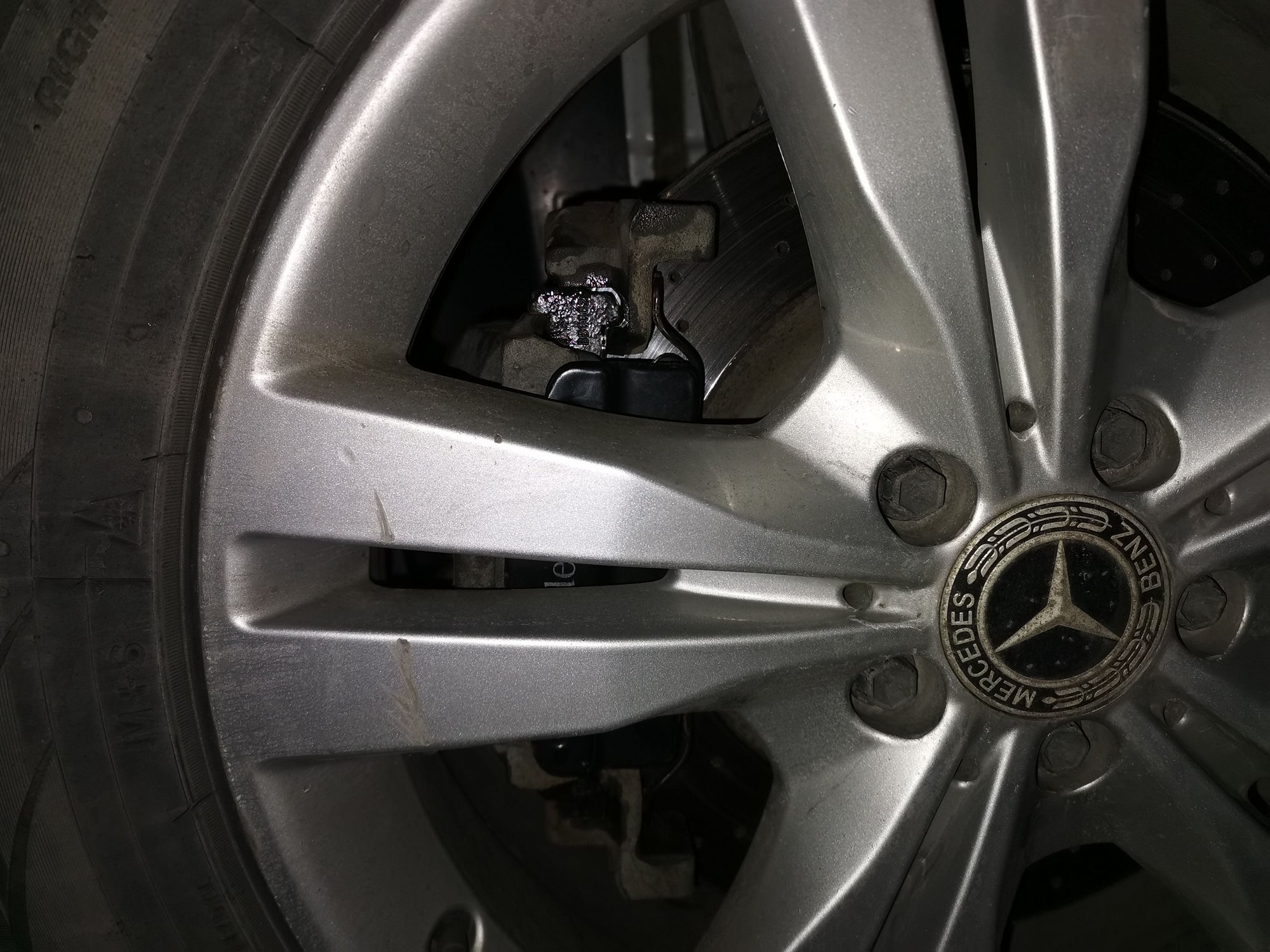

Hey guys,
I am really confused on which rotors to order since I am not sure if my car has the AMG sport package. I used the lastvin.com and decoded my vin and it showed I have the P31 AMG sport package. But here is my issues, i do not have airmatic suspension. So is it possible to get the AMG package without the air suspension? Also, if I have the p31 AMG sport package, is that mean I need to order the bigger rotor? The 350mm vs the 330mm?
If anyone can give me any help, that will be awesome

Post up a photo of your wheels/brakes.

You are the best! I have one more question. I am having issue with my front passenger side caliper. I ordered an used caliper from ebay. Is there two different type caliper for 350 and 330 mm rotors? or they both share the same caliper. It looks identical in the picture.

The caliper on your vehicle is 1664210581 for the left and 1664210681 for the right. The caliper you bought should be 1664210181(left) or 1664210281(right). You can check the part number on the calipers. They should be stamped.
Based on my findings they are DIFFERENT. The ones on your vehicle are for AMG package and the one you found is for non-AMG package.

What's wrong with your current caliper? I see some fluid so I assume it's leaking? You first need to find the source of the leakage it might be the flexible hose. If the caliper is leaking, most of time the caliper can be repaired or rebuilt it's a relatively simple procedure. You only need to find the rebuild kit. There are lots of sources for the rebuild kit for example this one.

My inner pad worn out a lot more than my outter par. Also my inner pad wasn't wearing evently. I suspect either the sliding pin was seized or the piston was not retract probably. On top of that, i broke the brake sensor screw. I don't think i can drill it out the screw. So basically, it fukked. I found another used caliper on ebay, i think i will give a shot

Those are all easily repairable stuffs. The sliding pin can be easily cleaned and lubricated to restore sliding. You might need to replace the rubber sleeve of it if it's torn but that's very simple as well. The piston can be tested and inspected. You just need to press the brake pedal a couple times to push the piston out about 10mm or so to do a good inspection. If there's any rust on the piston get it sanded off. You can replace the pistons and sealing rings if you get the rebuild kit as well. The sensor screw might be a little tricky but it's not difficult either. It's a M6x1.0 screw so you can drill it out with a 3/16 inch drill bit (Theoretically you should use the 5mm bit but the 3/16 bit is slightly smaller than 5mm so it's easier to control). If you align and position it good enough you can get it done with one shot, while if you happen to damage some thread you can still put a new screw in.
The uneven wear is not likely caused by caliper usually, but an unclean caliper bracket that the pads sit on. Usually when brake dust accumulate on the bracket the pads get stuck on it making the uneven wear. You need to do a really good cleaning job when replacing the pads, basically use a really hard wire brush (stainless steel or brass) to brush all brake dust off the caliper and bracket. Then you need to apply a thin layer of brake lubricant to the contact point between the pad backplate and the bracket (DO NOT apply to pad face). Most cheap shops don't do this when replacing pads, which eventually cause the pads to stuck.
If you really want to replace the caliper, you need to replace by pair otherwise you might end up with the car pulling to one side when braking. At least you need to rebuild the one on the other side to bring the performance of the two close. Given the description I would vote against replacing the caliper but you know your own car better.

You know what, I think your advice makes a lot more sense than my panic thoughts LOL. I cancelled my ebay order for the new caliper and decided to drill out the bolt again on my next set of days off. I will take a better look in the caliper and see how the condition are. I never really mess around with the caliper before,but changed numeours of pads and rotors. This is my first time ever see uneven brake worn . I will take more pictures once I open up the caliper again. Thank you for your help
